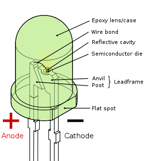

LED and the orientation I've seen in schematics have the - leg on the cathode and + on ground (which seems weird).
To be clear, it goes this way.
Diode - Wikipedia, the free encyclopedia
If you want diode to conduct in forward direction you'll have top connect anode to positive and cathode to negative supply, just like kavermei told you and just like what dsavitsk's picture shows. This is just like vacuum tubes, nothing to be confused about here

One more hint- the cathode (the part that's connected to ground) often has a small flat spot (sometimes pretty subtle) in the plastic molding. For the LEDs I've been using, the flat spot is on the tiny rim around the base of the device. Rectangular LEDs will sometimes have a chamfer.

I my recently purchased batch of LEDs, the flat is actually parallel to the internal structure of the LED. The distance from each pin to the flat is the same... I guess both pins must be cathodes... Silly me. Of course not. Thankfully, the short pin is the cathode (-).
I've seen LEDs without any markings (flats, chamfers, etc.) on the body. But they've always had a long and a short pin. I don't think I've ever come across an LED where the short pin was not the cathode.

When in doubt, just hook them up with a 9V battery and 470R-1K resistor in series. It won't harm the LED if you get it wrong and you'll know when you get it right (it will light up). Whichever side goes to battery + when it lights up is obviously the anode.
If you can see inside the LED, the flying lead is usually + and the die body -.
Following on from what The Gimp has pointed out, if I look into an led from the side the cathode forms most of the bridge towards the anode in a sort of " r " shape, the anode being a sort of " 1 " shape.
