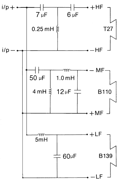

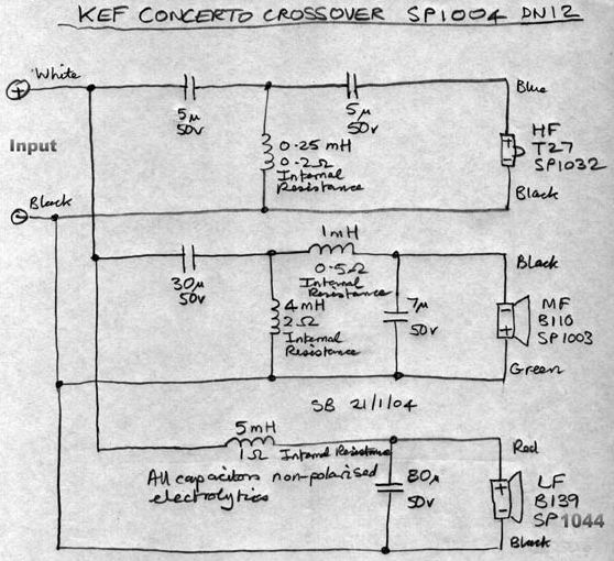

I've attached a rough picture of how I would wire up using all components on a timber board. All the negatives will be linked together. Is there any issues with my drawing? Anything I should change?
HaHa! This looks like a car-wreck to me! 😱
I just simmed it with any old drivers. It is a horror! What is that impedance -wrecking 12kHz notch for?
The original KEF filter looks much better, albeit has some other impedance issues.
But really a complete redesign might be in order. I see considerable evidence that the people who drew up both schematics wouldn't know correct polarity from a hole in the ground. 😎

Well, I can tell, by your silence, you are in a state of shock. I am telling you this project of yours is RUBBISH! 😱
AFAIK, it is some sort of "one size fits all" idea. You just adjust resistors to get it to work. Except that the designer was clueless. 😀

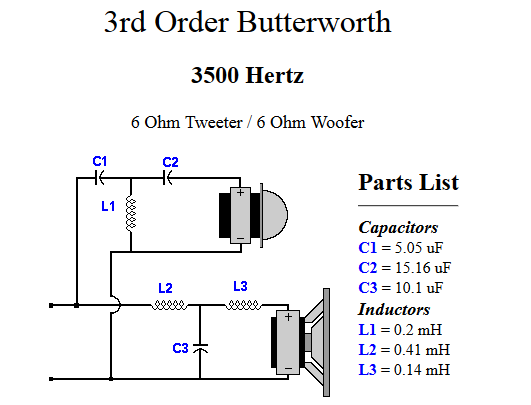

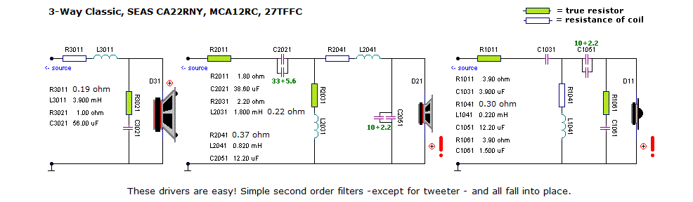

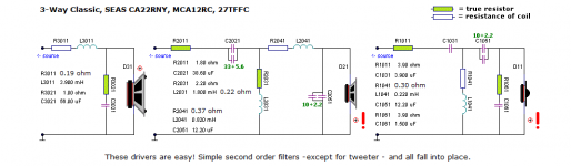

To rescue it, we must understand the doyen of loudspeaker design, Steen Duelund. This is the guy who designed the ideal 3-way. In simple terms, he realised that the perfect 3-way is built around the mid. It's not hard to tack on a bass and a tweeter to get it all to work.
This is what Troels Gravesen did with his classic 3-way: SEAS-3-Way-Classic

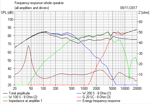

Where I have got to on your project is much better. But seriously, you must abandon this ancient 40-y-o Radford nonsense. It can be taken no more seriously than 95% of the inept projects at this forum. How do I explain this? If you want an opinion on your open-heart surgery, will you consult an experienced Surgeon or a West Ham football supporter? I rest my case. 😀

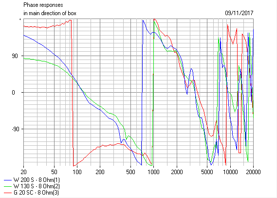

We have power response, dispersion, impedance and phase. All these things matter. Phase is actually one of the tougher parameters.
I am the World's Number One fan of 90 degree 18dB/octave BW3. This is the principle which creates a huge +3dB frequency response at crossover unless the phase works out. Sometimes it works nicely, sometimes it doesn't. 😀

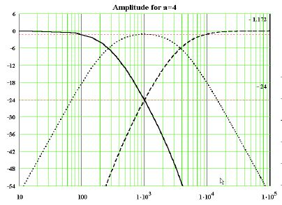

I had a serious look at the three-way Radford design tonight. It may be pure BW3. The theoretical two-way values are below. This makes for lovely flat impedance, but takes no account of bafflestep correction. IMO, bafflestep is one of those deeply confusing speaker cabinet or room-corrections.
What I can tell you, is I respected KEF's ideas of what to do with the midrange 5" polycone driver.
644709d1510200387-advise-radford-crossover-inductors-kef_concerto_crossover-jpg
I just left it alone, apart from the minor change from 4mH to 1.8mH and 1.5R. I assume KEF knew what they were doing. As it goes, I have worked on the KEF Concerto which a friend of mine used to own. A good speaker.

Where my tweeter filter is clever, is that it is a much flatter impedance than the original KEF 5uF/0.25mH/5uf filter. Of course, KEF eventually moved to the theoretically better 3:1 ratio 3.3uF/0.18mH/10uF idea. It makes for flatter impedance. I like flat impedance. It works well with any amplifier.

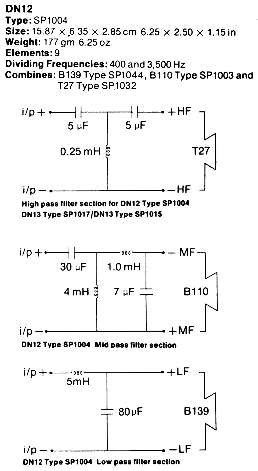

Attached are KEF’s drawings for DN12 SP0004 & DN12 SP1002 for T27/B110/B139.

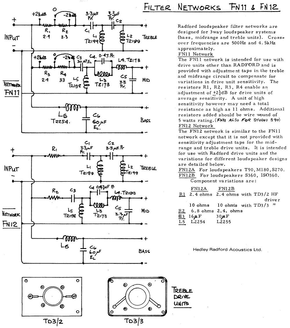

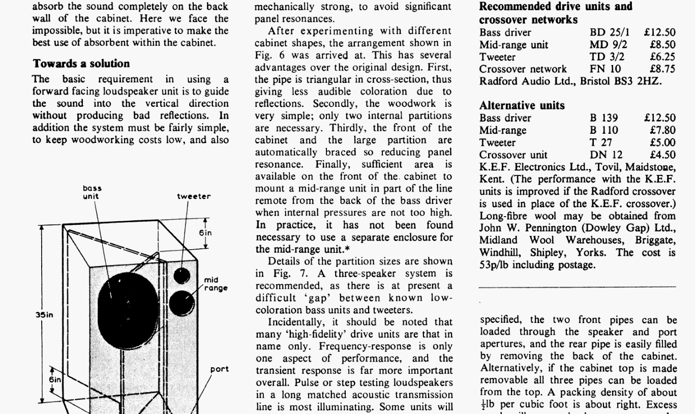

There are other members from different sites currently doing the Radford upgrade. Why would Zaphod say to do this upgrade and now others are stating its not better than the original DN12?? When Bailey released his drawing on the transmission line, he recommended to upgrade to the Radford FN10 for better results. Has Zaphod reverse engineering xo drawings not the correct original values used from Radford??
I've attached the Bailey drawings stating it is recommended for better results to use the Radford xo.

Steve (aka system7) is saying it is not good, he has not explained why or offered an alternative. Zaphod (as far as i understand) reversed the FN10 XO which i drew up into a nice format, i have no experience with it or anything to say about its veracity. I have with the DN12 which is very much a weak point of the system (as in many cases the XO is harest to do).
With many doing the updrade we will likely get real world modern feedback soon enuff about the merits of this XO.
I do think that it is likely that some XO guru with modern equipment & modelers could likely com eup with an even better XO. Steve, with his speculations is not that.

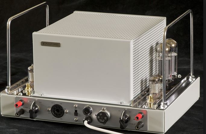

Here's the thing. Radford are famous for building great valve amplifiers. I have a still lasting interest in the Radford STA-25, below. A fab amp.
But, IMO, Radford knew ZIP about loudspeakers. 😀

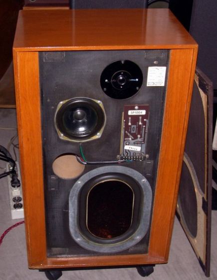

644711d1510200656-advise-radford-crossover-inductors-kef_concerto-jpg
The KEF Concerto was a very fine classical music speaker. My neighbour used to own a pair. I tuned them up for him, just by cleaning the contacts. Not rocket-science. 😱

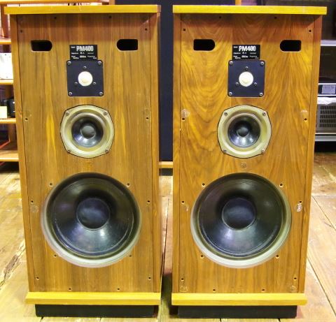

TBH, the plastic bextrene era didn't make for the liveliest speakers. My BBC monitor Chartwell PM400 speakers were inoffensive, but hardly lively:
