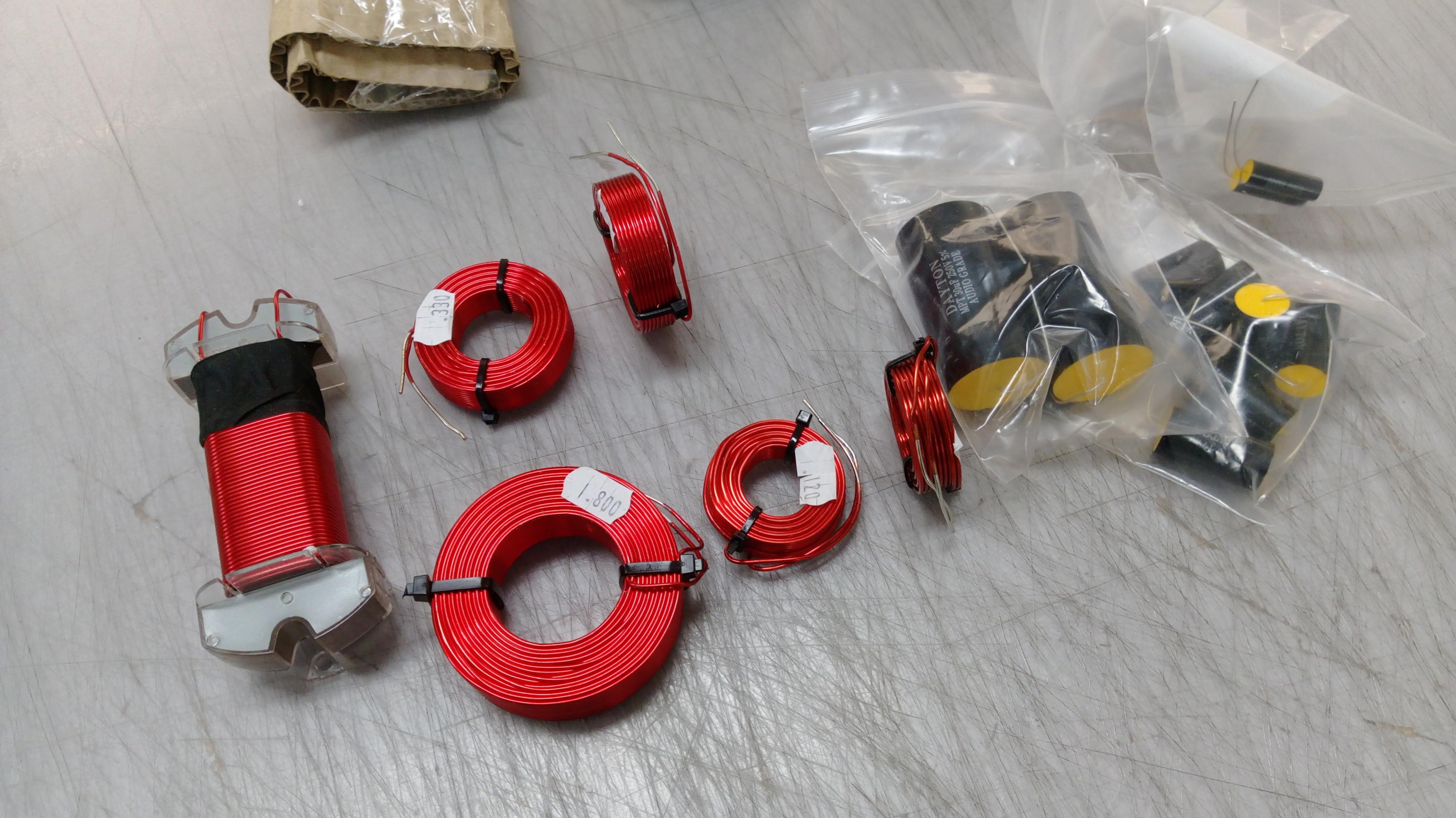

Need Advise - Radford Crossover Inductors
MKT's with electrolytics for the 50μF
and a picture of them in the living room
I'm kind of aware of the problems that may rise due to the M-T satellite but the reason is that I already had the boxes (from the CS1 kit) and I wanted to use them either on top or at the side on floor stands that will bring them on the same height as the B139. I will test and if problems risen seriously affect reproduction I will place them on the same enclosure.
As already mentioned, the proposed Radford crossover sounds terrible. I can try the changes proposed by chevelosm but since I have the equipment I would like to try and build a crossover that will fit my design. Well at least I can try... I can go passive but since I have enough Rotel power amps I can try tri-amping (maybe with minidsp or another electronic crossover).
But before I decide on whether I go passive or active, I want to fill the box with the damping material. And at this point I would really appreciate your help an a starting point! Bailey proposed stuffing with lamb's wool. I have a lot of labs wool that I got from qtasystems but I find the process of combing tedious and time consuming. I recently got 10 packs of Visaton lamb's wool for a reasonable price and I'm thinking of using this instead. It is a ~3cm thick lamb's wool - acrylic stuff (I think 85%-15% ratio) which comes in 33cmx60cm pads. I have obtained the impedance curves from the B139's installed on the boxes using the DATS v2 system (see attached thumbnails). I have already lined the back of the wall (behind the B139) with a piece of 1cm wool felt. I'm thinking as a starting point to line the walls as shown on the third thumbnail (plan view of box - red lines indicate the lining) and then make some measurements. What do you think? Is it a good starting point or should I stick to the Bailey approach? Also, I have lined the sides, back, top and bottom with 5cm thick sound absorbing material (https://www.lazarakis.gr/images/eshop/catalog/products/1644/files/SOUNDBAR (2008.09).pdf). The link is in Greek but you can get the general idea from the graphs.
