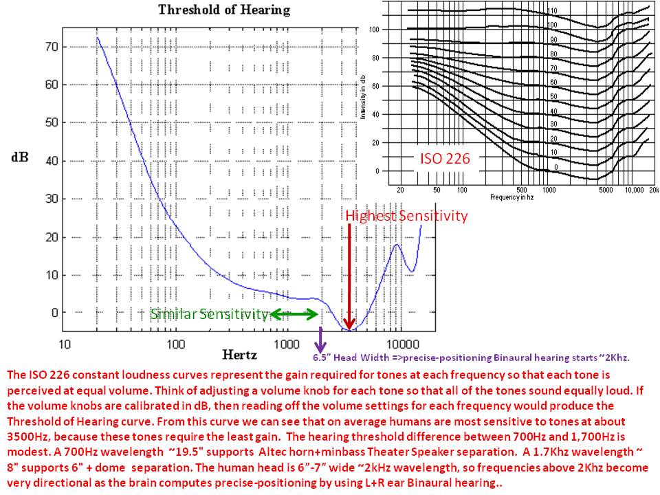

One recent 3-way trend is to use a modern 6" midrange in a sealed box crossed ~1700Hz to a modern dome tweeter, combined with a ported 10" woofer. Have you studied Jeff Bagby Kairos 3-way?
A 4" sealed box midrange is often used with an 8" ported box woofer.
