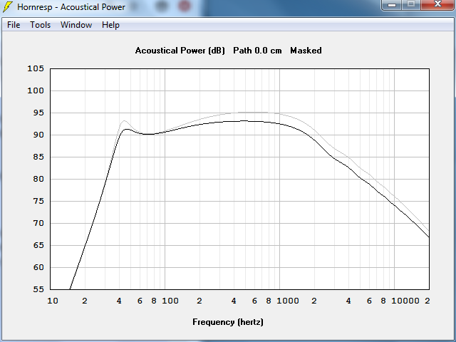

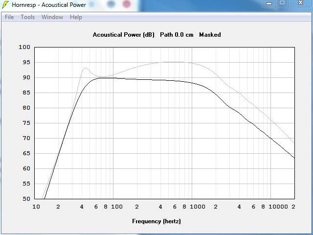

Technically, damping factor [DF] is the specified load impedance (speaker system) divided by the amplifier's output impedance, so dividing 8 ohms [speaker tap]/3.8 [DF] = 2.1 ohms output impedance [Rs].
Qts' = Qts + any added series resistance [Rs]: HiFi Loudspeaker Design
Hornresp automatically does this, so using a classic reflex alignment for comparison; inputting 0.5 ohms for wiring and 2.1 ohms amp [Rs] = 2.6 ohms in the [Rg] field and with a so called matching impedance 8 + 0.5 = 8.5 ohms.
Big difference and will be more extreme loaded in a BLH, so figure you'll need a relatively large series resistor, which won't sound the same as a matching impedance amp, i.e. DF = 1.
GM
