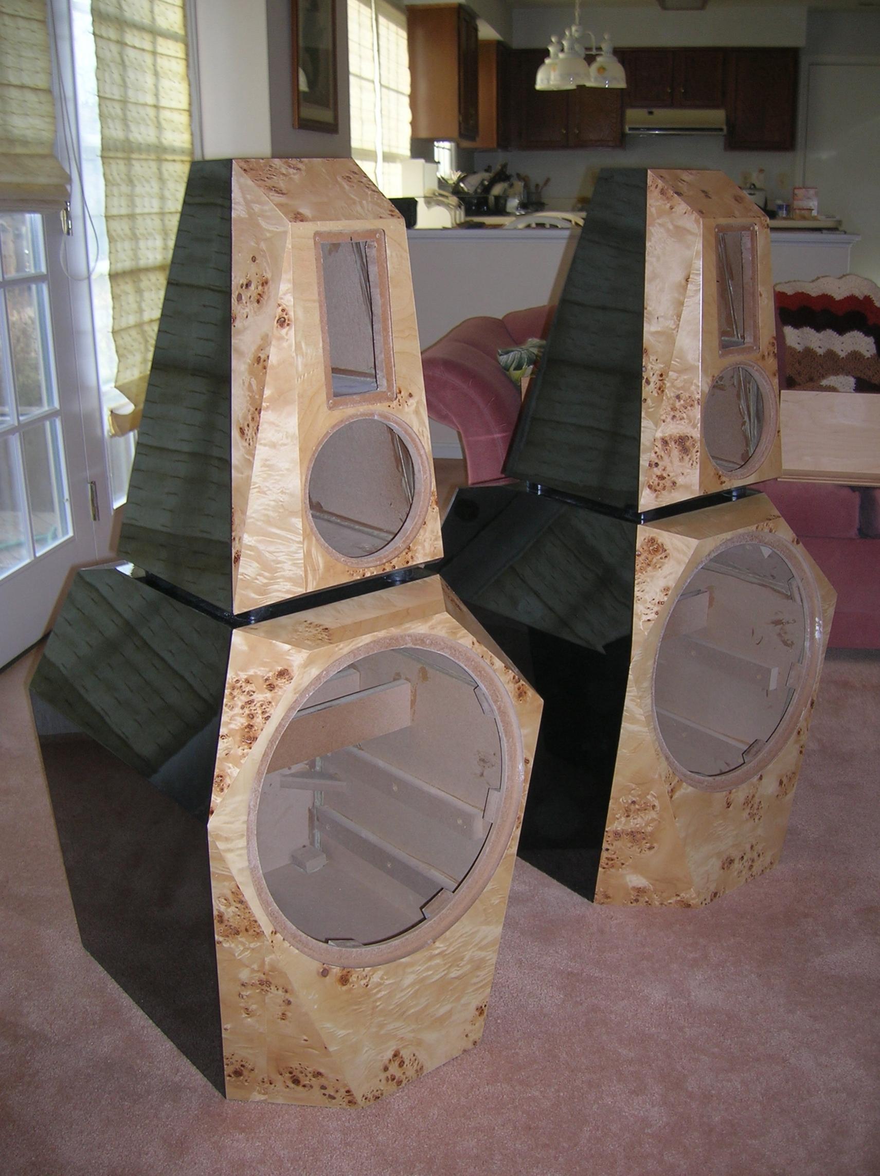

I know the this thread started a while back, but I just stumbled across it and noticed that there are some who were interested in seeing Generic George's custom speakers. Here's a pic of the finished cabinets that were actually picked up maybe two months ago
