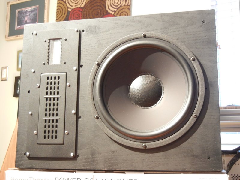

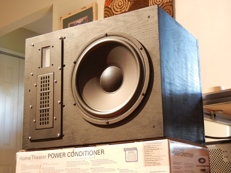

Huh? They are studio monitors, no guarantee of course, but they ought to be pretty accurate music makers. Early reports are very positive. Do not let typical audiophile prejudices convince you that these could not possibly be a great speaker and a fantastic bargain. I understand not liking the style, but do not make assumptions about their performance being all boom and sizzle. It's speakers like these that make it difficult for me to even consider making nice, custom monitors for folks nowadays. I can't compete.
Have a look at the attached picture. What if I told you this is one of the most detailed and accurate monitors I've ever heard? Does it look too plain and utilitarian for you? It's just a prototype. And it is three way, fully active with dsp.
Greg

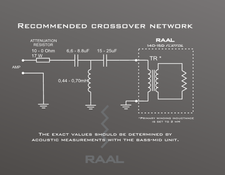

Here's what I've figured out about these RAAL ribbon tweeters. 🙂
They are essentially 8 ohms over the range from 2kHz to 20kHz. RAAL suggest about 2kHz upwards for crossover, and publish a schematic for an approx LR4 response at around 2kHz. I'd guess you want about 4uF and 12uF series and 0.4mH shunt for 3kHz, which would seem safer to me.
About 12 ohms series resistance was right for 5" woofers in my guess. The SEAS CA15RLY still looks a good prospect to me. You could use Troels' published design for the woofer filter and box, and hack on my guess.
SEAS 5INCH
I'd expect you'd need to fiddle about with the tweeter filter resistor to get levels right, then maybe fiddle with the woofer shunt capacitor resistor to get phase and imaging right. But doable, I reckon. I really just tried to replicate Troels' tweeter curve here. I won't bore you with the rough sim. 😀
Greg
SEAS 5INCH
Greg

I have been planning something similar. I think the cone driver would have to be crossed too high. I think cone drivers should not be used as bass and mid drivers all the way up to 800Hz, where the Neo8 take over. Not if it is detail you are after. The Neo10 (or RD75) would have been a better choice, from what I have heard from people. I have not heard them myself. From 800Hz up it is probably excellent.
Is it not disturbing to listen to music sideways like that? Some say, and I think I agree, that drivers should be placed in a vertical line.
In my case with the Neo8S, I can cross closer to 500Hz. This woofer sounds just fine up that range in fact. Very much higher and I agree, it's calling attention to itself, but around 450Hz it blends perfectly well.
Don't let your eyes or common audiophile "knowledge" fool you. The side-by-side placement of the drivers is undetectable if done well. There is no magic narrow OR wide baffles. Each can image and sound fantastic. Try yourself to see if it is audible. I think with proper crossovers, the mounting scheme will be transparent to you.
Greg
