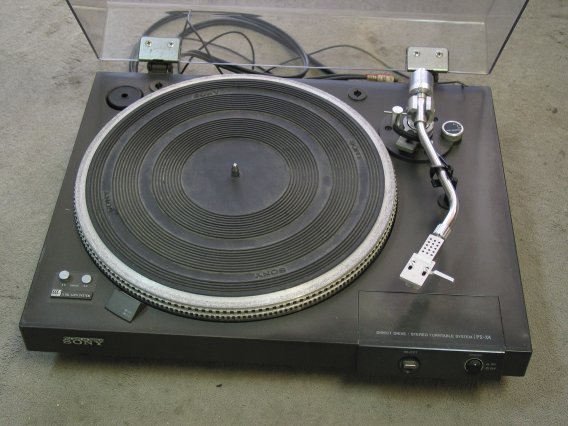

I have Sony Direct Drive PS-X4 -see picture.
Have no plans whatever to buy a new Turntable.
At arm ending there is a round jack,
where the cartridge holder, marked Sony fits in.
4 small pins provide the electric contact
the plug has an diameter of 8 mm.
This cartridge holder has two screws holding the pickup.
Pickup is an Audio-Technica. Cannot see any model number.
Upper part is gold-color, while the needle part is dark red.
Can anybody tell me some alternative Pickups/cartridges
that I could fit in this Arm?
Shell weight is 10.5 gram.
According to Manual I can use Pickups 2.5-14.5 gram
I use a Nokia Carbon Fiber Record Brush
and Anti-Static Record Mat - also with carbon fibres in it.
/halo - needs some good advice

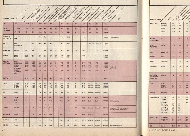

Actually, My SL1700 was already out of production in about 80 – 81. It was for that reason I happen to get about 40% off the near $400 list price. See the Linn tone arm listing in Audio Annual Equipment Directory for ’81. It’s a little blurred, but you can see both the Ittok and the Basik.😉 Maybe your supplier was holding out on you guys.😱
Rodd Yamashita

roddyama said:See the Linn tone arm listing in Audio Annual Equipment Directory for ’81. It’s a little blurred, but you can see both the Ittok and the Basik.😉 Maybe your supplier was holding out on you guys.😱
Or they could have been brand new -- i finished in Mar 1981 and didn't pay much attention to the hifi end for sometime after that (i took a year off compliments of Unemployment Insurance)
dave
Re: Re: Re: Re: Re: Re: Re: Re: Re: Re: Need advice on old turntables.
Rodd Yamashita
Yeah, the Annual always came out in Oct. of the year and the arms aren't in the 80' edition.🙂planet10 said:
Or they could have been brand new -- i finished in Mar 1981 and didn't pay much attention to the hifi end for sometime after that (i took a year of compliments of Unemployment Insurance)
dave
Rodd Yamashita

Edit: JoeBob, In staying within the subject of the original post, this should be good for you as well.
Most of the popular cartridges will fit your tone arm. I would replace the headshell with a lighter carbon fiber type (See mine below). The Jap “S” arms are too heavy for the low compliance cartridges. The lighter headshell should be enough to move the resonance up out of the record warp range (shoot for 8Hz to 12Hz tone arm/cartridge resonance).
For more in see this thread on setting up a tone arm. It has input from most of the heavy hitters.
http://www.diyaudio.com/forums/showthread.php?s=&threadid=6352&highlight=setup+tone+arm
Rodd Yamashita

That should read high compliance types.roddyama said:The Jap “S” arms are too heavy for the low compliance cartridges.
