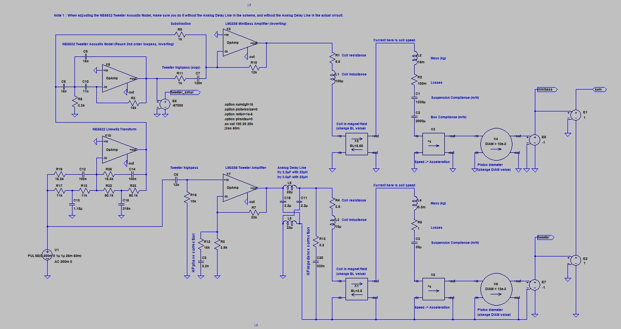

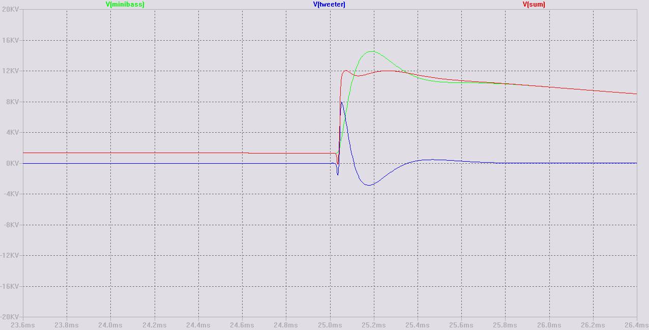

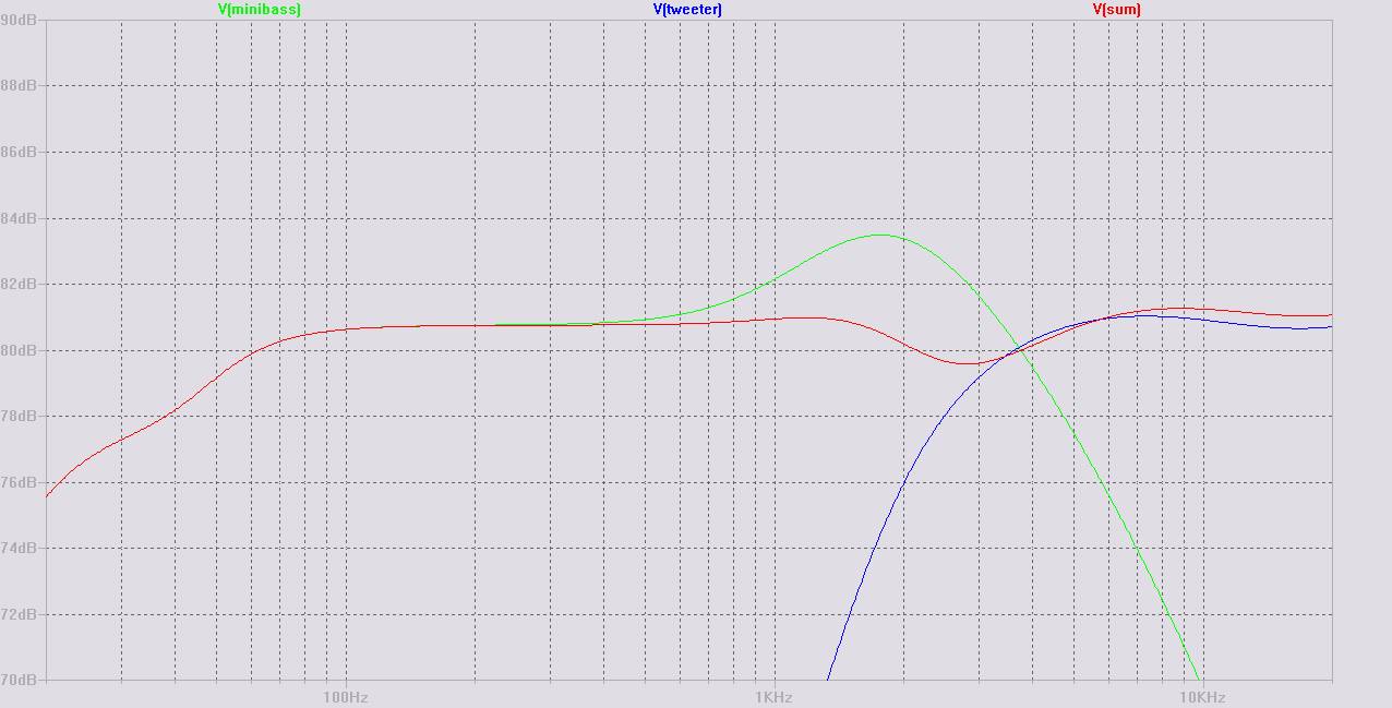

Schematics and simulation using LTspiceIV, substractive filter approach using an analog delay line in the tweeter section for compensating the minibass phase lag around the crossover frequency.
The analog delay line is matched to the Visaton CP13 tweeter exhibiting a 4 ohm impedance. A RC network is put in parallel with the tweeter, for ensuring a stable impedance in the ultrasonic frequencies.
Best simulation results are obtained when using 22 µH coils in the analog delay line. In such case, the capacitors can be 2.2 µF (one single bipolar cap) or 3.0 µF (three 1 µF in parallel).
Take notice that the present simulation bases on the fact that the tweeter and the minibass have their acoustic centers aligned. This is however not the case when flush mounting the tweeter and the minibass. In such case, the minibass emission centre is about 15 mm recessed inside the box, while the tweeter emission centre is essentially at the box surface.
This means that a real world application will need more delay in the tweeter section for a) compensating the acoustic centres misalignments and b) compensating the minibass phase lag around the crossover frequency.

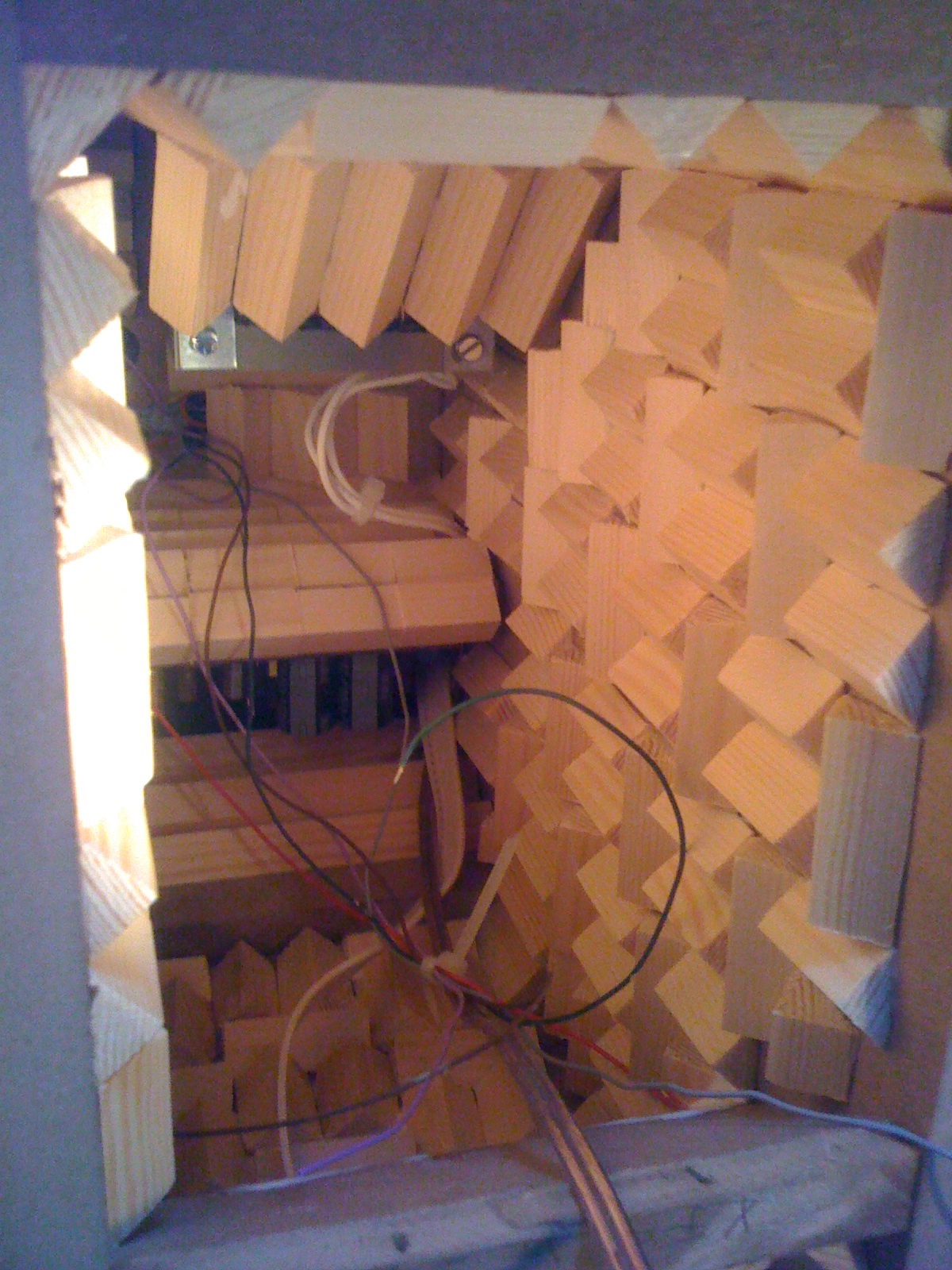

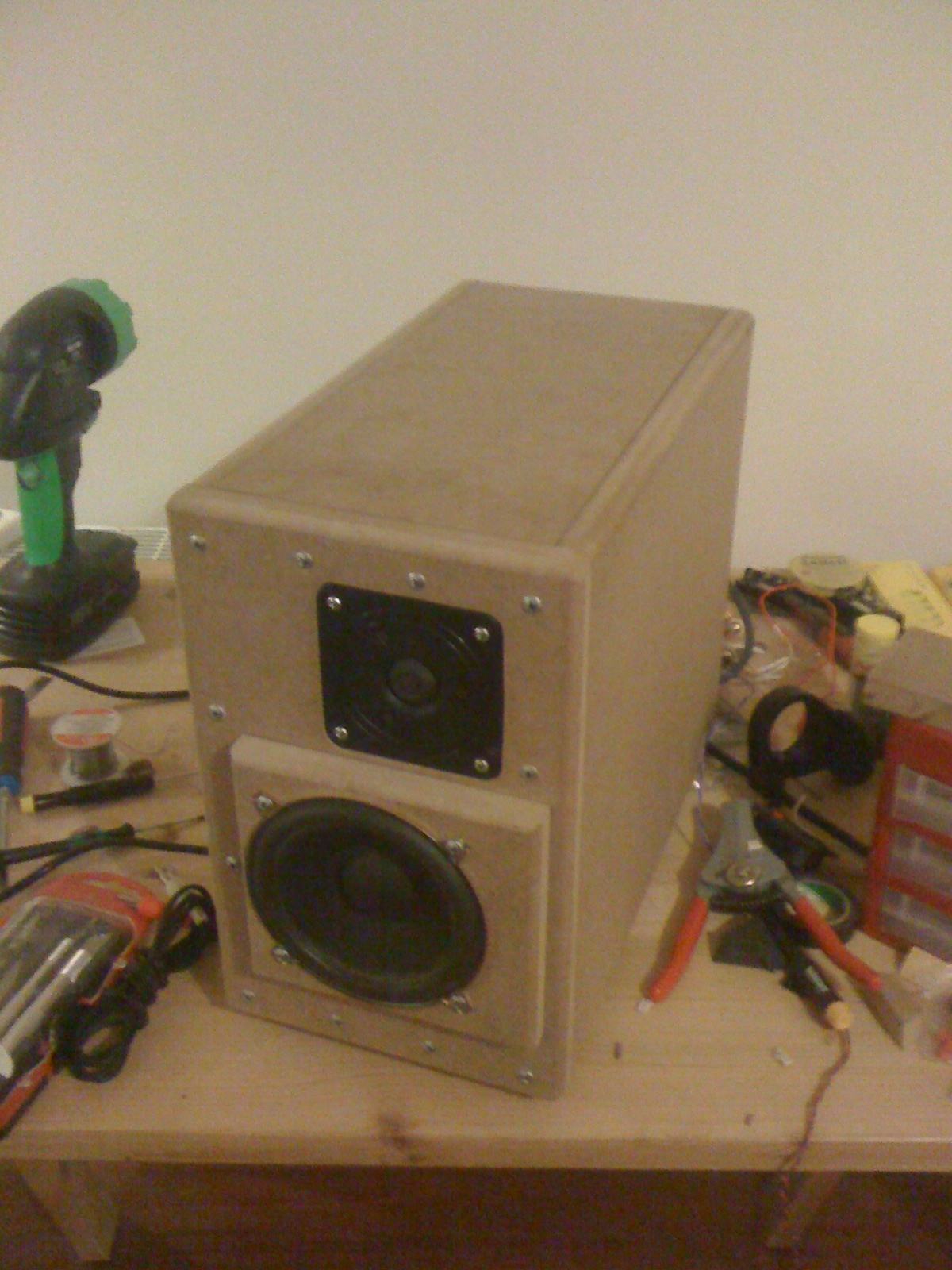

At last, finished the first enclosure and the second one is on the go. While I built the second one, I plan to fine tune the XO.
Some pictures attached.
It's 4/3 inch thick mdf and weights 18kg, more than some of the towers I owned. All the interior has lined with triangles on six of the walls to increase surface and kill parallel walls. Tweeter is in a %99 airtight sub enclosure. Internal integrated amplifier is a LM1875T + NE5322 supported by a large 120watt transformer.
Voice coils of tweeter and and mid bass is aligned by adding a third 2/3 inch thick mdf for the mid bas driver. As advised I tried to keep the distance between mid and tweeter very close, as close as mechanically possible with my tools.
I rounded all edges, keep all units off center, with different distances from each edge.
I impleted a switch at the rear of the system so that an internal or an external XO can be selected.
As I thought that this enclosure deserves better drives, I made the front baffle detachable (inner baffle is fixed however, but will permit me to use nearly %99 of the tweeters and %100 of 4-4.5 inch mid bass) The exterior baffle is fixed by 16 screws and looks quite tight to me.
Here are my initial tests :
It looks like the mid-bass is more capable than I thought initially. Goes well down to 55hz with reasonable output, while the measured vas was 72 hz.
Tweeter has a 90db sensivity while the mid bass is 89 db average. I will do better measurements in a more controlled environment in this week.
I haven't tested a XO yet, however I think I will start with a 3khz 1st order, as mid-bass has reasonable out put unto 14khz, while it certainly beams above 7-8khz.
