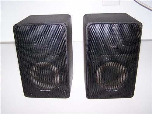

Why building from scratch ? Buy a pair of Realistic Minimus-7, add some equalization in your LM1875T-based amplifiers, and you are done. This is a closed-box design, easy to equalize in the bass using a Linkwitz Transform circuitry.
See here : REALISTIC MINIMUS-7 SPEAKERS MADE IN JAPAN GREAT SOUND | eBay
Later on you may bi-wire them.
This way you can use an external crossover like a 4th-order Linkwitz-Riley, with an impedance compensator for the woofer and a RLC notch (-8 dB at 4kHz) for the woofer.
This way you also can apply biamplification, introducing an active crossover.

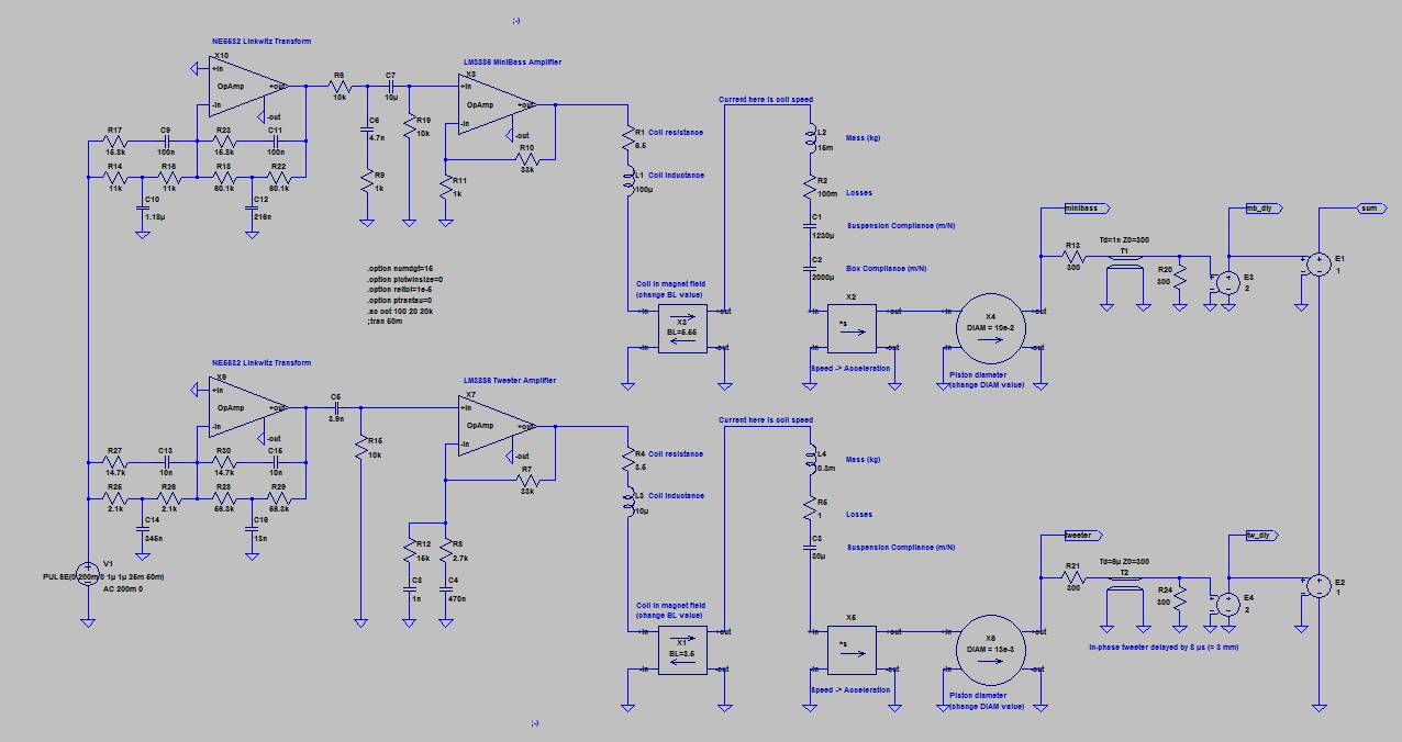

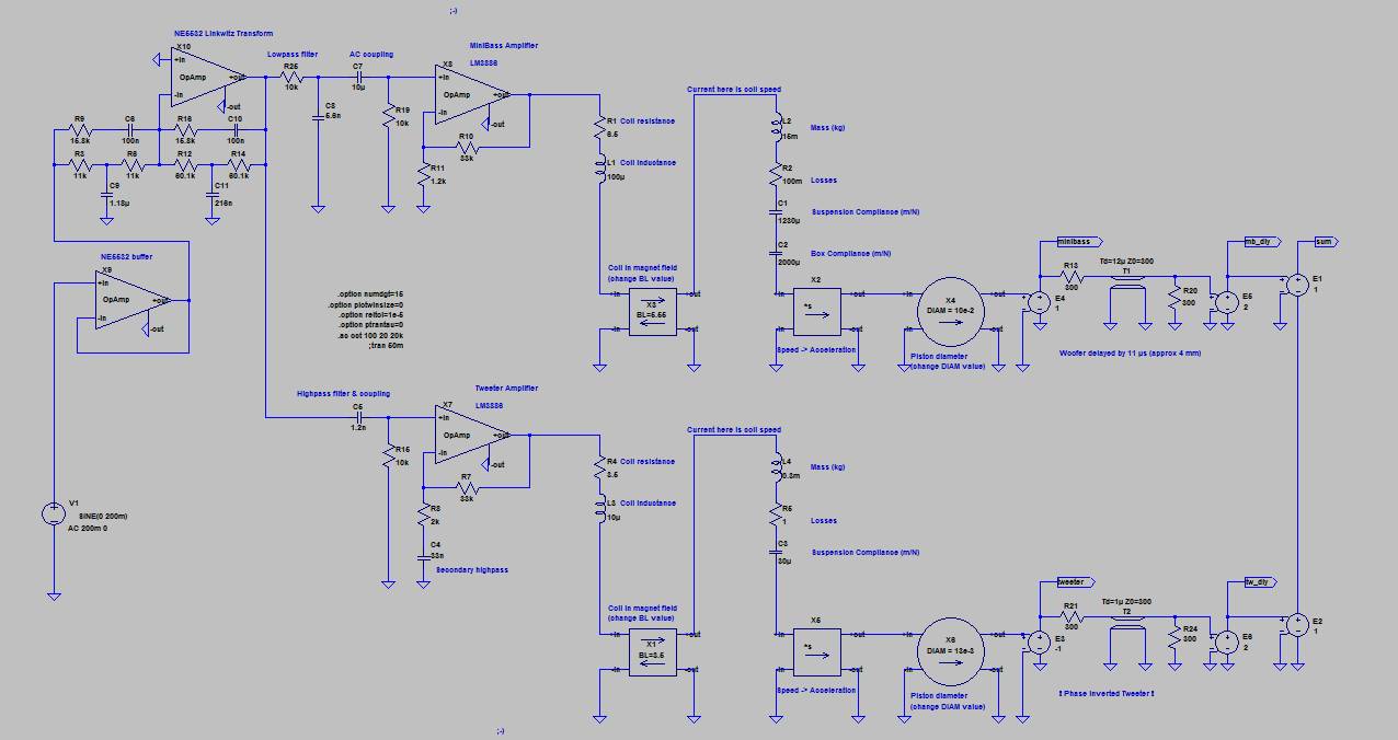

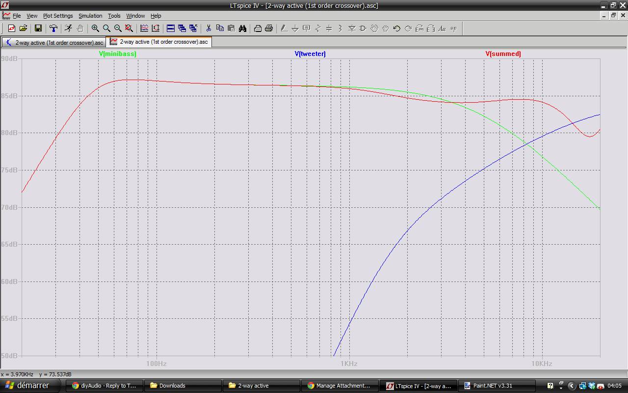

You can change the feedback network of the LM1875 (or LM3886). For stability and distorsion reasons, you should not change their HF gain.
You can change the feedback network of the NE5532.
First thing to do is to connect the woofer and the tweeter without any board modification. You then modify the feedback network around the NE5532 section dealing with the tweeter, for adapting the signal amplitude delivered to the tweeter section, for getting the same SPL from the tweeter and the woofer. So easy !
This way you can select any kind of tweeter having any kind of sensitivity.
Second thing to do is to lowpass the woofer. Like you said you can try a 1st order lowpass. In such case you need a quality miniwoofer exhibiting no high frequency resonance.
Such quality miniwoofer can be :
Vifa 9 BG119/8 (Xmax 2.3 mm, price 29 eur) (ebay.de) Fiberglass. A classic ! You can't go wrong with it ! Should be first on your list.
Dynavox FR88EX (Xmax 3 mm, price 35 eur) (ebay.de) Aluminium. Nice little speaker, extremely wideband, this is the high-excursion version of an interesting family. Should be second on your list.
Visaton B80 (Xmax 2.2 mm, price 62 eur) (ebay.de) A new challenger, quite overpriced at the moment.
Morel CAW 428 (Xmax 4 mm, price 73 eur maybe)
Peerless HDS PPB 4-25/08 (Xmax 3 mm, price 57 eur maybe)
Seas Prestige CA12RCY H1152 (Xmax 3 mm, price 59 eur maybe)
Wavecor WF110WA02/04 (Xmax 3 mm, price 40 eur maybe)
The Tang Band W4-657 (Xmax 3mm, price 35 eur) (eBay.de) cannot be used in a simple 1st order crossover because it peaks at +10dB around 7kHz. The Tang Band W4-657 requires thus a passive RLC notch filter after the output of the power amplifier, tuned at 7kHz.
The Dynavox DY-103 (4 eur on eBay.de) cannot be used in a simple 1st order crossover because it peaks at +8dB around 8kHz.
The Dynavox DY-131 (5 eur on eBay.de) cannot be used in a simple 1st order crossover because it peaks at +9dB around 6kHz.
The Dynavox DY-161 (6 eur on eBay.de) cannot be used in a simple 1st order crossover because it peaks at +10dB around 4.5kHz.
Those are three good loudspeakers, their membrane is made of paper with a polypropylene coating, enabling a smooth roll-off after the resonance, without secondary resonances. Cone breakup is indeed very well controlled. I thus recommend those speakers. All what is needed, is a passive RLC notch filter after the output of the power amplifier, tuned at 8kHz, 6 kHz or 4.5 kHz.

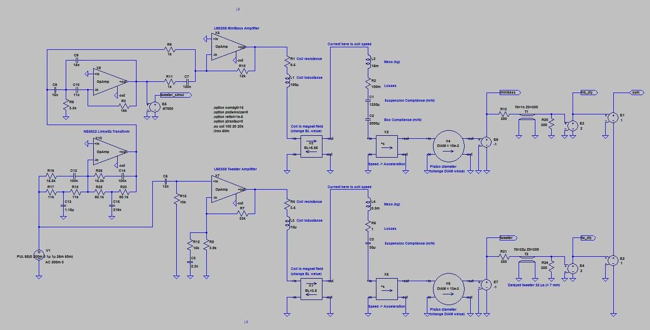

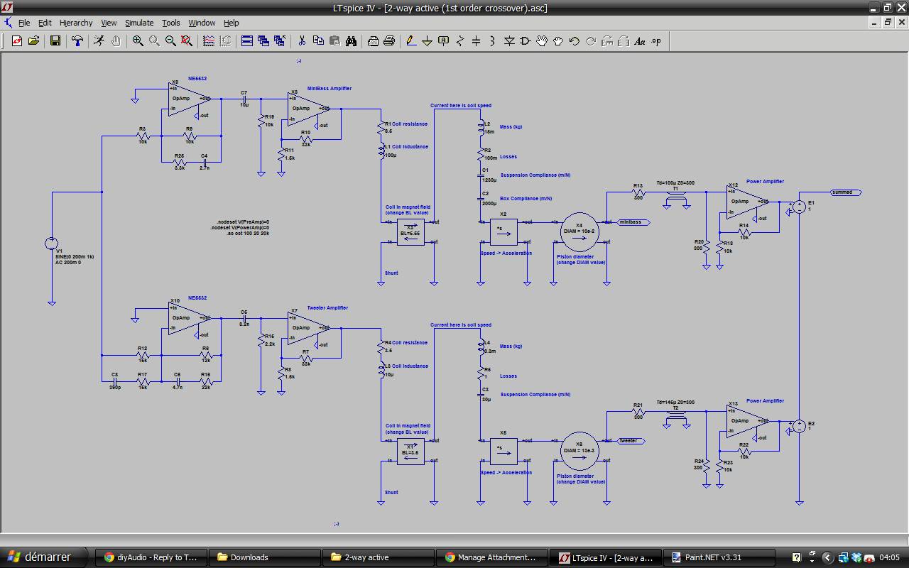

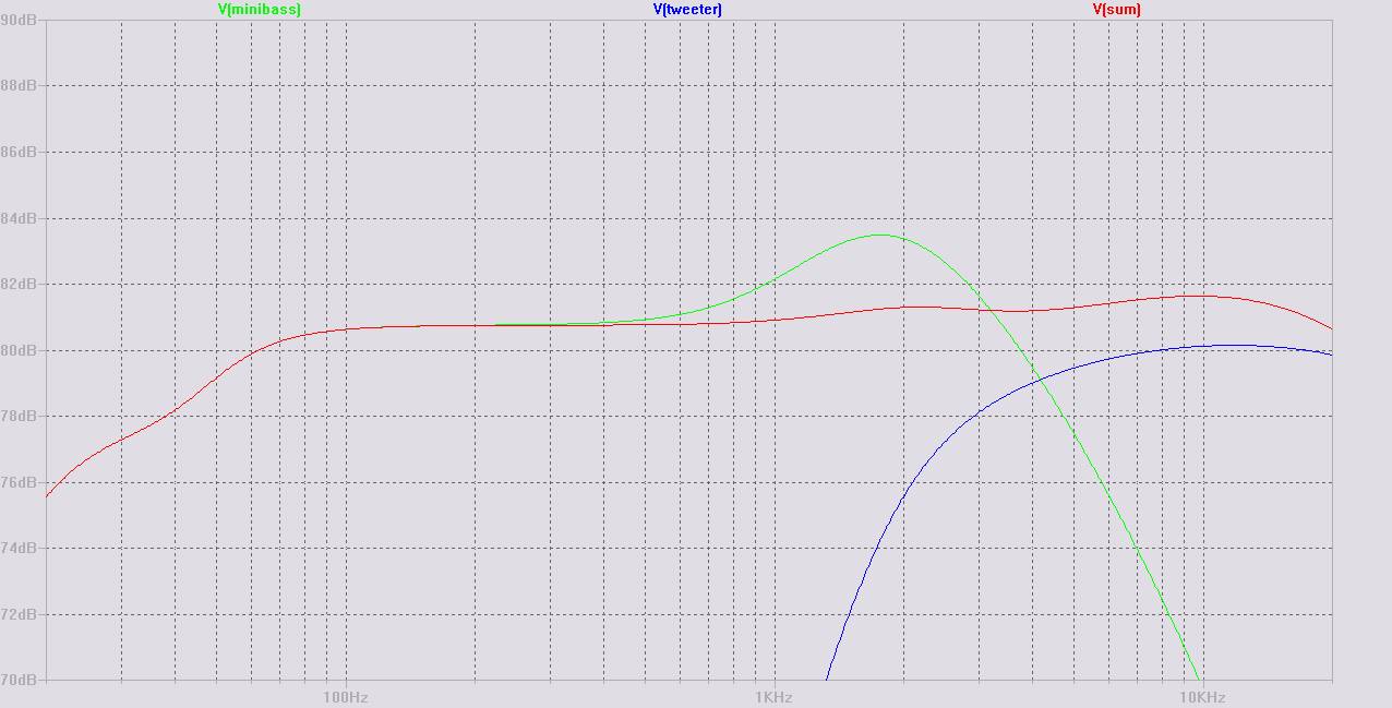

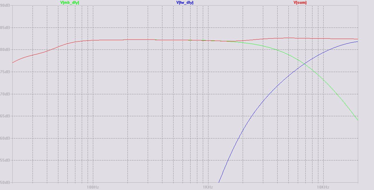

How to 1st-order lowpass the miniwoofer ? You need to wire the NE5532 bass section as an unity gain inverting amp (may need some chirurgy on the PCB), putting a RC network in the feedback. Use a 10k resistor as series input resistor. Use a 10k resistor as feedback. This way you get a unity inverting amp. Add a 4.7nF capacitor in parallel with the feedback resistor, and now you get a 1st-order lowpass at 3.4 kHz. Provided you are using a quality miniwoofer, you are now done with the bass section.
Let us now determine the tweeter section. Let us realize the context first. You definitively know that you are dealing with a miniwoofer having a relatively small Xmax. Therefore you definitively know that if your music is containing deep bass, listening it at a high volume, the miniwoofer will saturate. You thus know that you need to listen at moderate SPL.
A surprisingly good & still inexpensive tweeter is the Visaton CP13 (price 13 eur on eBay.de), especially when passive high-pass filtered with a 2.2µF capacitor in series. I urge you to test it. Such is my recommendation.
Considering your cost budget, you may use not one miniwoofer, but two miniwoofers in a d'Appolito configuration with minimal distance between the two miniwoofers. Only the Visaton CP13 allows you a minimal distance between the two miniwoofers. You'll get a smooth symetric radiation pattern, and an improved max SPL in the deep bass.

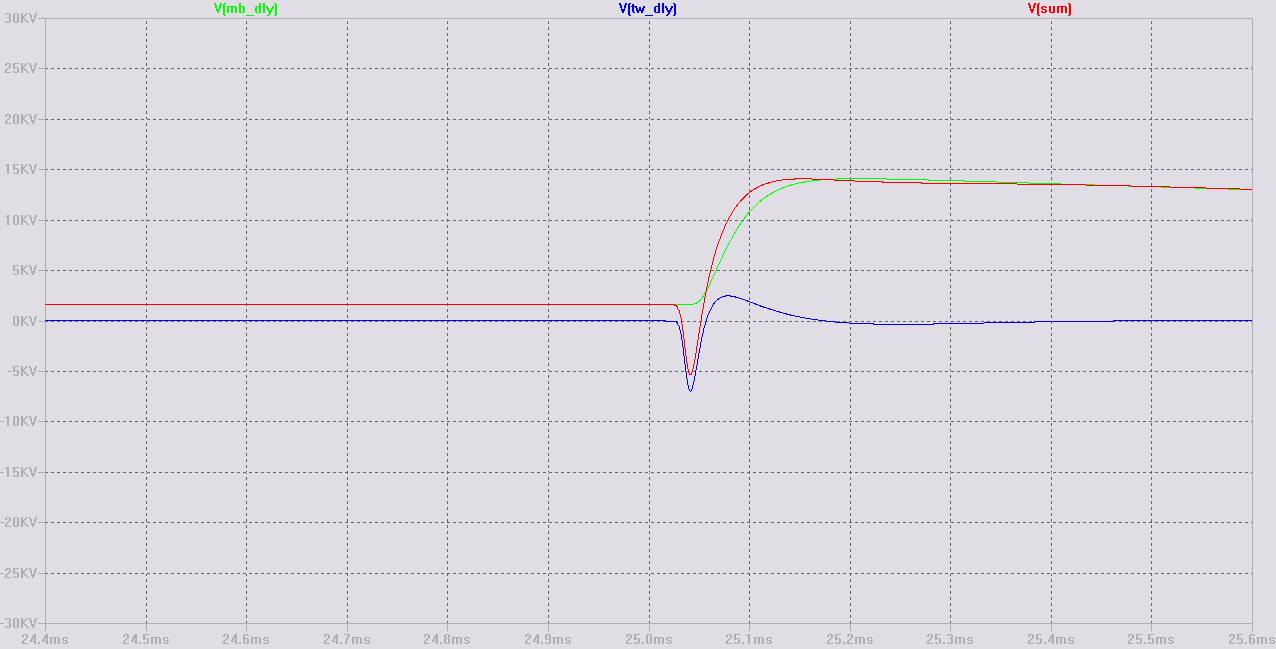

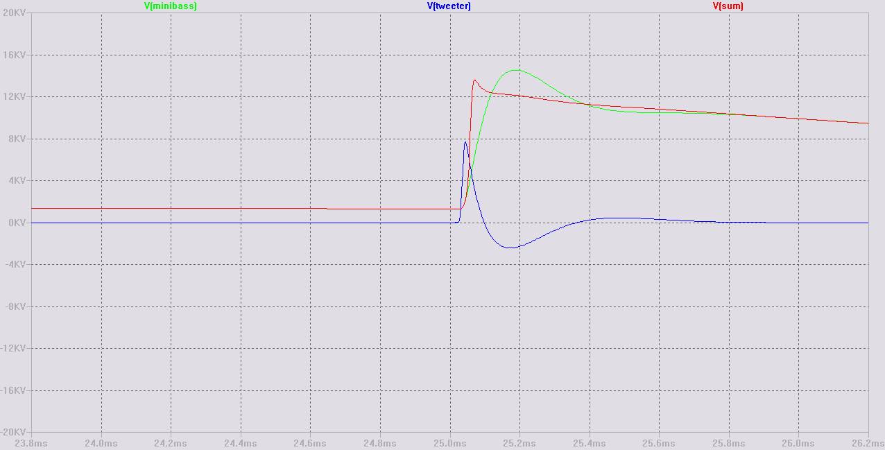

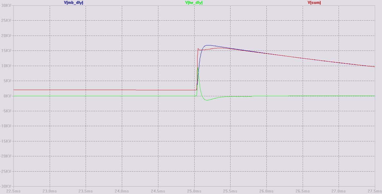

I guess that you are aware that when using a 1st-order crossover, the miniwoofer and the tweeter are working together at -3dB with a 90 degree relative phase shift in the transition band. As consequence, with a 1st-order crossover, if you are not using the d'Appolito arrangement, the radiation pattern will be pathologic. So you see, there is no free lunch : if you want to keep the crossover as simple as possible (1st-order), you need two miniwoofers in a d'Appolito arrangement for avoiding the pathologic radiation pattern.
In order to encourage you using a 1st-order crossover with a d'Appolito arrangement, may I remember you that you'll get a perfectly reconstructed phase ? This is far better than any other crossover. Even reputated crossovers like the Linkwitz-Riley 4th-order introduce a massive phase distorsion. In contrast, your system built around a 1st-order crossover and d'Appolito arrangement, will exhibit no phase distorsion, assorted with a smooth radiation pattern. Remember you need to keep minimal the distance between the two minowoofers. Remember you need to time-aligning the woofers with the tweeter.
Now you realize that all you need for passively filtering the tweeter, is a good quality 2.2µF capacitor, non polarized.
Using a Visaton CP13 with a 2.2µF capacitor in series, you get a -3dB frequency not equal to 3.5 kHz, but equal to 5 kHz roughly. You need a 5 kHz frequency corner in the NE5532 lowpass section. In the NE5532 lowpass section (see above), instead of using a 4.7nF capacitor (see above), use a 2.7nF or a 3.3nF capacitor.
If you don't like the idea of a passive filter for the tweeter, you may use the NE5532 -> poweramp interface as highpass. Change the input resistor of the poweramp and make it equal to 2.2k. Change the coupling capacitor between the NE5532 and the poweramp and make it equal to 15nF. You now have a 1st-order highpass operating at 5 kHz roughly. You can now DC-couple the tweeter to the poweramp.

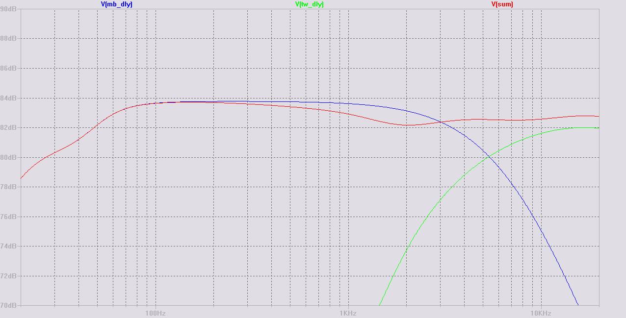

If you like wood working, I advise you to time-align the tweeter emission center with the miniwoofer emission center. This is easy done by mounting the minifoofers on a raised baseplate. Avoid abrupt angles that may cause diffraction, especially near the tweeter.

Schematics and simulation using LTspiceIV. See attached .zip.
This is a 1st-order "acoustic" crossover with time alignment.
The miniwoofer and the tweeter have been individually precompensated for delivering true 1st-order acoustic responses near the crossover frequency.
The tweeter gets delayed by 45 µs (15 mm mechanically pushed into the box relative to the miniwoofer emission center) for achieving a zero phase shift crossover arrangement. Proof of this is the crossing now occuring at -6dB instead of -3dB.
The woofer -3dB high frequency is 4.2 kHz, a frequency any decent miniwoofer can handle with precision. Miniwoofers exhibit no pronounced directivity yet at 4.2 kHz.
The red curve is the resulting SPL curve when vector summing the miniwoofer acoustic response and the tweeter acoustic response.
The resulting curve is essentially flat from 200 Hz to 10 kHz, fitting into a 3dB corridor.
When the red curve sits below one of the two other curves, the two transducers are working in phase opposition.
We identify such a problematic situation between 900 Hz and 3500 Hz, the effect stays however minimal with less than 1 dB loss because at such frequencies, the tweeter contribution is minimal, 20 dB down the miniwoofer.
We identify such a problematic situation above 13 kHz. In reality, most miniwoofers get completely extinguished at such high frequency. Above 13 kHz, most woofers can't thus counteract the acoustic energy emitted by the tweeter. This may not be true for miniwoofers equipped with an aluminium membrane radiating considerable energy as high as 20 kHz, however concentrated in the acoustic axis.
  • 2-way active.zip
Comparison between in-phase tweeter and inverted tweeter.
See attached .zip.
  • 2-way active (1st order crossover).zip
Schematics and simulation using LTspiceIV, substractive filter approach.
An electronic copy of the tweeter acoustic response (as measured without any crossover) is elaborated using one opamp configured as 2nd order Rauch highpass filter.
In this 1st order application, the tweeter only gets 1st order highpass filtered using a RC network (10K ohm, 12nF) at the input of the tweeter poweramp.
The resulting acoustic response of the filtered tweeter can thus be simulated using the 2nd order Rauch highpass filter followed by a filter equivalent to the above 1st order high pass (now 1K ohm, 120 nF).
The Rauch filter is inverting, with an amplification coeffcient equal to -1.
The minibass signal gets elaborated by computing the difference between the input signal, and the simulated acoustic response of the filtered tweeter. This automatically happens thanks to the two 1K ohm resistors connecting to the inverting input of the minibass poweramp.
As the minibass is adding its own phase (modelled here as 1st order lowpass because of the coil inductance), and as this effect has not being taken into account yet, some moderate delay is actually needed in the tweeter (22 µs, equivalent to a 7 mm recession).
For sure, the minibass lowpass model lacks precision above 5 kHz or so. Expect needing a different delay for setting to 90 degree the relative phase shift between the minibass and the tweeter, in the crossover overlap band. Play with the delay. If this doesnt work, try slighly detuning the tweeter model (through the Rauch filter and the 1st order highpass that's following). Last resource is to lower the crossover frequency, where the minibass doesn't yet exhibit a significant deviation with the coil inductance model. Change the above 120nF and 12nF capacitors by 180nF and 18nF capacitors.
For protecting the tweeter against low frequencies, the Linkwitz Transform is only applied to the minibass signal path. Such Linkwitz Transform introduces a 180 degree phase shift. Fortunately, the minibass power amp is an inverting amp. The minibass signal phase gets thus restored, there is no need to invert the wiring of the minibass.
This kind of crossover is only manageable after having carefully measured the minibass and the tweeter using a software like SpectraLab 4.32.
LTspiceIV is essential for defining the components values inside the Rauch highpass filter, for making sure that the unfiltered tweeter acoustic response gets accurately simulated. This is the aim of the signal output labelled "tweeter simul".
I especially appreciate such substractive filter.
The tweeter gets a healthy uncomplicated 1st order highpass. The tweeter phase response gets thus minimally disturbed, only 90 degree at the max.
All what is asked to the minibass is to complement the tweeter acoustic response. A minibass can do this at the condition that is stays operating in its "controlled" operating range, at a frequency lower than the cone breakup frequency, and at a frequency where the minibass coil inductance only adds a few tens of degrees as phase lag. If the crossover is 3.5 kHz, the minibass needs to behave somoothly untill 7.0 kHz or so, without peaks in the acoustic response.
Expensive speakers designed for a "full-range" use won't behave well in such substactive crossover because in general "full range" speakers rely on some weird cone resonances for delivering sound above 8 kHz. On top of this, most "full-range" speakers don't provide the required excursion (Xmax) for operating as midbass in a closed box. There are less pricey minibass speakers on the market, small diameter like 3 or 4 inch, delivering a smooth frequency and phase response untill 8 kHz or so, with an Xmax of 3 mm or so. Remember there is a possibility in compensating the unavoidable minibass phase lag in the transition band, by time-aligning the tweeter, recessing the tweeter by one centimeter or so.
For the tweeter, I recommend the Visaton CP13 as a start point. The Visaton CP13 delivers nice smooth delicate highs when filtered at 3.5 kHz or above. The 13 mm diameter enables a precise d'Appolito setup with minimal distance between the two minibass, a crucial design parameter.
