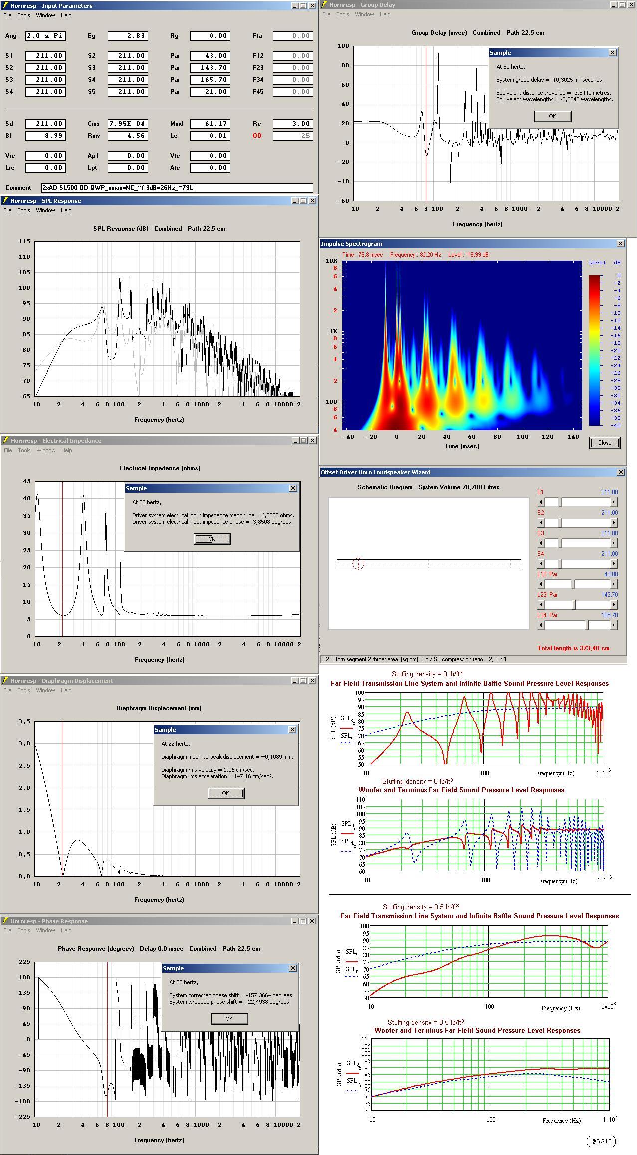

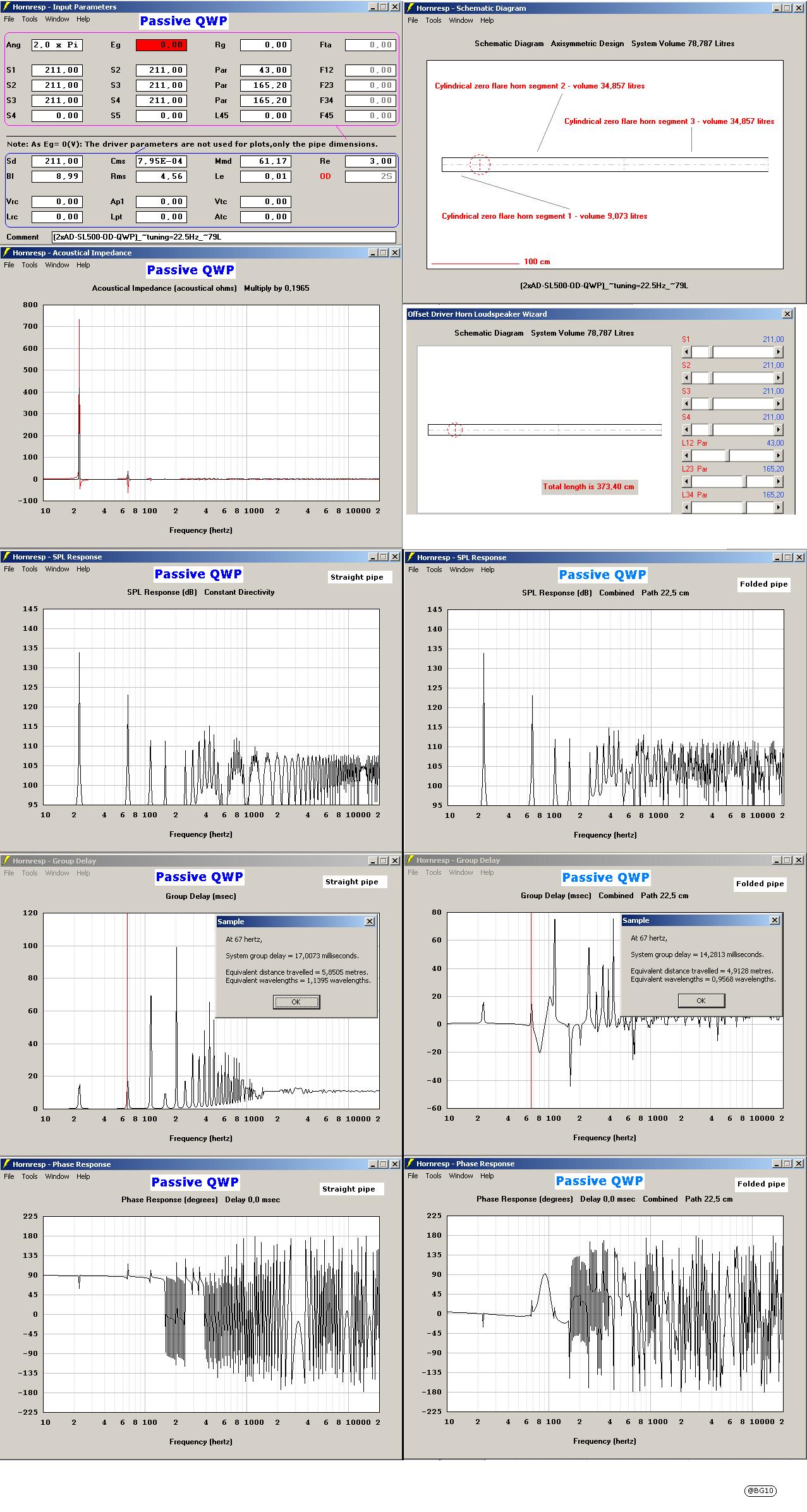

Hi IG81,
Try learn HR (Horn-response) but I advise you to take a step-by step approach when using the program for a TL design (no stuffing is used) = OD or Nd in HR.
See the plots in my submitted pictures that for the very last pictures and plots
show an identical airways un-stuffed/stuffed MJK FR plots to compare with.
IMO: Its clear that your TL = straight QWP design lack a low f-3dB point when just by calculating your driver in box seen equivalent Qt value ( depending of the closed pipe volume).
b🙂

The driver's specs are suited for B%$3 WC, TH or similar loading, but I assume don't have enough Xmax for acceptable performance anywhere near its Fs.
The long, tiny pipe will compression load the driver, reducing its effective Qts, further over-damping them. It won't make for an accurate reproducer, but it will be very 'tight'/'fast'. A max flat impedance TL OTOH will work well, though will have a much higher tuning same as a T/S max flat vented alignment (22.5/0.282 = ~79.8 Hz), but a much slower roll off, so much more accurate with ~transient perfect response.
Driving these with a high output impedance will raise its effective Qts which will in turn increase the net pipe volume required, lowering its compression loading, max flat impedance tuning.
WRT choosing a TL alignment with a Qts < ~0.4, calculating a T/S max flat alignment to get an acceptable cross sectional area (CSA), tuning has worked well enough for me, but I did these long before MJK's work, so tend to be larger in the few I've compared, though should still be fine for choosing a tuning (~32 Hz for this driver). For > ~0.4 Qts, I use a max flat impedance alignment.

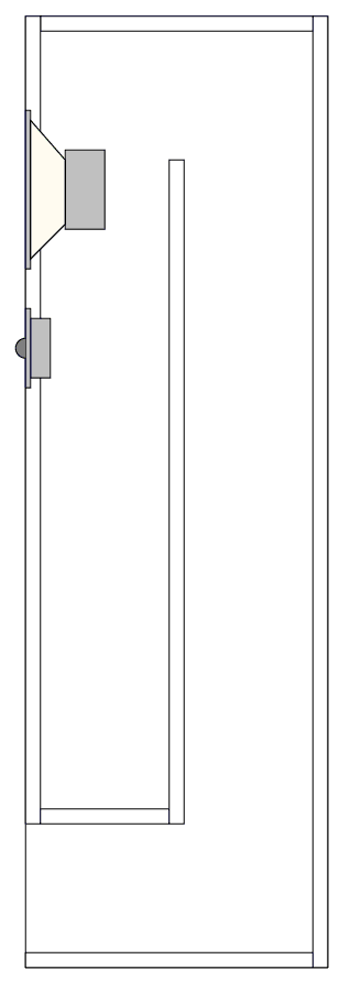

Before I got to read your answers, I already calculated for a ~35Hz tuning. It would yield pretty much the same external box dimension, with a single fold this time, CSA increasing a bit this time.
I checked with the physical build with ¾ ply and would have the following geometry:
L = 89.5", yielding a theoritical 37.7Hz tuning
CSA = 8" by 6.5", 52sq.in
driver offset (0.349) = 31.35"
I think that would be a saner aproach. I'll try to look it up in HR, see what I can do. For now I seem to be unable to download HR, websites seem to be down or something.
Here's what it'd look like:
48" high, 15.25" deep, 10.5" wide. The side panels would sandwich all the other 8" wide front, back and interior baffles. Not show are corner 45deg braces and perhaps a few braces along the way to subdivide baffles into smaller sub-panels. I would initially stuff the first 2/3 of the line and experiment to suit my taste.
IG

Especially on the long line section in the back of the cab, wouldn't the 45deg corners help reduce standing waves by eliminating parallel surfaces?
Other than that, how does this last geometry look to you guys?

Tapering the line will help mitigate the ripples. Upon closer examination of your drawing, I suggest you either shorten your vertical brace somewhat or put the woofer higher so there is a clear path for the woofer's back wave to travel down the line to the exit mouth. Slant the vertical wall so the line tapers going from top to bottom. Read up on this at Q-W.com.

Only where the reflectors are large WRT the WLs, so typically only affect the BW well above the cab's pass-band, ergo irrelevant since even minimal damping will quell them enough. Acoustically, tis better to leave them as is since the slight bulging of the corners act as a series of low pass filters to help roll off its upper pipe harmonics.
If it follows MJK's math, there's nothing fundamentally wrong with it, but a reverse taper works better IME for low Qts drivers since the stronger the motor, the more back pressure it want's to 'feel', so a shorter path-length for a given tuning is required if tapered.
