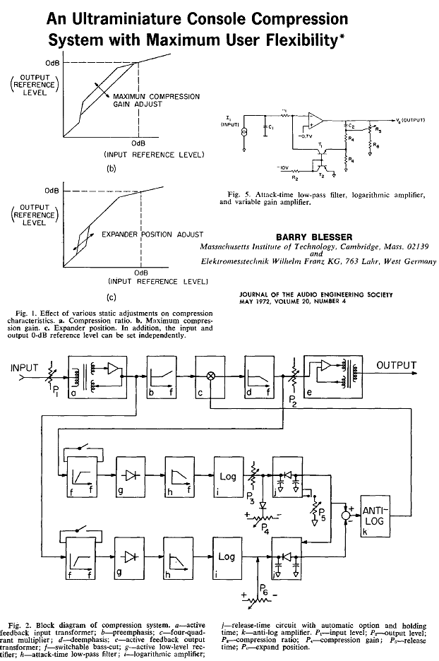

Blesser, B. (1972). An ultraminiature console compression system with maximum user flexibility. Journal of Audio Engineering Society. 20(4): 297-302.

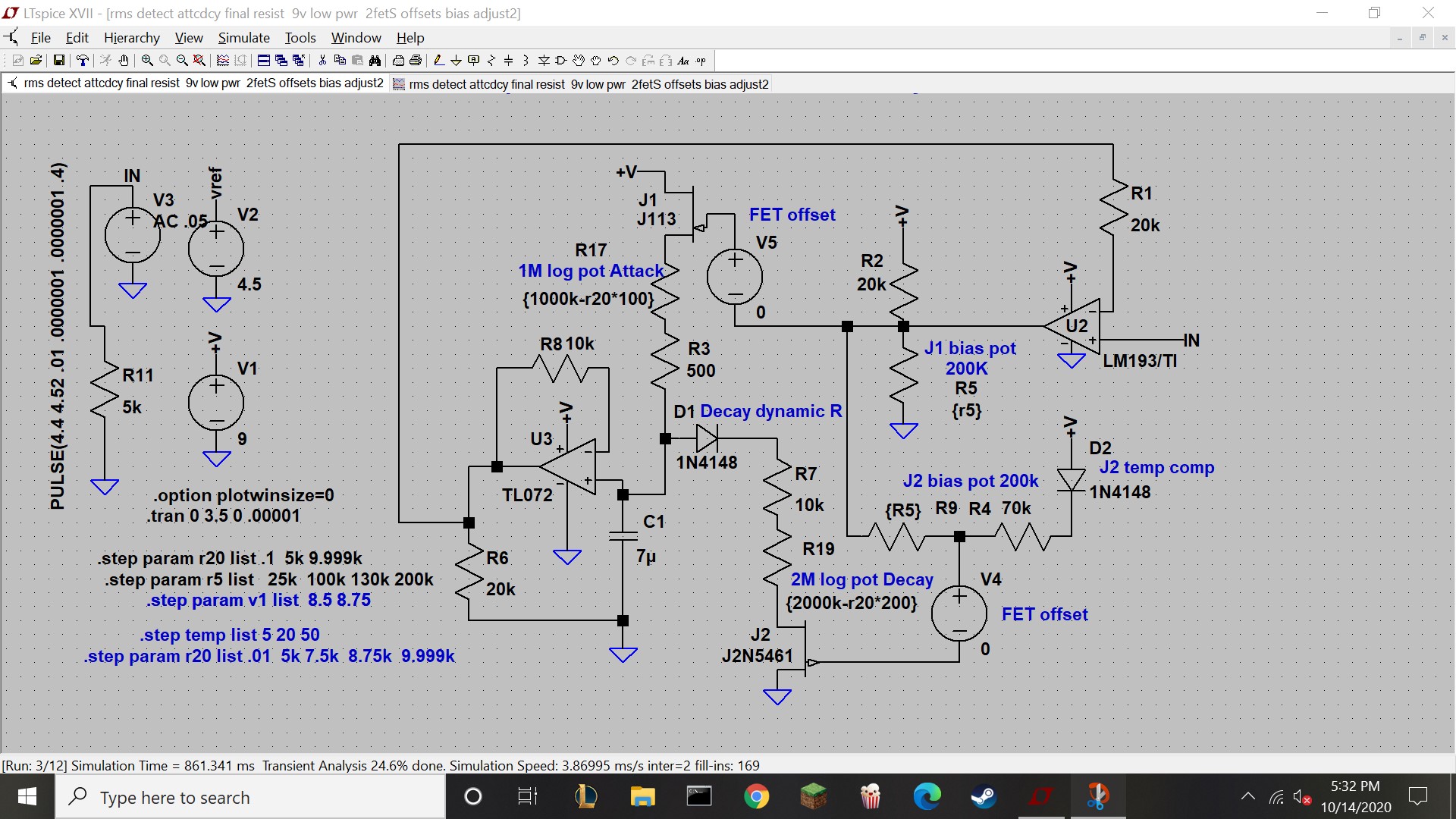

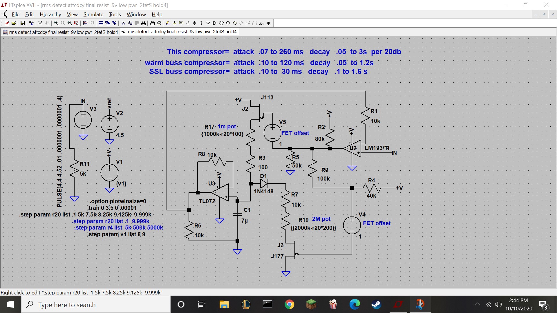

Thank you. Those are mostly comps that use a fet as the variable gain stage, Im using a VCA. What I learned is it is possible to use a fet in its ohmic region by adjusting the gate drive with a pot. 2 of those comps do that so Im assuming its reasonable, and dosnt drift too much.
These other fet circuits have made me rethink this and Im trying to trim out the offsets. Heres the circuit with some offsets and trimmers to adjust them. The sim works fine but Im wondering if Im missing something that will cause grief with the real fets. The one thing I see is the need for a V reg. A 1volt drop in V+ changes the TCs up to 50%. Not acceptable.

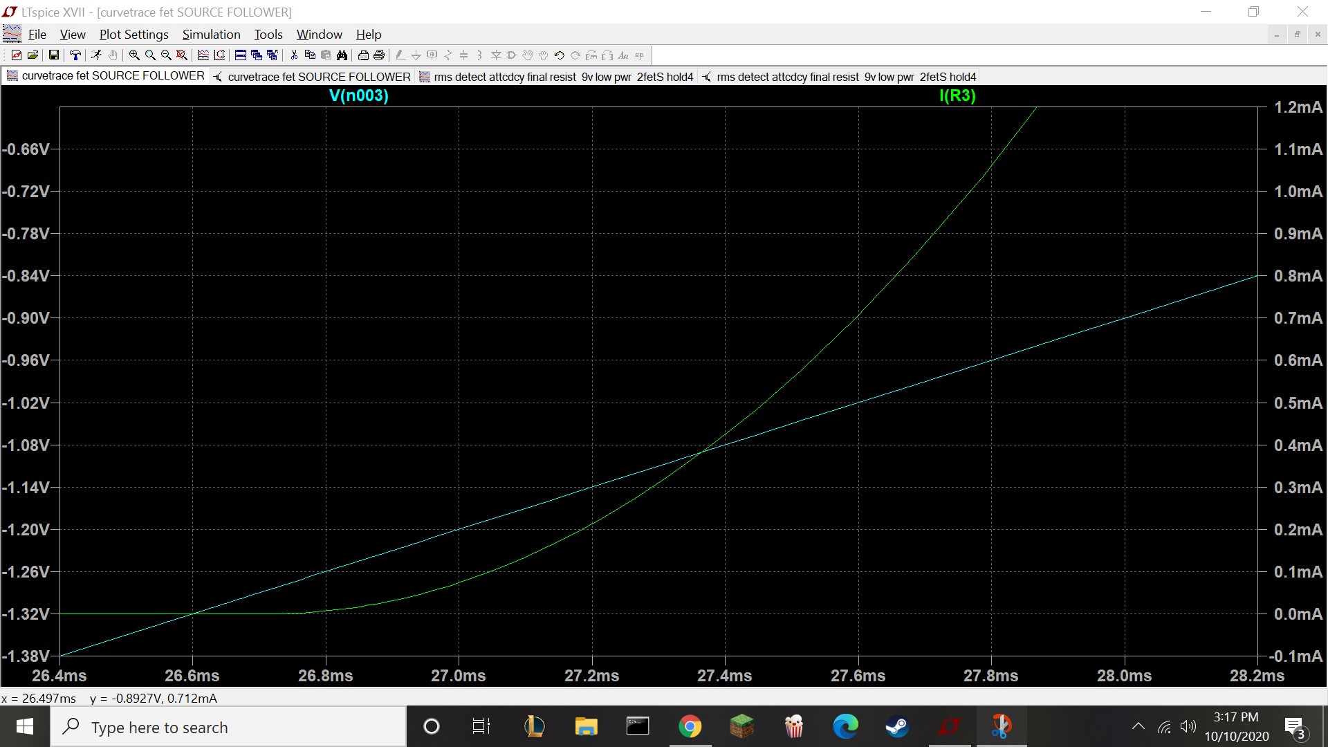

Do you expect anything to go wrong if the JFETs turn off more gradually in reality than in the simulation? If so, have you checked the drain current versus the gate-source voltage near pinch-off, with a constant VDS of a few volts?
Ild expect them to burn a bit of extra power but nothing serious, theres a 10k R between the 2 fets? Is that sentence about testing the spice model?

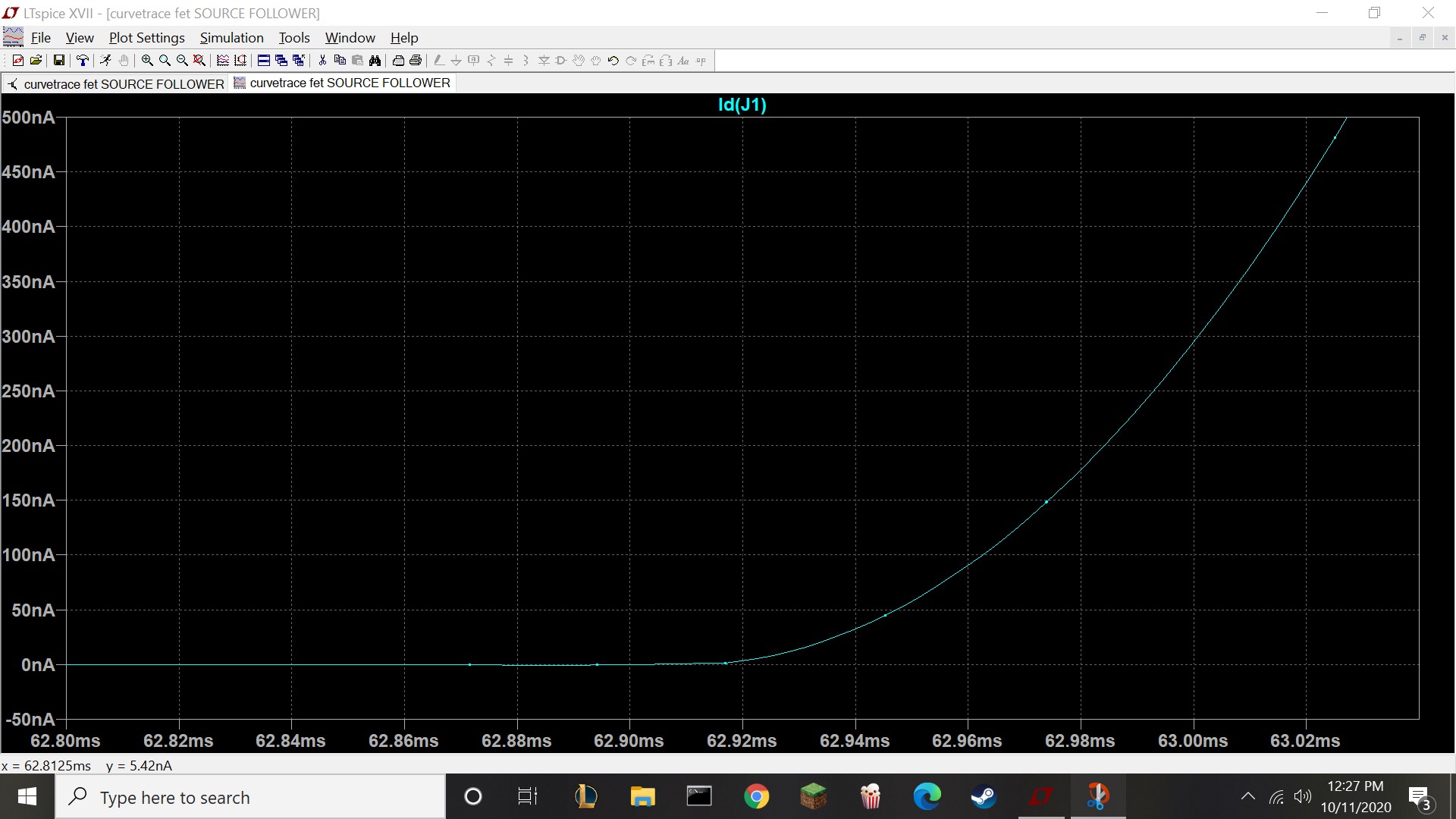

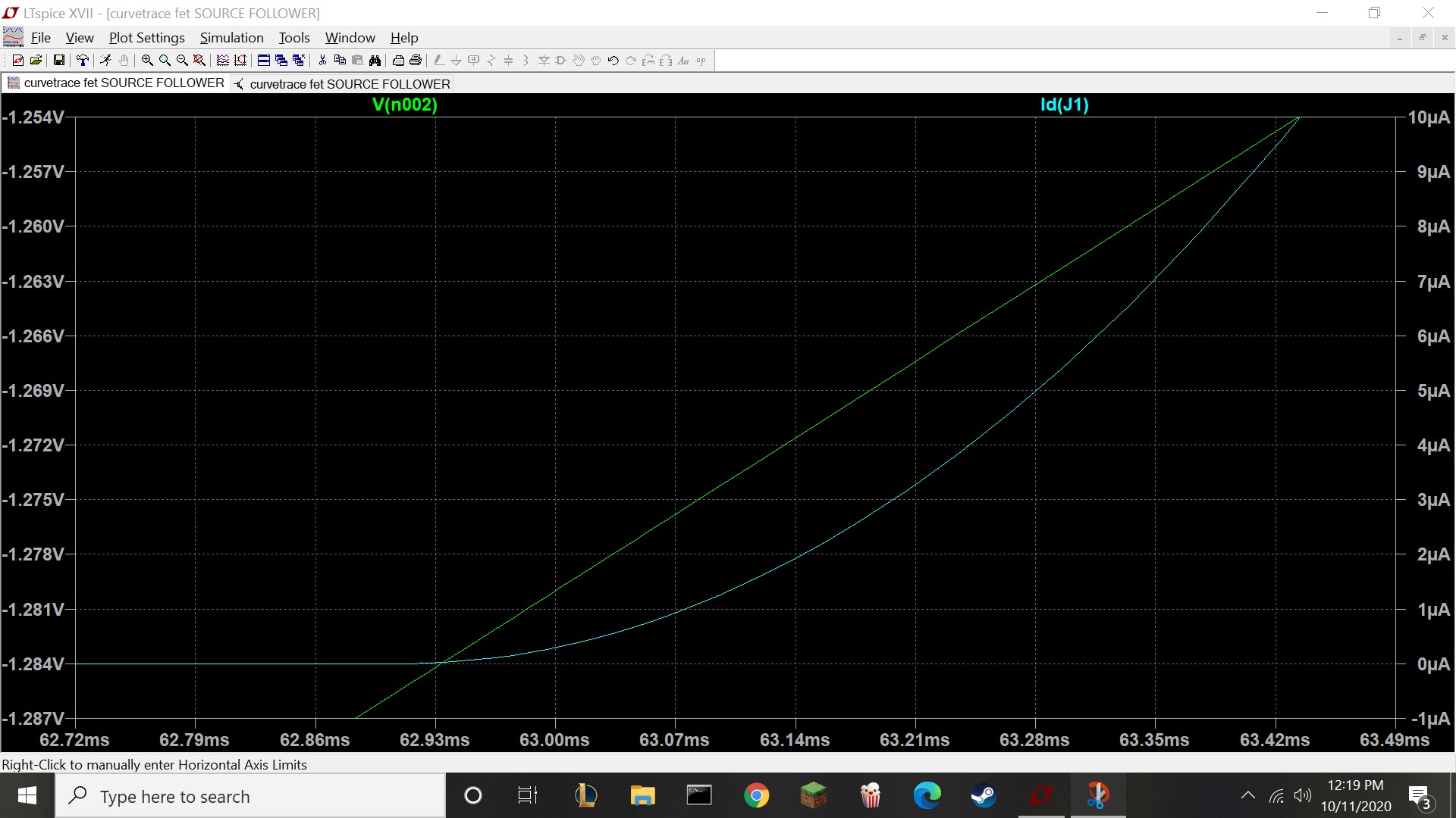

As you use them at microamp current levels, could you look at the part between 26.4 ms and 26.9 ms and either make the current scale logarithmic or zoom in to the part between 0 and 10 uA?
It's a simple quadratic model that is very inaccurate at the low current levels where you want to use the JFETs, but it could be that that just means that your circuit behaves better in reality than in simulations.
For low currents, the curves of the real-life JFET will be much smoother than what you get out of your simulator. As a rough approximation, imagine the part below 28 uA is replaced with an exponential voltage dependence where each 60 mV decrease of VGS causes the current to drop by a factor of ten.
As a result, the charging and discharging time constants will change more gradually than simulated as a function of the gate-source voltages. That could very well be an advantage.

Heres the circuit I will build. The bias adjust seems to work for Vps out as much as 3 volts and not too finicky ( a 5% change in the pots from the bias point dosnt change much ) . The temperature comp diode for J2 seems to help but not sure if spice is lying or not.
Marcel, 60mV/decade is the theoretical maximum subthreshold conduction slope for MOSFETs. For JFETs, the slope is much lower, usually under 20mV/decade. It is also strongly temperature dependent, which makes it totally impractical to characterize JFETs in that region. It is fair to say, JFETs should not be used close to the threshold/pinch gate voltage, the results are impredictible.
I'm no device physicist and certainly no JFET expert, like I wrote in post #3. I know JFETs have an exponential region because Peter Baxandall mentioned it in an article from many decades ago, so I just assumed it to be similar to a MOSFET in weak inversion, but without the voltage division between the oxide capacitance and a junction capacitance that you have in MOSFETs. (In a normal bulk MOSFET, you only get 60 mV/decade at room temperature when you drive both the gate and the bulk.)
If you are right, that means JFETs can have three times the transconductance of bipolar transistors at low currents. I always thought the transconductance to current ratio of a bipolar transistor was some physical limit.
Transconductance in a bjt is approx q/kT * Ic (S ~ 40*Ic), in a jfet fixed according to specs. At very low currents the transconductance of a jfet can have a higher value then a a bjt at the same current. But at Vgs < 0.8*Vpo or Vbe > 0.4V this does not apply anymore.
