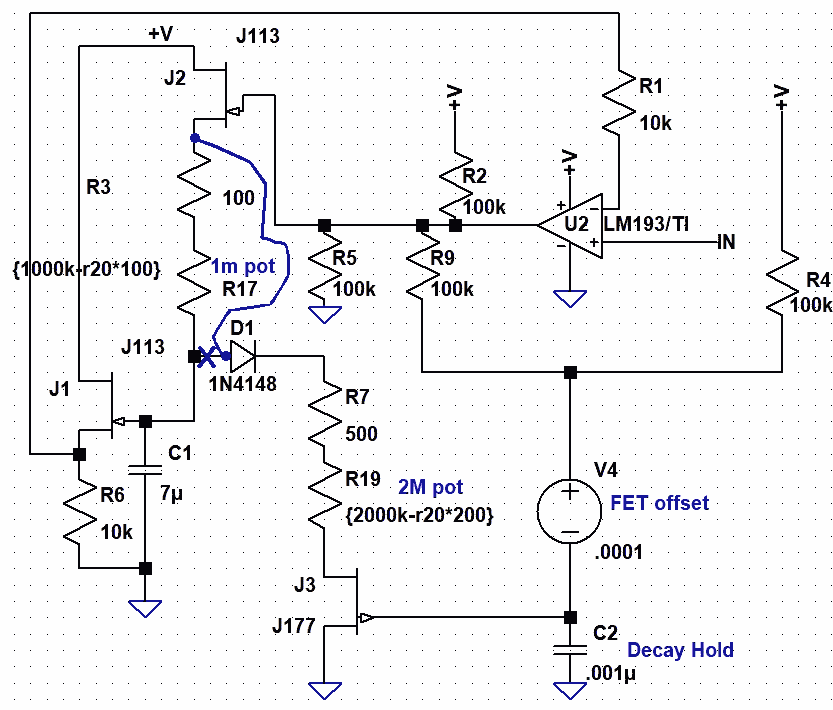

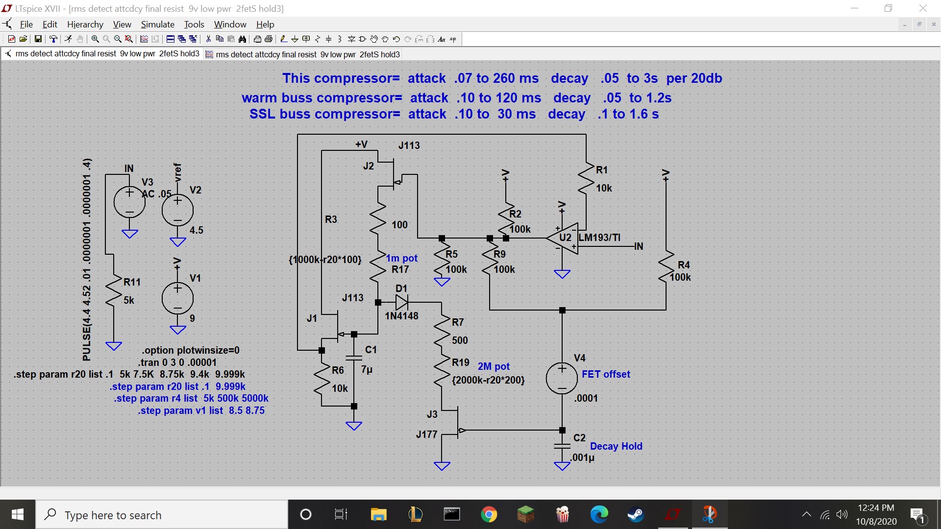

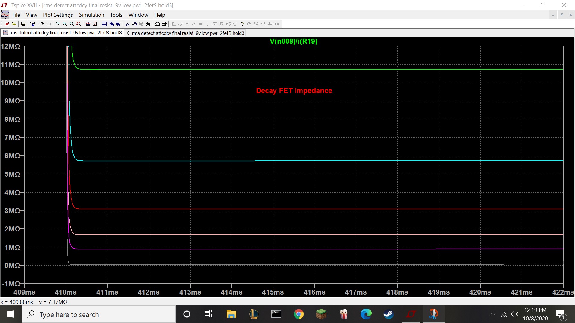

Not sure what that all means for the circuit I designed. Am I asking too much from the FETs, a relatively stable resistance ( a 10% chage is tolerable) that I can adjust from 100k to 12M ohms? At 5 volts thats only .5 ua. Well I already bought the FETs so its time to play. Will update after testing, which may take some time to figure out. Is there anything in particular you guys want me to measure? (if my limited test gears up to it).
You're asking for a lot. A JFET at 12M in the triode region is probably in deep sub-threshold and tracking over 2 orders of magnitude within 10% might be a problem.

At what point is the temp dependance the worse, close to Vp? Any way Ill try to use the .5 to 50 uA range (gives the TCs Im looking for) about a volt from Vp, and test the temp stability.
Did some temperature dependence testing with this circuit.
Vg=6v, Vref=4.5v
I set Id to 1uA with the 2M pot at 62F then changed the temp.
40F .99uA, 100F 1.04uA, 120F 1.05uA
So about 6% over 80 degrees F. Also did a quick test at Id=10uA which gave similar results. The diodes are working better than I expected.
