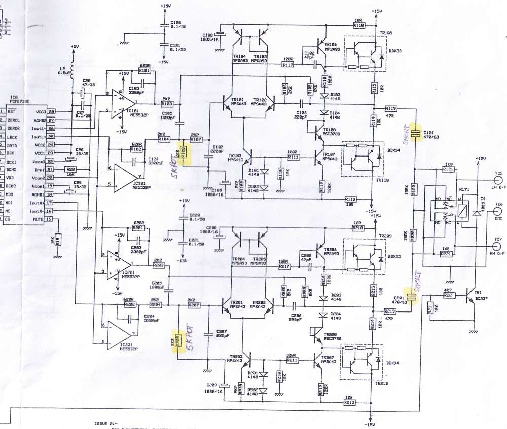

I have a dac (circuit below) that I feel the need to tinker with again. I have replace the 2 x NE5532's with 4 x AD825 and done some direct coupling mods with dc offset adjusters in yellow highlight.
I've just recieved 4 samples of TI's THS4031's.
With the ad825's having very low dc offset and fet input, the trimmers only have to be adjusted very slightly off the replaced resistor value of 2.2k to give me zero offset at the dc coupled output. The sound is very good this way.
What do you guys think the difference would be with the THS4031's replacing the AD825's, they are bipolar input does anyone know if the THS4031's have low dc offset say below 20mv and more important would they sound better than the AD825's in this position, I've noticed that a lot of people here love them and a couple have prefered them over the AD825's in the ouput stage of their players/dacs.
Cheers George

The offset value would be in the data sheet but I would think that the opamp offset would be MUCH lower than the bipolar diff amp following it, so that should not be a concern for the opamps.

Got the 4x THS4031 's in yesterday put them in the I/V stage and only had to adjust the 5k 25 turn trimmer a half a turn to get zero offset on the output, not bad, this opamp has good low dc offset for a bipolar input opamp, put it back in the system and wow!!! the mids and highs are so so much more transpaent than the AD825 's and it made mince meat out of the NE5532 's, but the bass it was a little anaemic, no balls compared to the AD825 's, but this was their forte.
So instead of getting on the merry go round I left the THS4031 's in overnight and left it turned on. What greated me the next day was a revelation, gone was the anaemic bass, it was even better than the AD825 's now, and the mids and highs were just as good as before even a bit better maybe. These bloody things like to get used to their suroundings, before they give their best.
I can now say that the THS4031 is the best for I/V conversion that I have tried to date, give them a go you will be surprised, but don't listen to them till their 24hrs old.

Hi George,
Why do you follow your opamp with a pushpull amplifier?
Is it something to do with the 5532? Or the DAC output levels (I'm not very familiar with the Burr Brown DACs)? Or are you simply outputting a bigger signal?
If its just buffering? What does it sound like without it?

Phil most dacs have an output opamp after the I/V opamp stage, my is just a discrete amp after the I/V opamp.
As good as opamps are for output stages, I would still rather have a discrete amp, this one is biased up strong into class A and it can output up to 6 watts, not that it ever does, and sounds better than anything I've heard. It's a Musical Fidelity A3.24, exactly the same as the MF Nuvister Dac with discrete solid state output instead of nuvister tubes.

Just have been looking at the THS4031/2 datasheets. Strange thing is the dual 4032 has 6 - 7dB higher 2nd order harmonic distorsion. A double THS4031 on a browndog would be better for dual opamp applications then, or keep it 4032 when you like 2nd harmonic... But this 2nd harm. declares problably the "involving" sound i perceive with this opamp.
Another nice feature of 4031, between pin 1 and 8 a DC nulling pot can be added, wiper on minus PS. A dc coupled I/V can be arranged with this.

I've now been listening to the THS4031 for over a week and I have to say that it is the most cleanest sound, especially through the mids and highs I have ever heard of the multitude of opamps I've tried, which is every one except the hidiously expensive OPA627, this could give it a run from what I've read, but at $60 a pop in Australia, you would have to be mad to buy it, and I need 4, and I've heard it's a bit too laid back for my tastes.
Now that I've told you about the good, let me tell you the bad, and it's a big one.
The THS4031 has one glaring problem compared to my previous favourite opamp the AD825, it does not have the rhythm of the AD825, and that is a major fault to me, it sounds so good that you forget your not tapping your foot, yet now and again you do get a bit of foot tapping rhythm come through but most of the time it sounds constricted in that department.
Back to the AD825 and your feel that the rhythm beast has been unleashed, even though it's not quite as good in the mids and highs it is still my favourite.
Conclusion, I hate opamps, there's not one that does everything right, I'm now starting to look at the ready made discrete type of I/V stages, and that is another world of hurt and anguish.

Yes, AD825 has some problems, it sounded the same as you say for me...
Because the IV is a very critical position. On each sample transition, the DAC basically outputs a step between the old and the new sample with a very fast slew rate and settling time.
Old crud like NE5532 is certain to go into slew limiting, then, and fast opamps will sound better.
