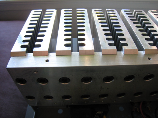

Hi Emile,
This amp has a lot of authority now (as the reviewers say), and with every change I could notice a slight improvement. As I said, I feel the single biggest improvement at normal volumes came from turning up the bias. So Yes, you should do this as well.
Start by disconnecting all outputs and inputs. Disconnect one rail fuse (either plus or minus side, whichever is easiest to reach) and hook a DC ammeter across the empty fuse clips. Turn on the amp and note the current drawn through meter. Mine measured only about 0.02-0.03A initially, and I kept turning the 1k pot (every 10-15 minutes in about 0.02A increments while the temperature stabilized) until it was out of travel, at which point the current was about 0.17A (and 0.18A on the other channel, which I dialed down to 0.17A so they would be the same). With your original heatsinks, you may not be able to turn it up this much without it getting too hot. On mine, I had to put in larger range pots to go above 0.17A, but I don't think you will need to do that.
Tosh

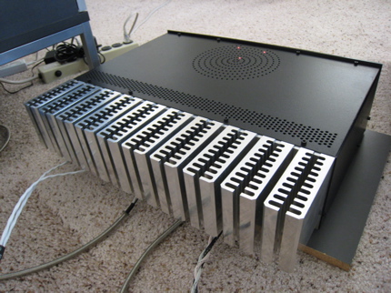

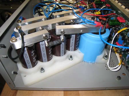

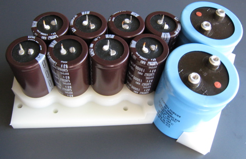

Jaycee, the output stage is what it is, and there was never any chance that I would try to redesign the amp. And it has fuses to prevent it from trying too hard. (Even with smaller 3A fuses on each rail - stock was 4A - it hasn't blown any yet, despite my attempts.)
Per rail, I added 4x15000uF to the existing 23000uF, splitting it up into (15+15) + 0R25 + (15+15+23) CRC per rail and added a 10uF and 0.01uF film. Could I do better?
About six months ago I had turned the bias up to 0.24A, and the amp was idling nice and warm. So a few days ago I decided to shoot for 4W of class A (into 8 Ohms), and turned the bias up to 0.36A! (So that's more than 12 times the factory setting!) Warmer, but still within reason, so I reckon these new heat sinks are working pretty good.

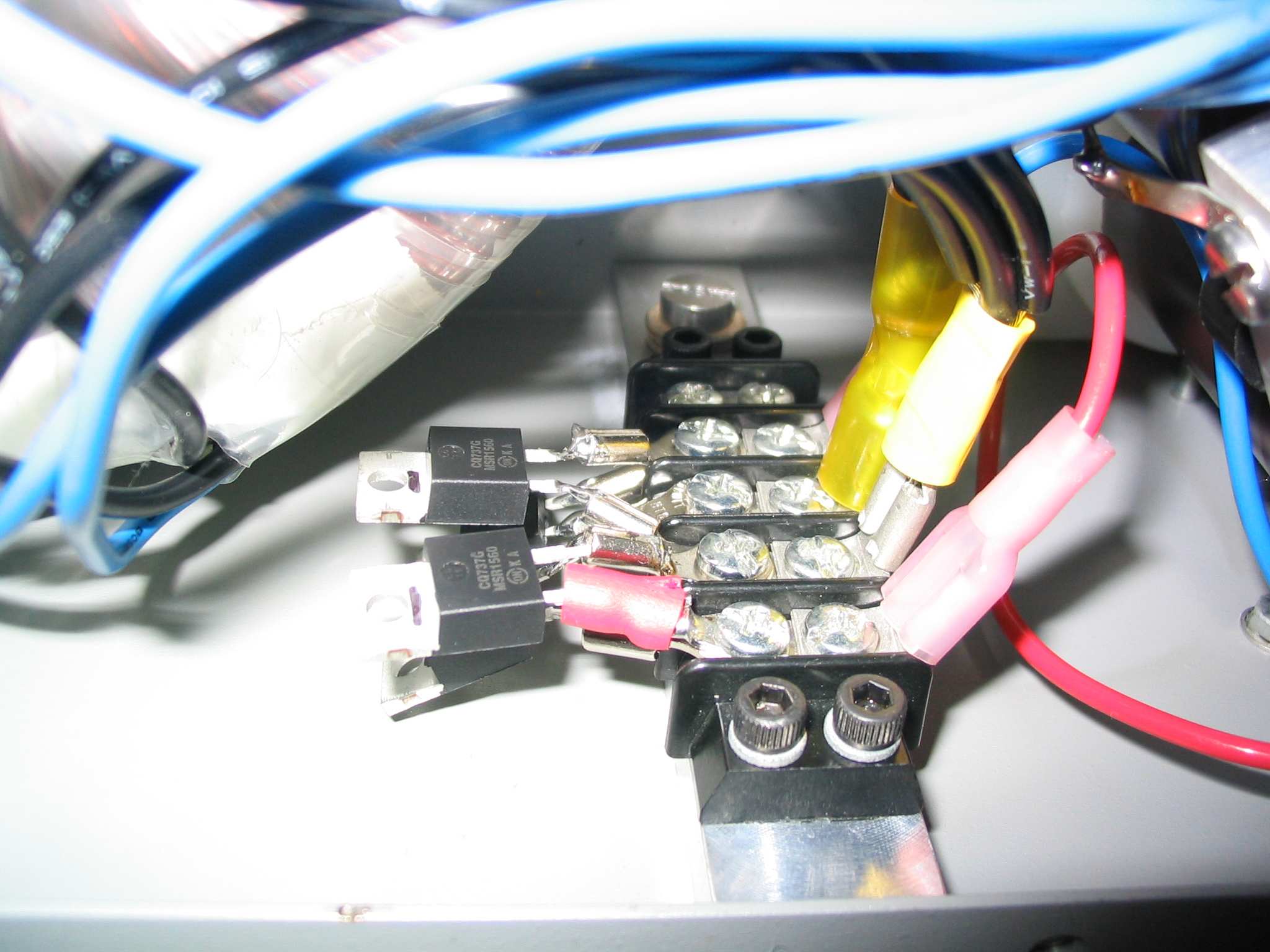

Today I finally got around to installing the new rectifiers. They get quite hot when playing very loudly, but I think they'll be fine without a heat sink. It's hard to say if they sound any different (perhaps the top end is a tiny bit better), but I'm pleased that they're in -- and that everything still works!

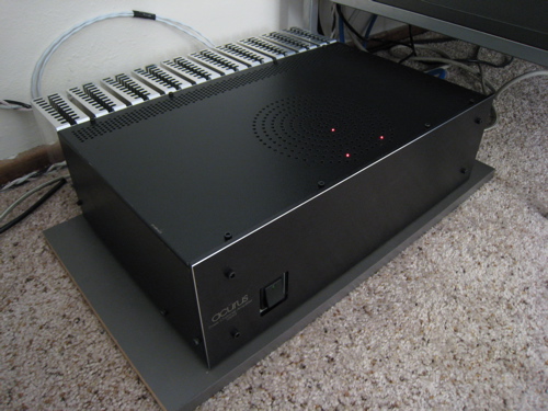

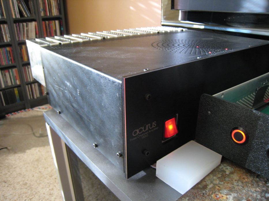

I had big plans to make a new front panel using a latching Bulgin switch, but when I actually laid hands on the switch, it was too small to reliably operate with my medium fingers, so I reluctantly sent it back to Mouser and went with plan B as seen in next pic.
So anyone with an old Acurus with a switch with a flickering green neon can add instant old-school look with this $3 perfect fit direct replacement illuminated power switch:
540-YRM32F2BBRLN Cherry red illum switch

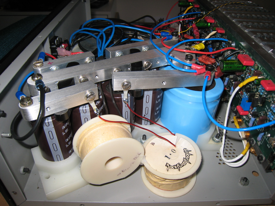

CRC to CLC update
I replaced the 0.25 Ohm resistors in the CRC with 18AWG 1mH inductors that have ~0.2 Ohm DCR.
before:
V rails = +/- 51.8VDC
ripple (with amps connected) = 8-10mVAC (meter not steady)
after:
ripple (with amps connected) = 3-6mVAC (meter not steady)
I didn't expect to hear much difference, so I was satisfied to immediately notice the amp sounding darker overall while the highs became cleaner and more detailed. But I also came to realize that there was also a nice improvement in the bass control and definition, making it easier to hear exactly where the woofers go 'wooly.'
This brute force approach to the PS is really working well in this amp, and I will use a CLC and aim for 100,000uF per channel in my designs from now on.
