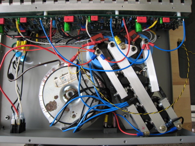

The new transformer has 5 independent secondary windings, so it made a bit of spaghetti hooking it up.
I also added larger 14AWG supply wiring.

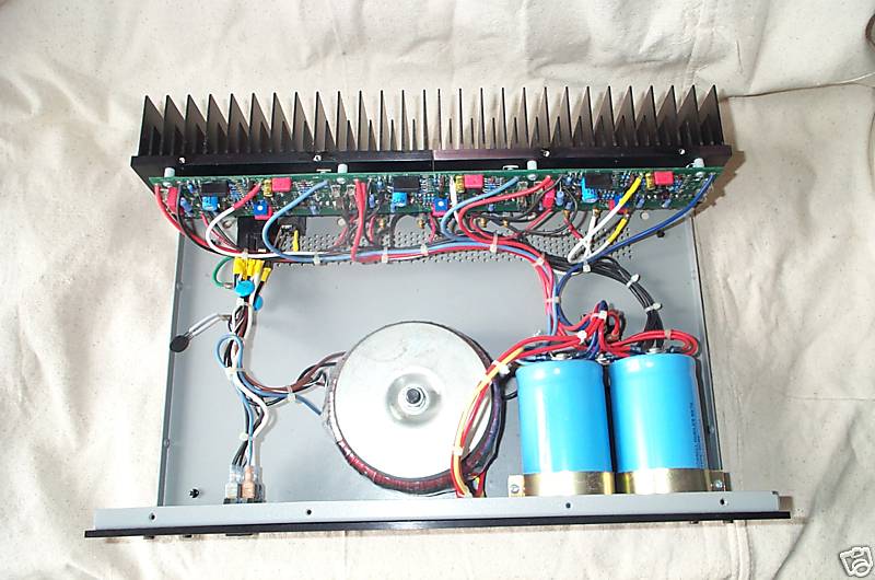

I have one gripe with all of these mods - you have increased the power supply's current capacity, but you have NOT considered that the output stage is now undersized... i would want more than 2 pairs of 2SA3281/2SC1302 (if ive read it right) for 60V rails into 4 ohm loads.
Ensuring supply collapse will happen before the output transistor's SOA is a common dodge practiced in commercial gear. This is undoubtedly one of the reasons why the 350VA transformer was picked. Your amp now has the current capacity in the supply to drive 4 ohm loads well, but you are now risking blowing the output transistors.
You would get a performance gain by replacing the 2 large caps with the equivalent capacitance in individual capacitors. Also add some decoupling with 470nF or so polyesters. Larger caps have higher ESR than a few smaller ones in parallel.

Jaycee, the output stage is what it is, and there was never any chance that I would try to redesign the amp. And it has fuses to prevent it from trying too hard. (Even with smaller 3A fuses on each rail - stock was 4A - it hasn't blown any yet, despite my attempts.)
Per rail, I added 4x15000uF to the existing 23000uF, splitting it up into (15+15) + 0R25 + (15+15+23) CRC per rail and added a 10uF and 0.01uF film. Could I do better?

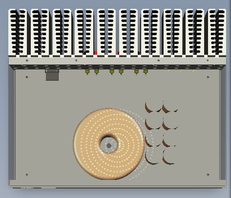

CRC to CLC update
I replaced the 0.25 Ohm resistors in the CRC with 18AWG 1mH inductors that have ~0.2 Ohm DCR.
before:
V rails = +/- 51.8VDC
ripple (with amps connected) = 8-10mVAC (meter not steady)
after:
ripple (with amps connected) = 3-6mVAC (meter not steady)
I didn't expect to hear much difference, so I was satisfied to immediately notice the amp sounding darker overall while the highs became cleaner and more detailed. But I also came to realize that there was also a nice improvement in the bass control and definition, making it easier to hear exactly where the woofers go 'wooly.'
This brute force approach to the PS is really working well in this amp, and I will use a CLC and aim for 100,000uF per channel in my designs from now on.
