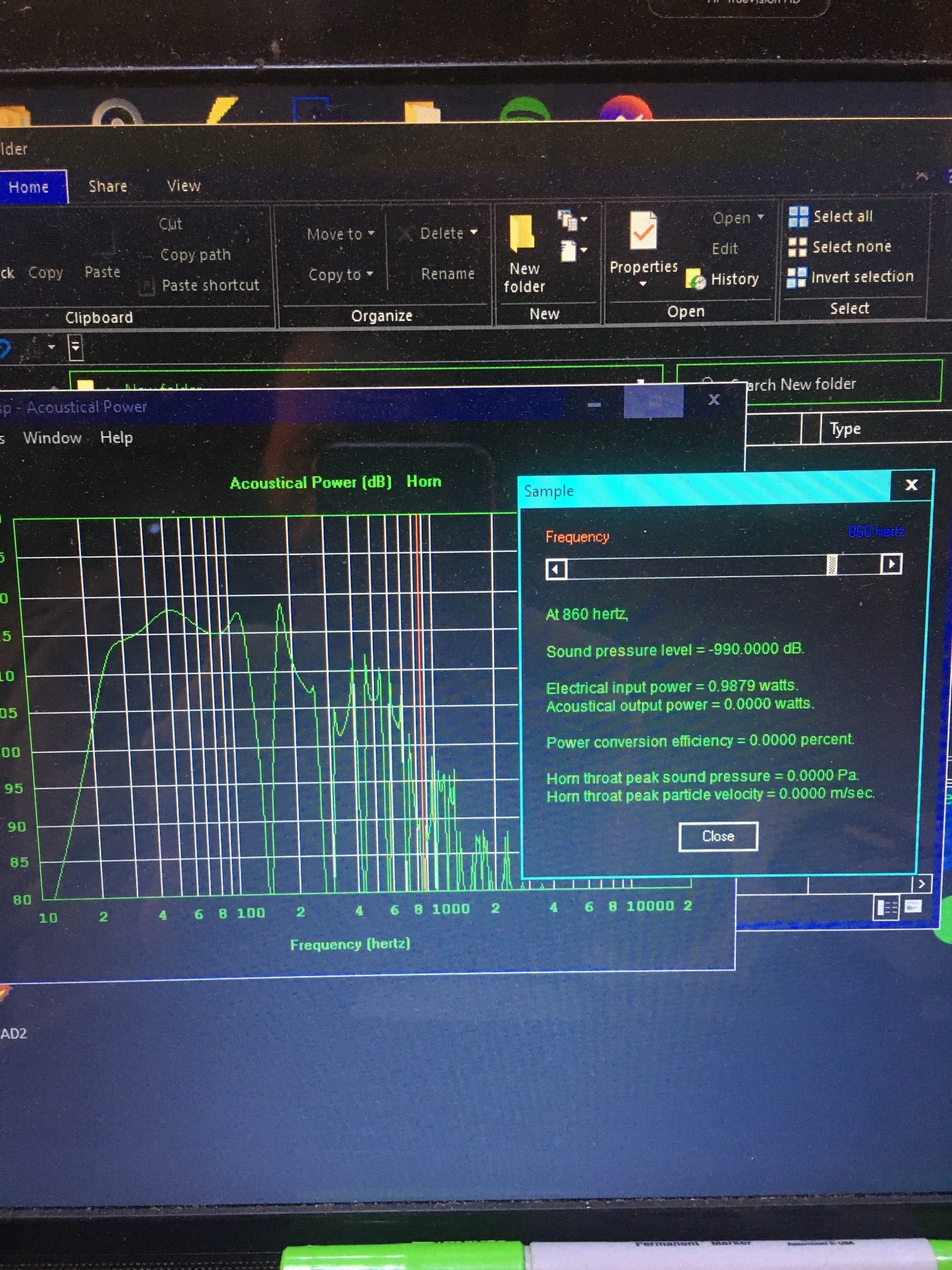

The basis for that would be the swing of the pendulum 100 cm long raise it up 15° and release it it will swing all the way across in one second that will be 30° or pi divided by six or 05238 raThe basis for that would be the swing of the pendulum 100 cm long raise it up 15° and release it it will swing all the way across in one second that will be 30° or pi divided by six or 05238095238 radians.
Then if you take a sphere with a radius of 0.5 just like the straight line distance across that arc in the pendulum, And place it into a cube with L what length onAnd place it into a cube with As 1 m then you will displace water in it with the sphere and that will be five to .38% by volume.

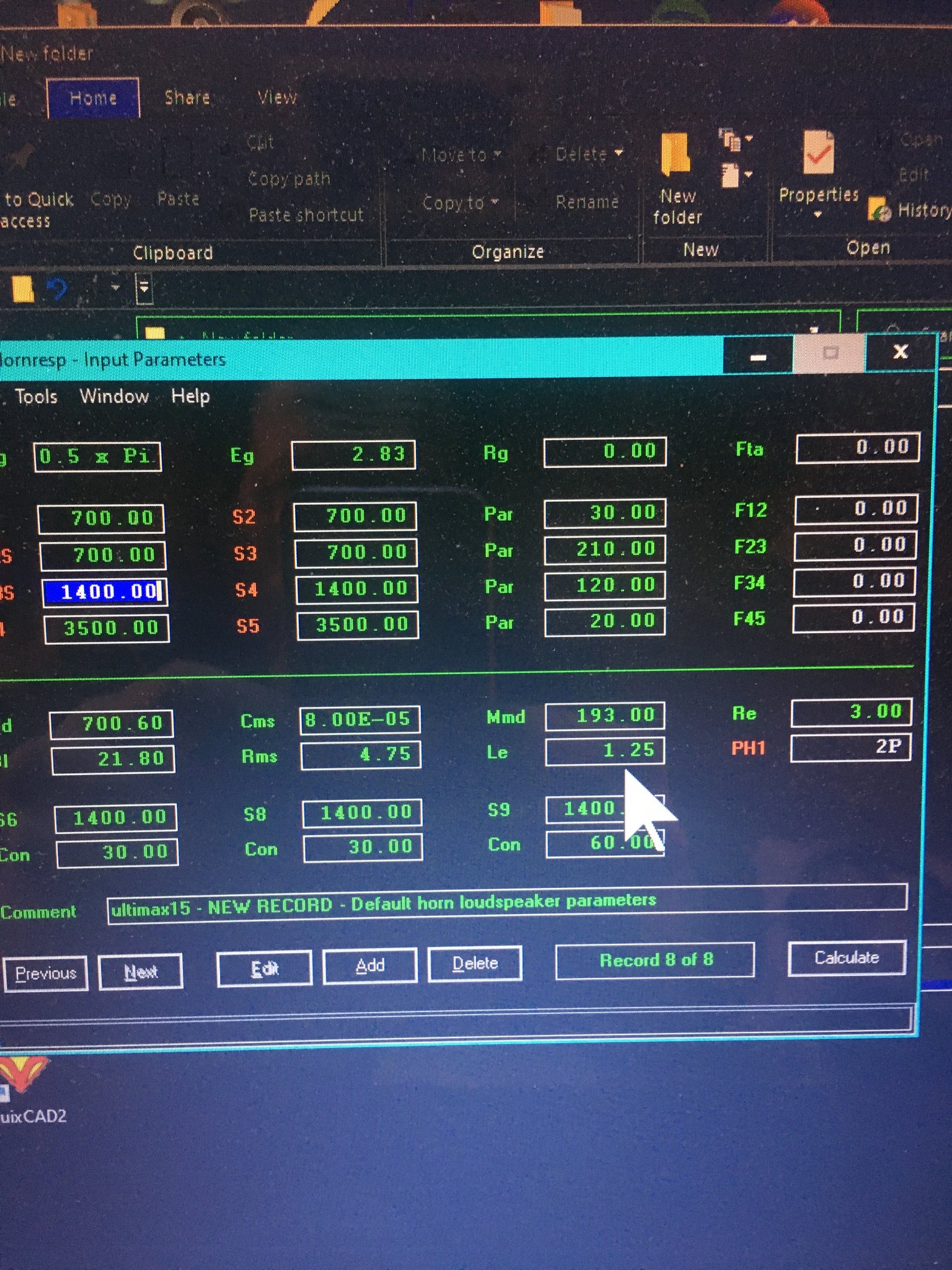

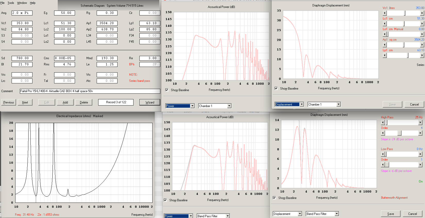

Fabyo,
Your 714.5 liter series BP6 simulated response drops like a rock below Fb (the impedance minima of 1.6 ohms) with a 25Hz BW24 the excursion is kept to around 12mm below Fb without an audible loss. Boosting below Fb wastes power and makes the rest of the range sound worse, though the flapping cones can make the the floor shake more ;^).
My general preference for sound quality would be a sub with raw rising upper response equalized flat, compared to one peaking at the bottom with the upper end equalized flat.
A pair of Faitalpro1400xl in a TH a bit over half the cabinet volume of the BP6 box would be capable of a lot more "chest thump".
If it were folded like the Keystone Sub, partially covering the Keystone exit could tune response downward to a similar response as the 714.5 liter series BP6, though with a bit less sensitivity.
I'd be inclined to build two singles rather than a double in either case, simply to afford more room placement options-a small room dominates the response of whatever sub(s) you populate it with.

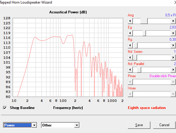

Thank you for your reply with even recommending something more pratcical! I must say though I can reach that much efficiency even with a BP of that size. I realize that i will lack kick-frequency if I dont go for TH. But I wouldnt say that your recommended model will be much more capable within my desired frequency range. Going for 400 liters sure makes it way more practical, but i will need a second enclosure just to reach that SPL. Instead I rather max out this one enclosure I got, since i dont plan to expand my budget. I got the room to work for it, i just dont want to exceed 700 liters, since it just will get too big.
Afaik getting a second sub gives me +3 dB. Going for double the size of the enclosure gives me the same gain. So why going small and twice the price of expensive electronics, if you can just double up the enclosure size 🙂.
I really appreciate your thoughts though, dont get me wrong. I just dont want to build an enclosure with lower efficiency than 116dB corner loaded with my settings for reference. I would appreciate your effort even more, if you could get me simple model that does those >116dB with a smaller enclosure 😀.
As for now i get theoretically up to 117-118 with my updated plan of a 6th order series.

Here's a TH half the size of yours , two of them go a little louder ;^)
Really, thinking about a couple dB when the room will cause +/-12dB (or more..) response variations, and won't be at all like a predicted 1/8 space response is a time wasting effort.
Roll your sub in and out of your corner, measure the response difference at the listening position, then get back to us :^)

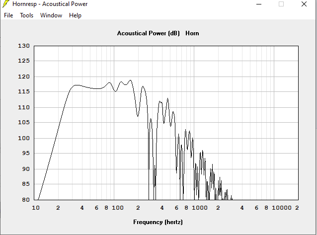

yeah.. well.. you can design a peaky response ofc and get even with 300 liters 119dB efficiency.. but compare it again to what i try to achieve... a flat but rising response towards low 30s. I'd say a decline of 4db maybe every 10hz until the 50s would be ok. But if i would apply yours without any modification i would haveo DSP a lot above the 60s.. Comparing it to my already built TL with a similar rise towards 25hz i can tell I dont want that kinda peaky response... it lacks consistency in tracks, especially if i shift my resonance towards 29hz. In your case with 34hz i would get sudden smashing loud otes on some DnB tracks and some higher notes in the baseline just lack the pressure...
Thats what i expect regarding the response curve.. I figured out TH are a better choice for efficiency, but still they lack a bit of consitency to my liking. You either sacrifice bandwith for simplicity and get a bass cannon that only play up to 90 hz, or you just craft something way too complicated for my liking.
I strated yesterday featuring out the PH model in hornresp. I guess the paraflex horn is more or less similar to a TH with the difference that you can build them with cooler and more intersting geometry. I got to say though that i struggle to find any explanation of what the parameters should describe after the actual 1/4wave hornsegment...
I doubt that you can get much more efficiency out of PHs if you get a decent TH. In any case i struggle with both 😀.
Ah and one more thing. Please consider using Eg =2,83 and Rg =0,30. Afaik you need to consider Rg of that dimension to simulate realistic conditions. Rg is supposed to be the amplifier output resistance. 0,3 is said to be equivalent to 10meters of cable. having 0 ohms as output resistance is not realistic at all.

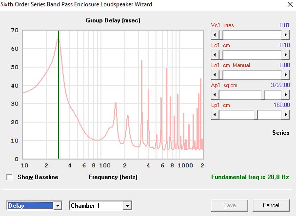

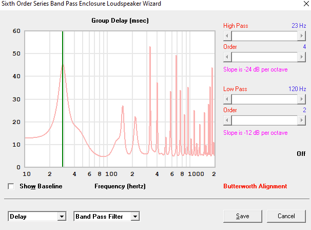

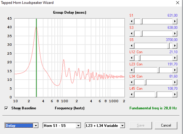

Comparing some TH models i try out with my BP 6th order project i find out that i get some nasty group delay at kick regions. Afaik peaky groupdelay tells me i get resonating responses. Ofc resonating responses below 40hz dont matter much but i dont want boomy kicks.
Did i get that assumption right that high and peaky group dealy leads to resonating frequency responses? Or is just the frequency response itself an indication for resonating sounds? I mean you could theoretically have a delayed response but cancel out waves and get no real resonance. Idk how that applies to subwoofer enclosures.

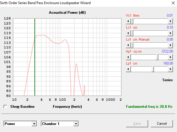

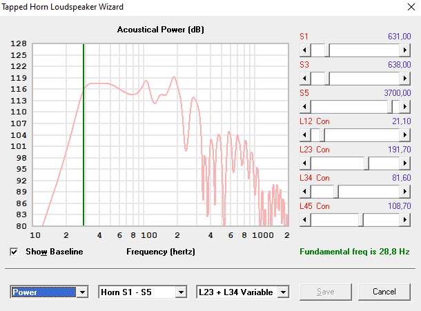

I just got confused on what you are refering the comparison with the TH from Art. You mean the new bandpass model of mine? I very much want a response depending only from the 50hz downards. As I mentioned before i dont really aim for any kicks but only sub bass.
Hmm, it seemed reasonable (to me) that the TH here was yours, so the obvious sim you wanted our thoughts on vs the sim here.
OK, but some of us don't have time to refresh/read from the beginning plus these threads have a way of 'evolving' to something radically different, so only going to respond to a specific question, ergo you'll only get as accurate an answer as it requires (at least from me).

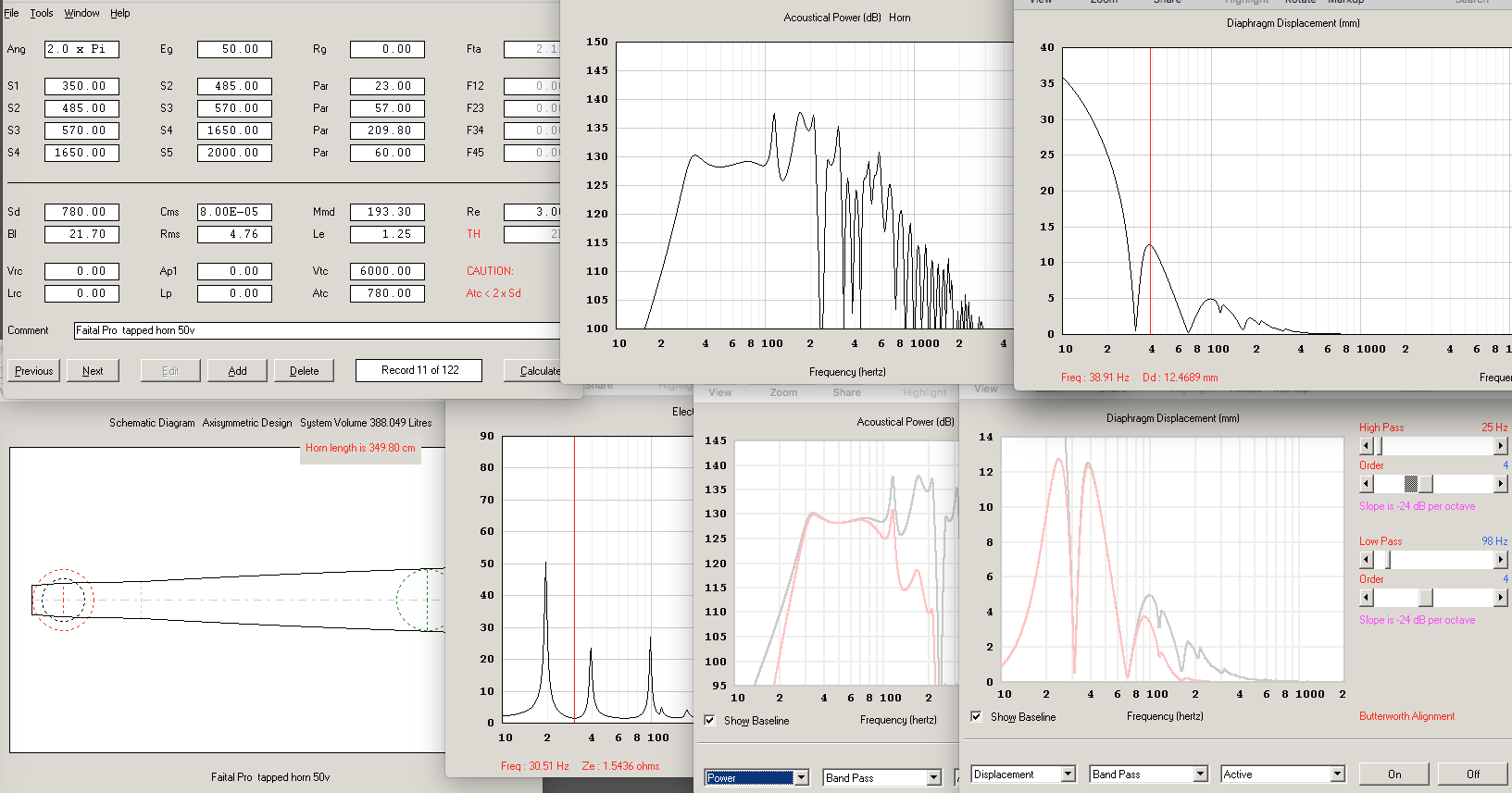

OK, for a 'one note' 20-40 Hz octave BP alignment; ideally want a -f12 = ~0.707*20 = 14.14 Hz, 40/0.707 = 56.58 Hz tuned to (20*40)^0.5 = ~28.28 Hz, which your BP6S meets once DSP'd, though being intrinsically under-damped (response 'sags'), ideally need to rethink it to flat or over-damped.

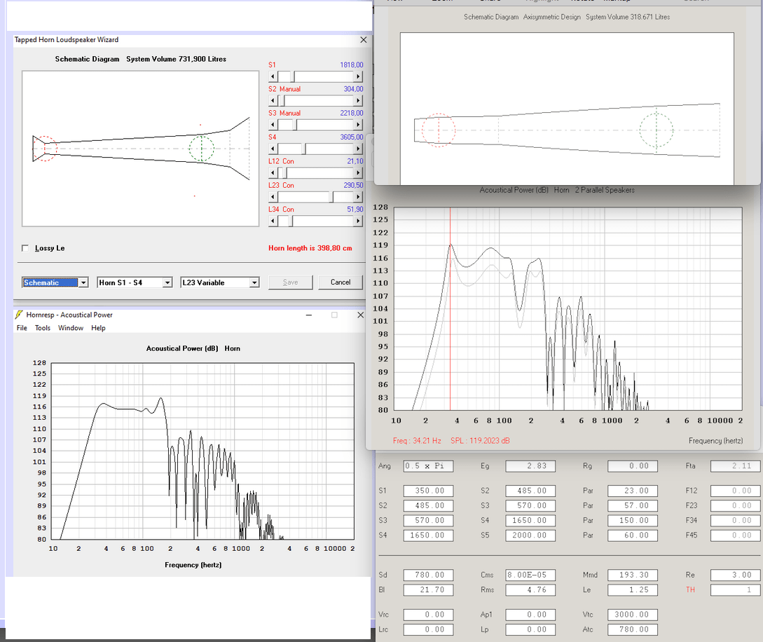

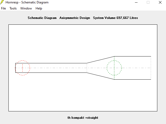

OK guys i guess i can go now with my 26 years in bass building pension ;D. I think i finally got the best of both worlds buy building a very simple TH design. I just started with my BP design translating it into the TH model and then fidgeting a bit with it. Look at this one now:
1. It is simple to build. Very similar to my recent model. Maybe i can split the tube simmetrically and center its opening. Some coolnes boost and maybe better radiation properties too.
2. It has no nasty delays below 100hz. Above it is just DSPable... i hope.
3. It can easily go down to 26-27 hz, with a little bit more volume at the opening.
It rather reminds me of a t-line now more than a normal horn. I call this one the tapped line xD

View attachment 1024498View attachment 1024499

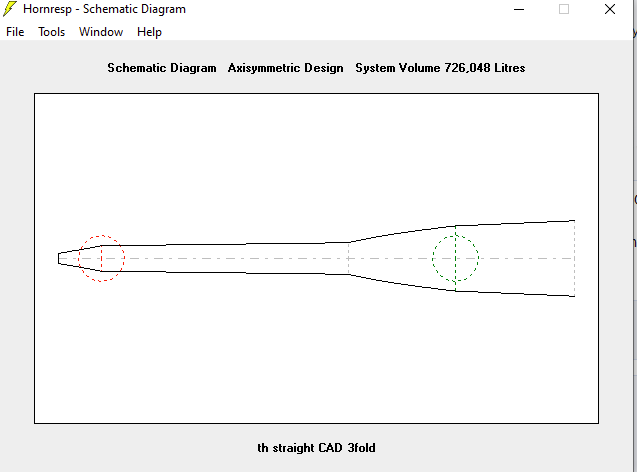

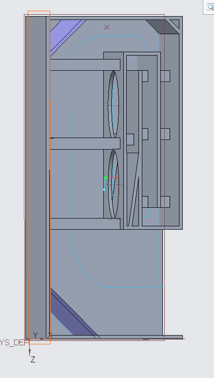

If you remove the tape or section just prior to the second driver entry you get a really simple and consistent layout. One that works quite well in a similar to a roar or Keystone without the aperture.
I don’t know how you do that turn or that opening there but it can be incorporated into three folds one of which lands right there upstream of the driver.
Thats the project now. I struggled to replicate the steady diameter changes and approached them by warying constant and linear diameter over the canal-length. The cad model got the hornlength right but the volume at the widening segment is a bit off, mine is a bit narrower, but it gets very sooner wider than the hornresp model. All in all i think i will get something like that, maybe a bit flater and lower than the simulated model due to the bigger but still narrower model at the widening section of the horn. The cad model looks like this now.
I got xmax ratings of 12,9 mm onedirectional. i got around 3,3 mm space until i would hit the wall with my cone. Afaik my subs move quite a bit in the t-line i already have. I wonder if 3,3mm space is safe enough for the cone.
