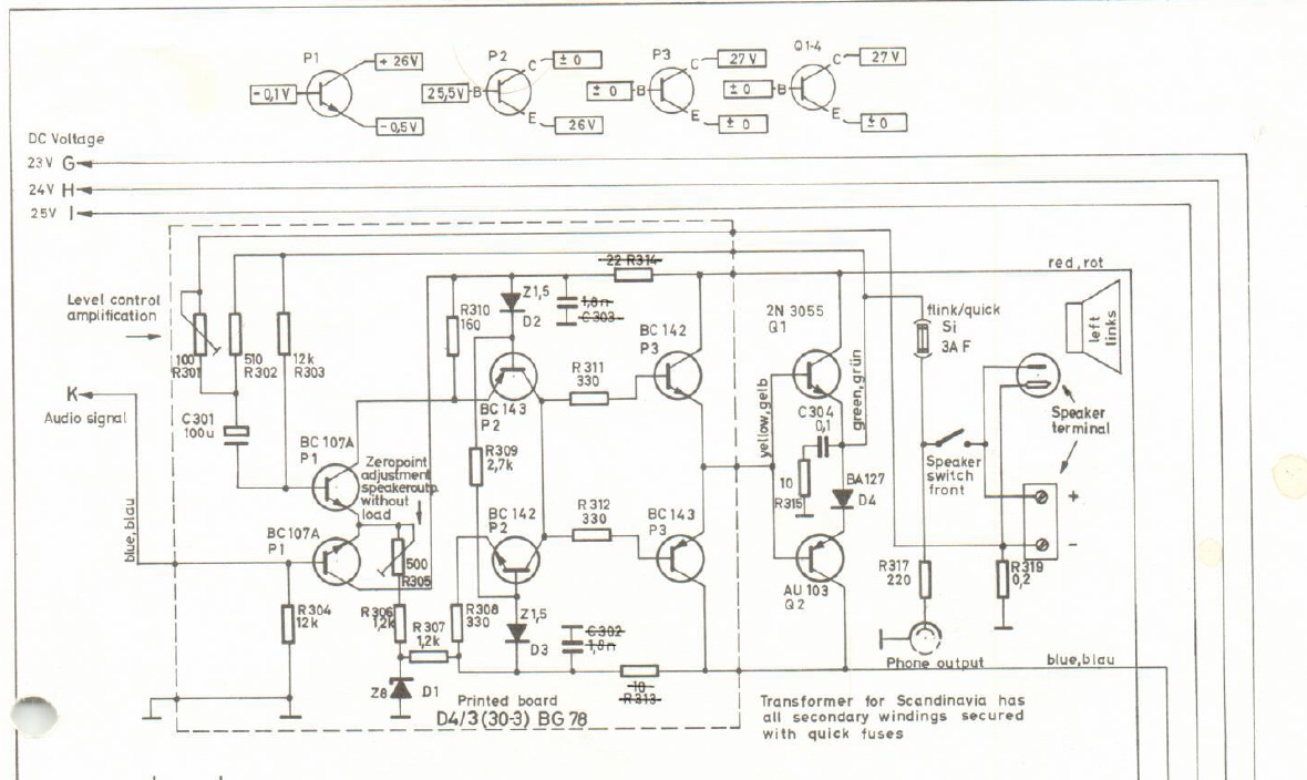

I have a Kirksaeter RTX400 here, which has now been completely overhauled, but is a bit problematic when setting it up. There is a setting point specified as "level control amplification", but no value is available. I would generally assume that this (and a wattmeter on the output) is used to set the output. However, I don't have a device for measuring power. Is there any advice on how I should do this?

The current feedback control sets the output impedance. The Zout interacts with the loudspeaker driver (will range from boomy and warm to tight but perhaps shrill and in your face with upper midrange emphasis). Tune it to YOUR liking. There is no “correct” setting.

But how do I set R301 (as an example) to 4 ohms?
