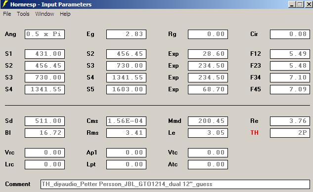

Aha, here are input parameters (close to mine) of the Kraken 212 tapped horn. The 112 is very close to half. Should work fine for comparison between drivers.
https://www.diyaudio.com/forums/att...x12-th-kraken-212-th-hornresp_input_guess-jpg
The horn will soften the response, so some bumpiness due to exessive motor strength is recommended.

Thanks, I'll fire these into HornResp tonight and do some research tomorrow.

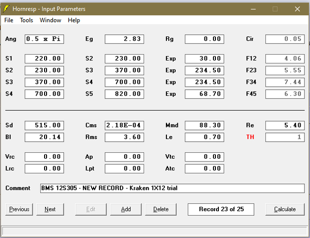

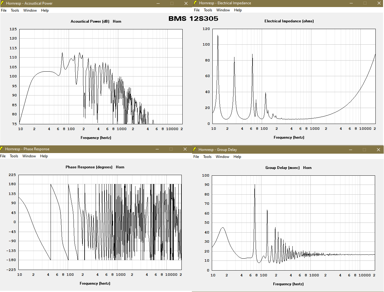

The BMS 12S305 simulated decently. I'll see if I can get an image up to show the results. First I'll have to find an image host 😉 .

Hmmm, I did not expect that broad bump in the band pass. Can you stare the input parameters please.

I remember there being a peak in the response for the JBL in and around 70-75HZ but didn't think it was an artifact of the horn. Every single driver I load into simulation in this horn has a huge peak in this range. I wonder if it's mouth related or something to do with the horn line itself.
The peak is positive interference between the front and back sound wave. That is one of the reasons people now days are exploring the compound horn family, it is easier to extend bandwidth while maintaining the efficiency of a horn.

Petter, the simulation I posted that was supposed to be for the BMS 12 was actually for the Fane FC-123F01. My bad.
