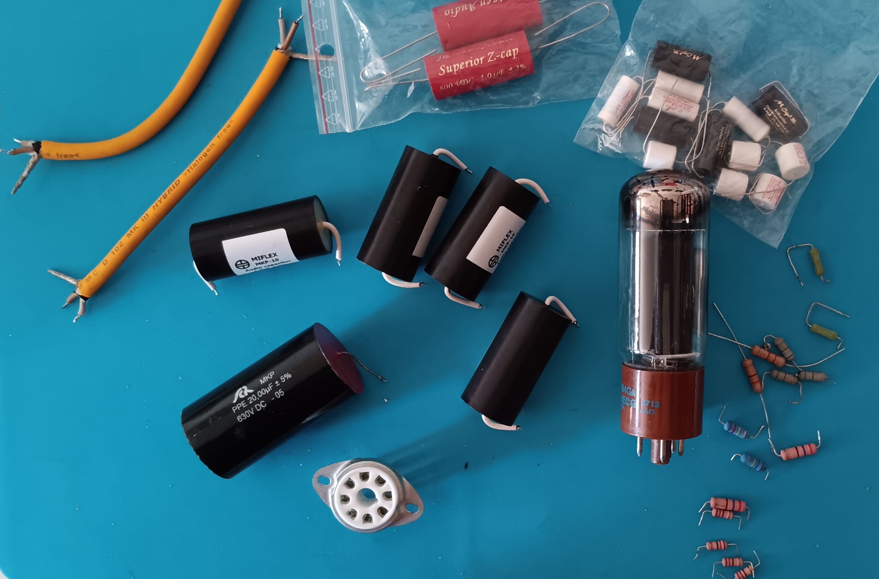

- Change coupling caps to Mundorf, I have some spares, various types

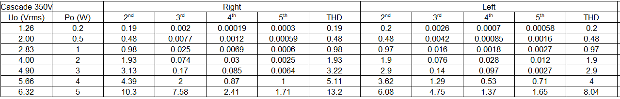

Distortion:
Opening the loop yields as expected from the feedback factor about half the small-signal BW, 19Hz to 23KHz. Not bad material for the price, the top end will hopefully be extended by improving the driver stage.

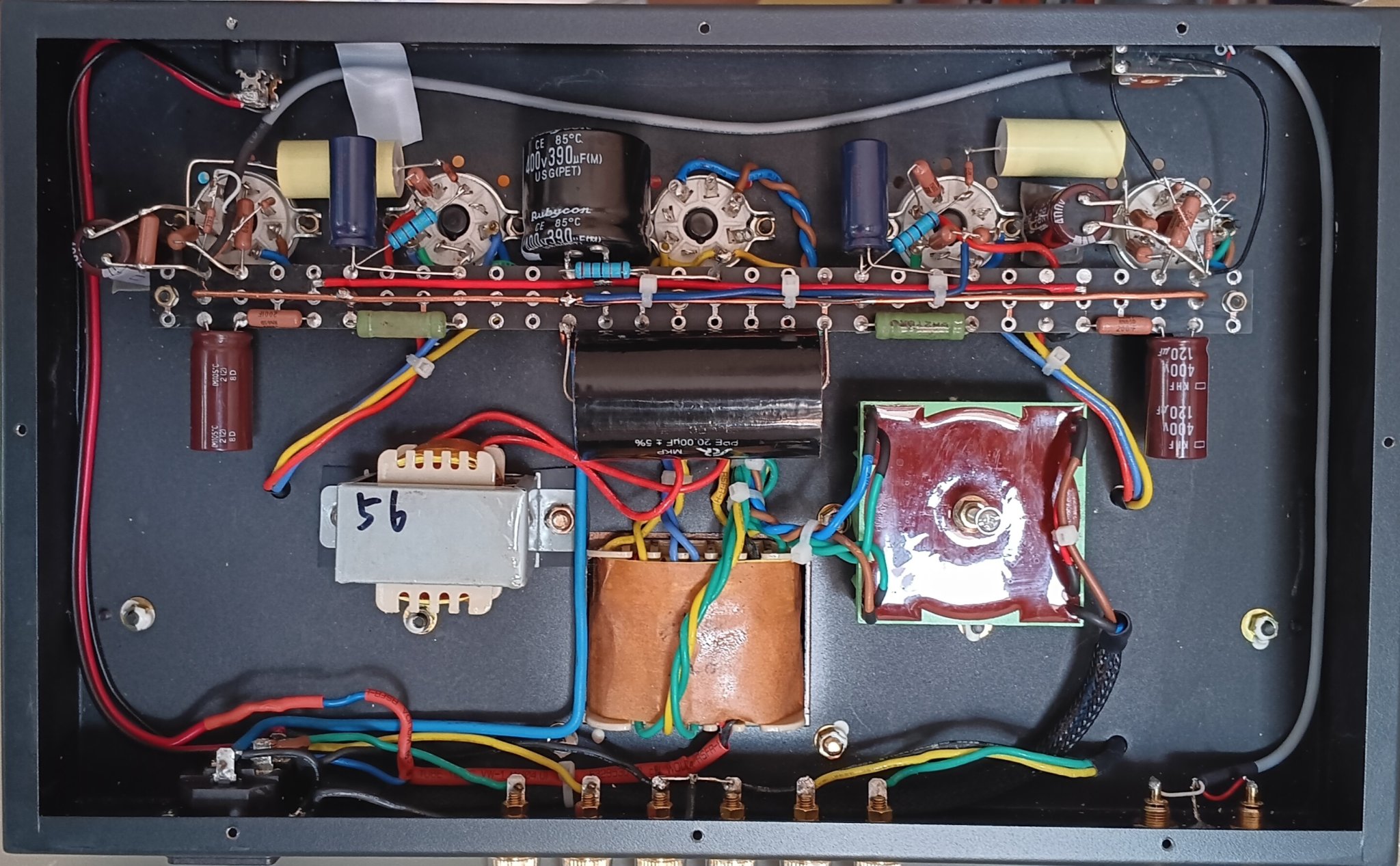

Despite being neatly arranged, the wiring is electrically very suboptimal, the left channel feedback wire being tied together with the HT ac wires, thus picking up severe amounts of mains and 2x hum:
That is the reason why the left channel hums more than the other one, not the choke or the smoothing cap value or anything else. The amount of hum is of course volume setting dependent as the garbage pickup gets shunted by the pot. Simply moving the 2K feedback resistor from the binding post to the input tube grid lead improves this significantly, but I plan to neither have feedback nor keep the same wire routing. Not even the heater wiring is twisted, so it radiates as mad. The grounding wiring is also suboptimal in several locations.
The right channel is in (a bit) better shape:
Basically the whole thing needs rewiring, and the topology many changes in my view. So that is only the beginning🙂

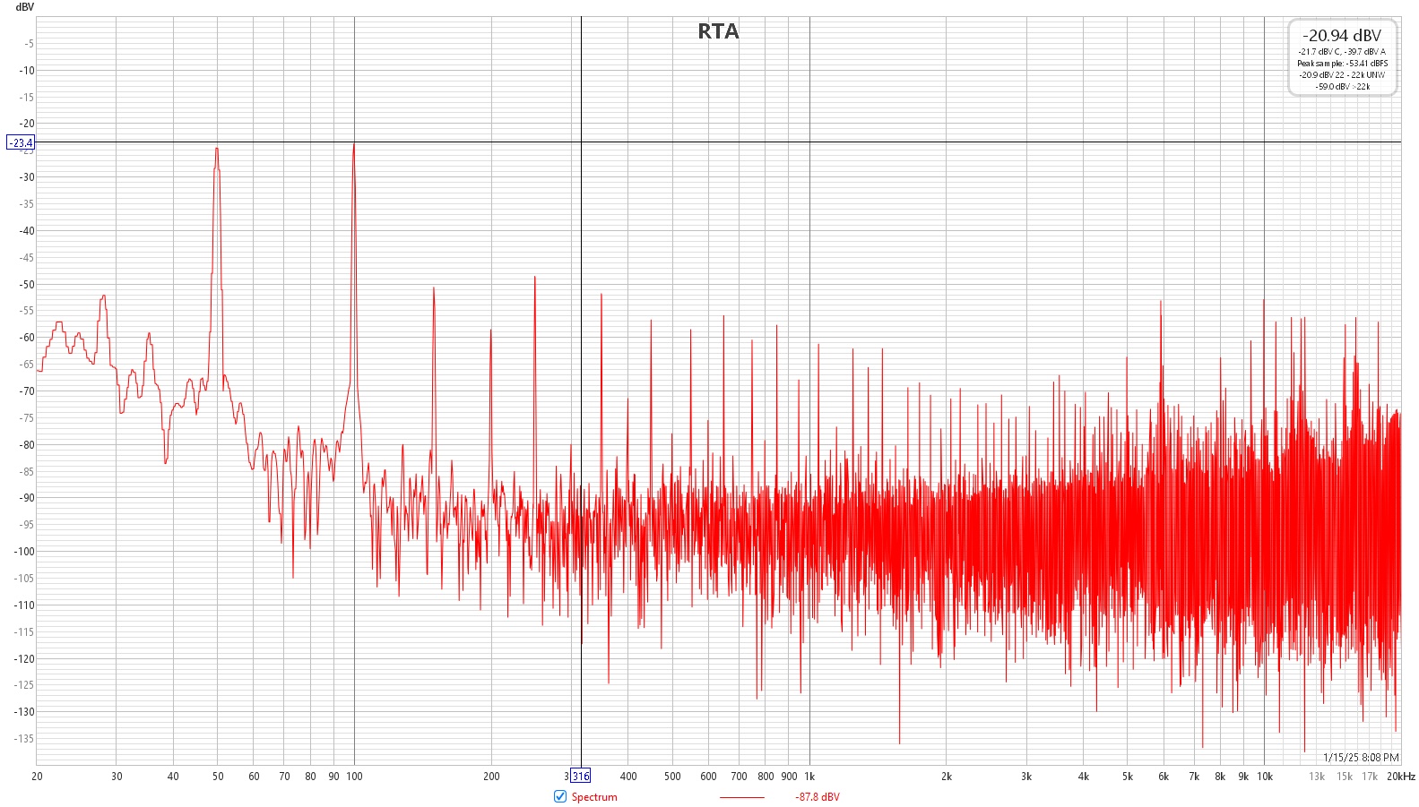

Amplifier noise spectrum, factory state, left channel:

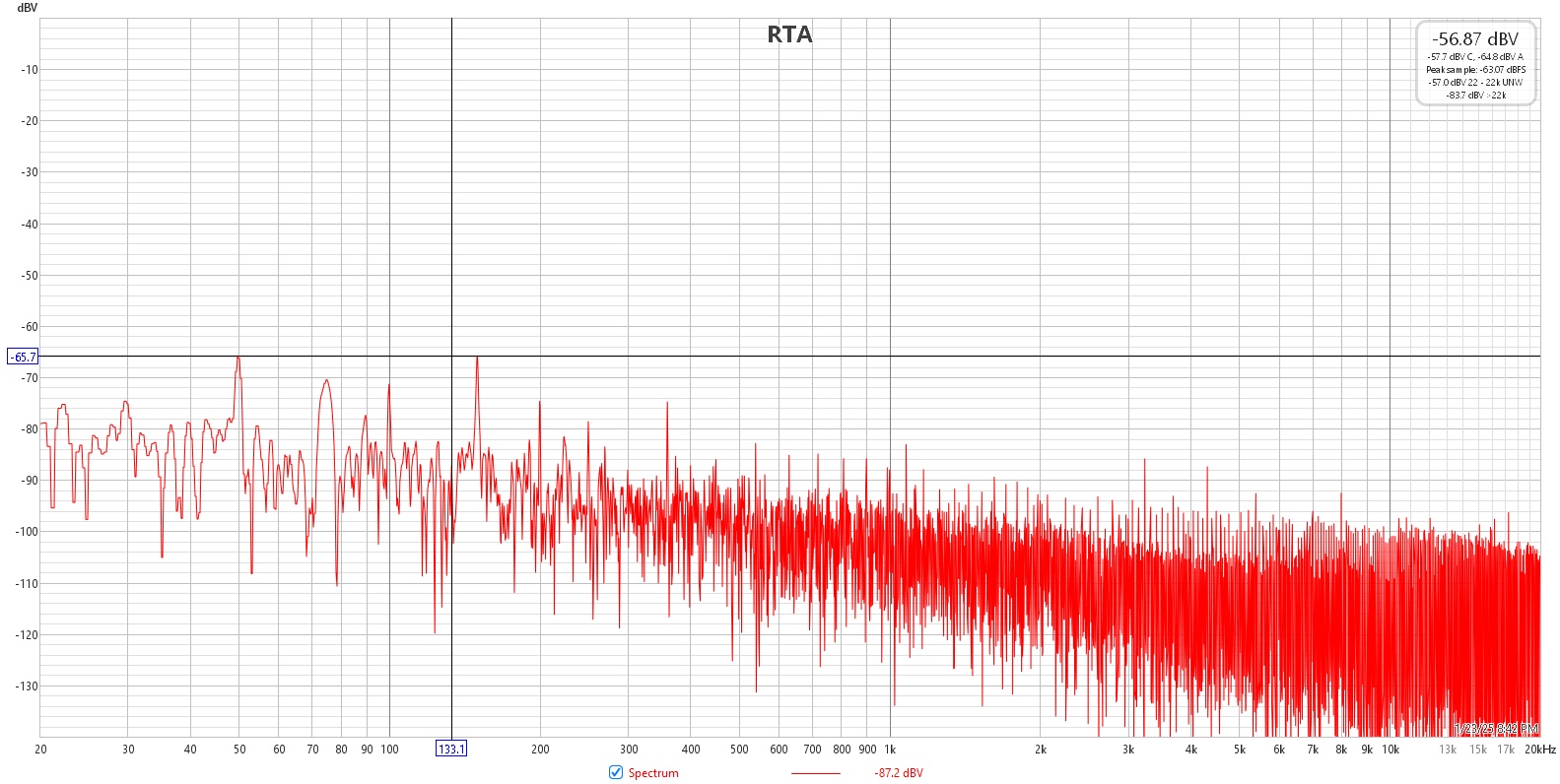

Amplifier noise spectrum, after rewiring and mods, left channel:
Mains hum and buzz are down by some 40+ dB. In fact, what remains in the plot is measurement system hum residue. I think this qualifies as an improvement.
Mods list:
This is fresh out of the soldering work - I will post some measurements and maybe a listening comment or two.

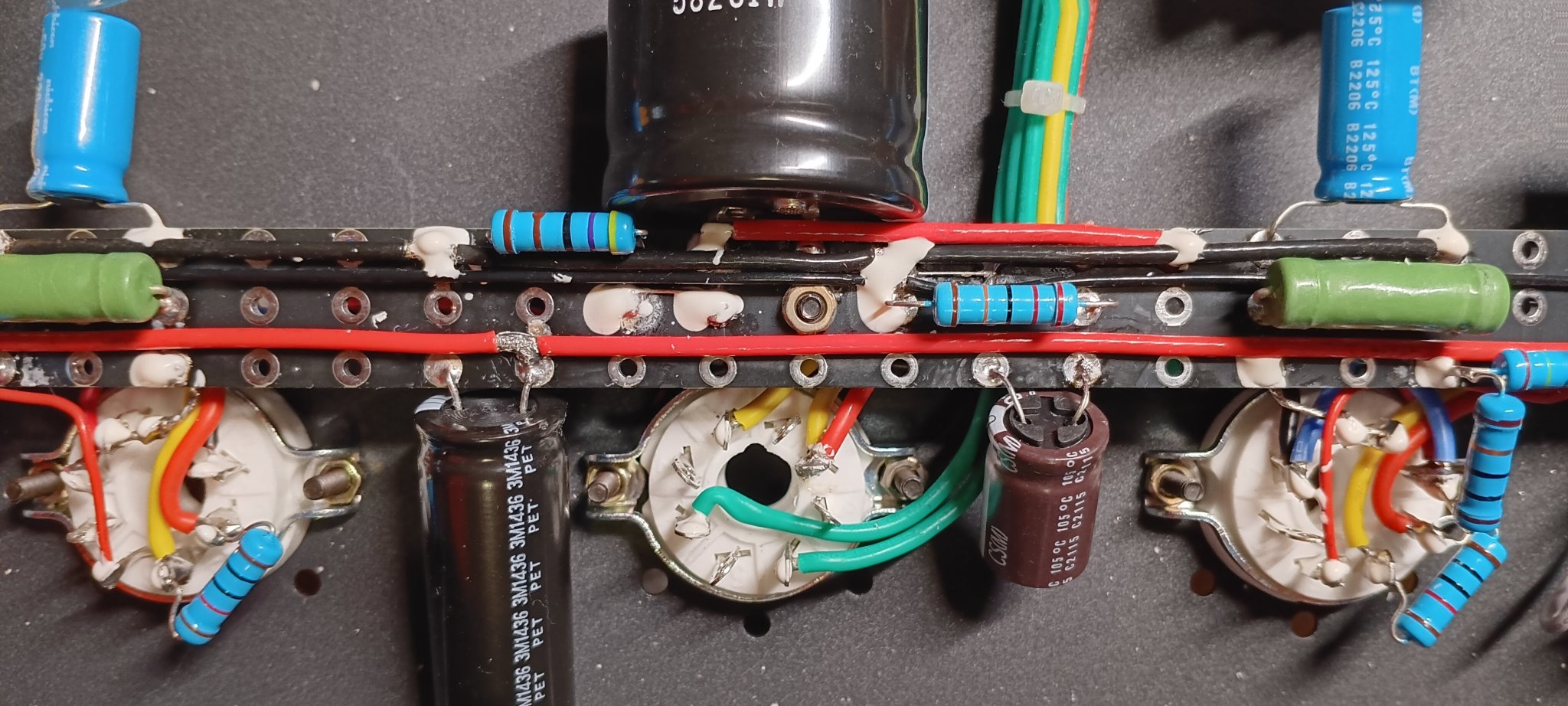

- Rewired everything from the ground up - all components were first removed, the strip board and horrible silicone cleaned. Heater wiring is tightly twisted. The seriously messed up factory grounding scheme was fixed.
- Changed o/p stage to pseudo-triode mode
- Fixed the ill-conceived operating points of both 6SN7 sections by increasing the idle current to 4mA and redefining the anode voltages
- Removed the ill-conceived upper tube anode / lower tube cathode connection of the cascode grid voltage divider. Absolutely no benefit from it in simulations.
- Increased B+ via extra 2x15V transformer - needs 2x35V and possibly higher voltage B+ cap
- Added grid stoppers
- Removed feedback
- Designed for an overall gain of ~23dB
- Improved component quality
- Split B+ RC filters towards 6SN7s per channel
- Heatshrink now protects transformed wiring from chassis entrance holes
- Created a virtual center tap to reference to ground the EL34 filaments

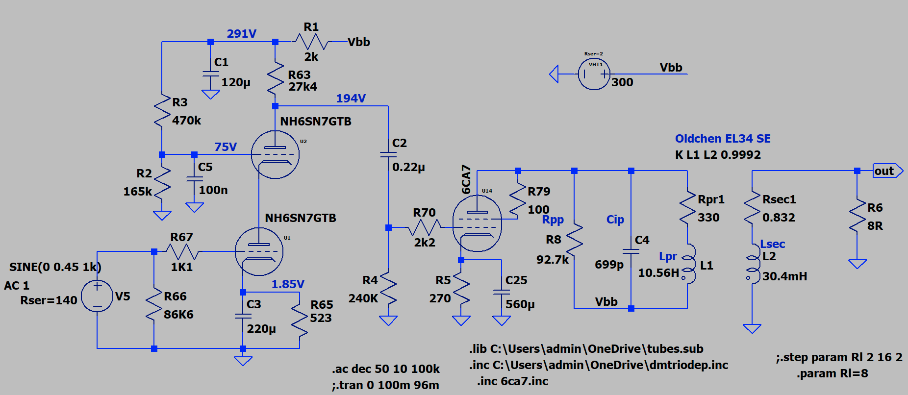

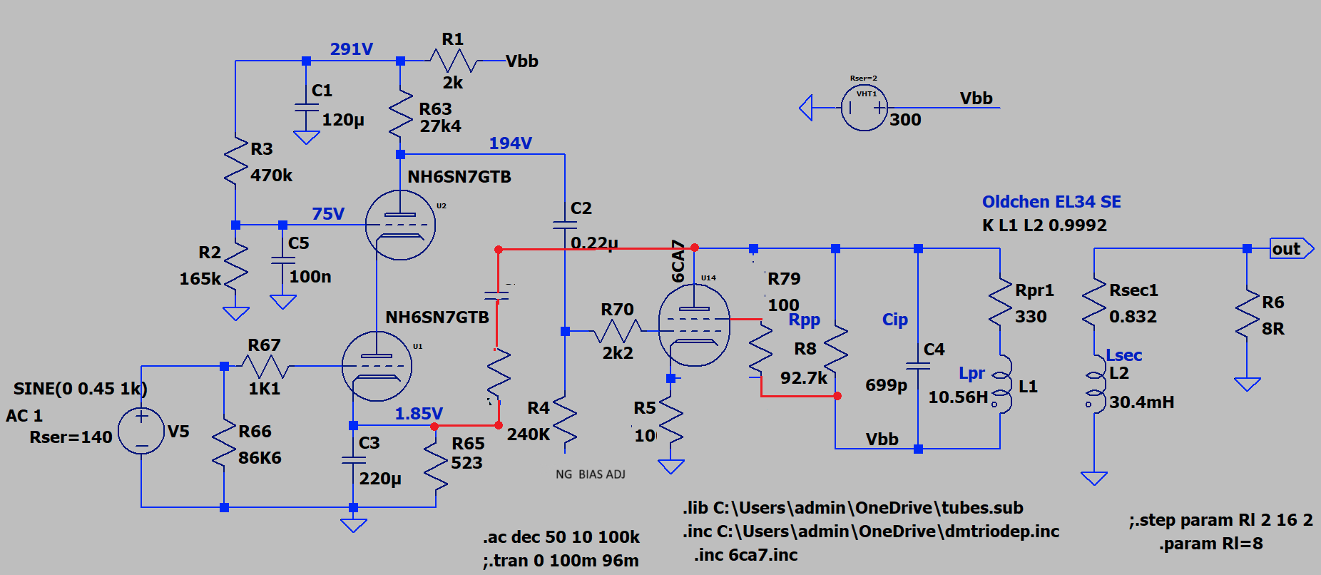

@hollow_man For points 2 and 3: Did you keep the cascode driver cicuit? If so, could you post a schematic with the component values you've implemented? My version came with the schematic as in post #1, but I'm thinking of rewiring this.

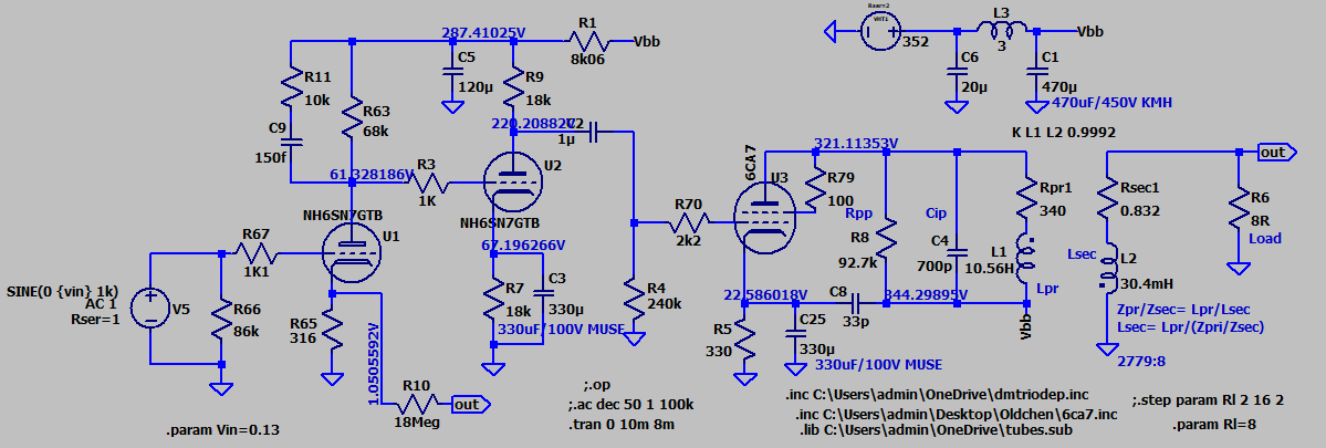

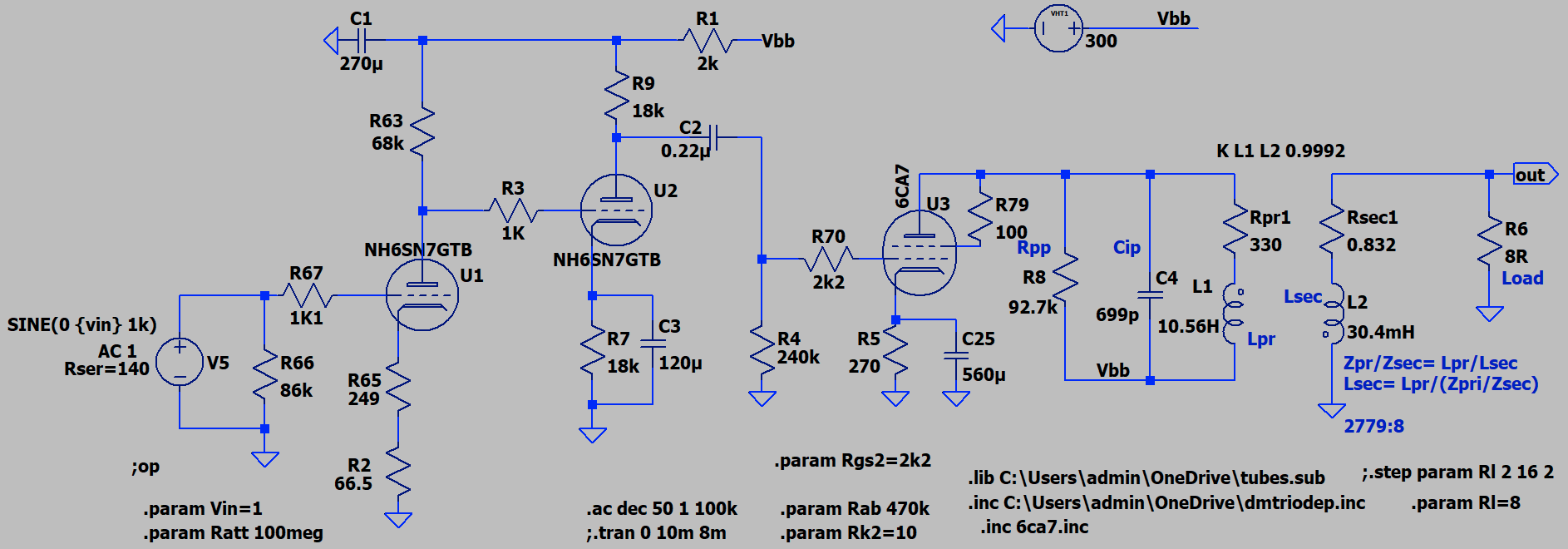

@arjen6t8 here is the modded schematic:
However, I have now changed to a classic DC-coupled cascade (not cascode), because I wasn't very impressed with the cascode sound. It is an idea that I haven't seen to be practiced by high-end tube manufacturers - at least those whose sound signature I like, like Canary Audio, Octave, etc.
If you think about it, who gets a very happy sounding 6NS7 to try to mimic a pentode with it?
Frankly, don't waste your time with the pseudo-pentode bussiness IMHO. I would call it unlistenable. This one sounds vastly superior straight out of the box:
It even has more gain than the pathetic factory implementation for those who want to experiment with feedback 🙂

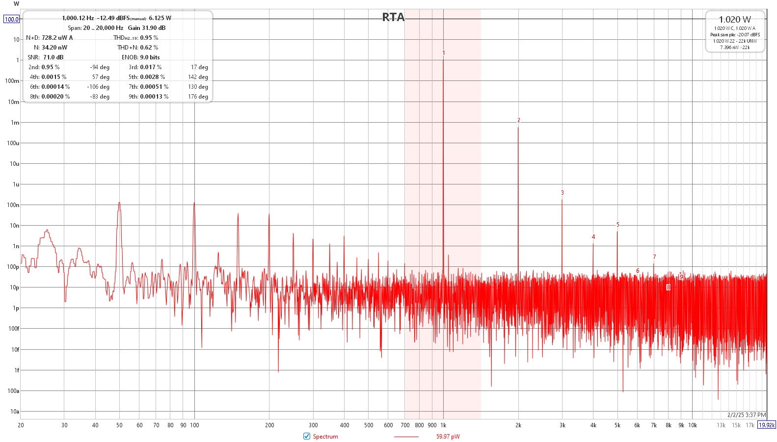

Here's the distortion: It really needs a higher B+ though:

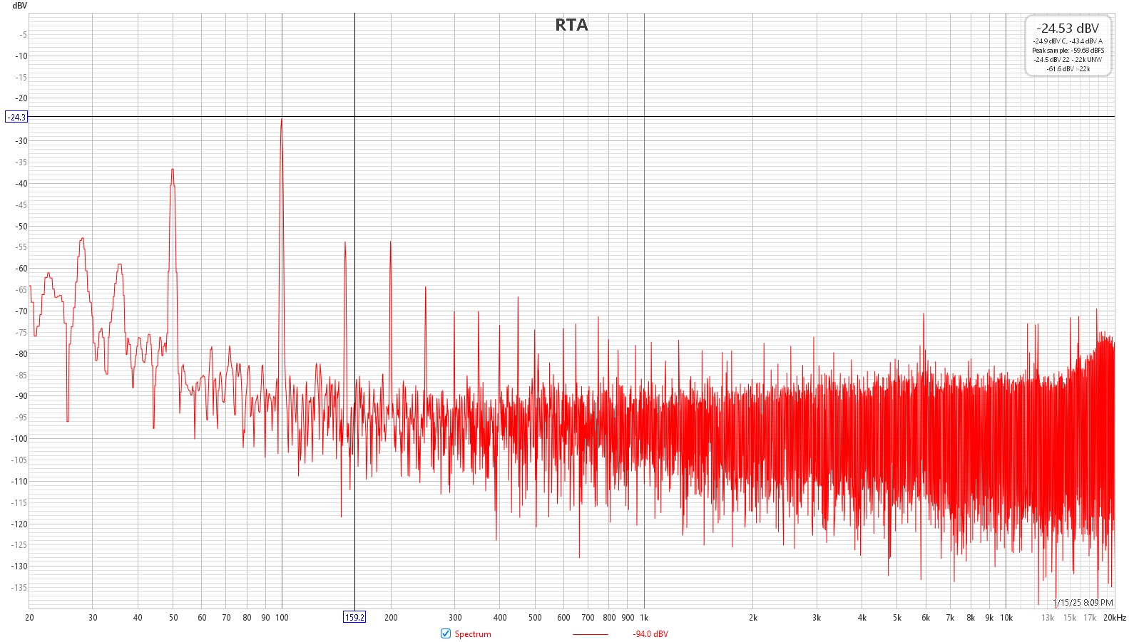

1W noise and distortion spectra:

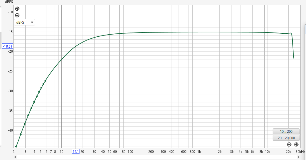

Frequency response into 8R:
-3dB @ 16.1Hz, upper corner limited by antialias filter.

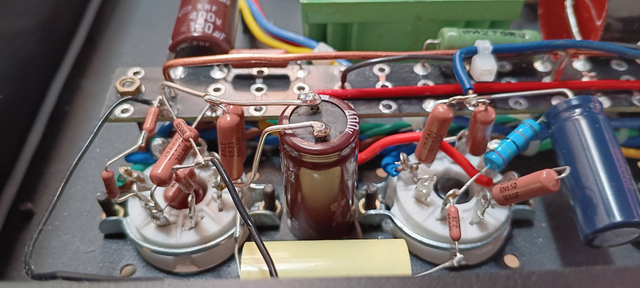

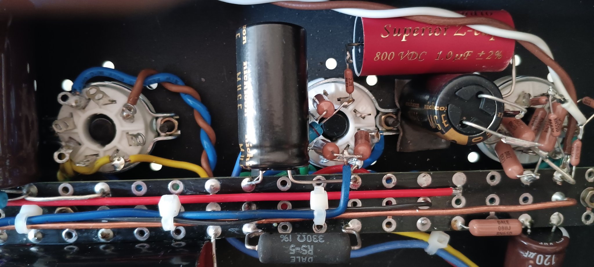

Couple of pictures:
The two 100R resistors create the virtual center tap to reference the EL34 filaments to ground. The cathode would also be another possible reference point.
The copper bar can also be seen. Grounds are star-connected per tube. So is B+.
The second triode section grid stopper filts nicely closest to the socket.
I had a foil cap for coupling and used that, but something better would be nice. The cathode bypasses also need better parts.
I have some real NOS 6SN7s, but I am not getting into tube rolling until I get it to sing first. Also, the feedback/no FB trial will be the last one.
Next is increasing B+ so that some more power can be had, altough I am happy with the 3-4W watts I currenty get from it.

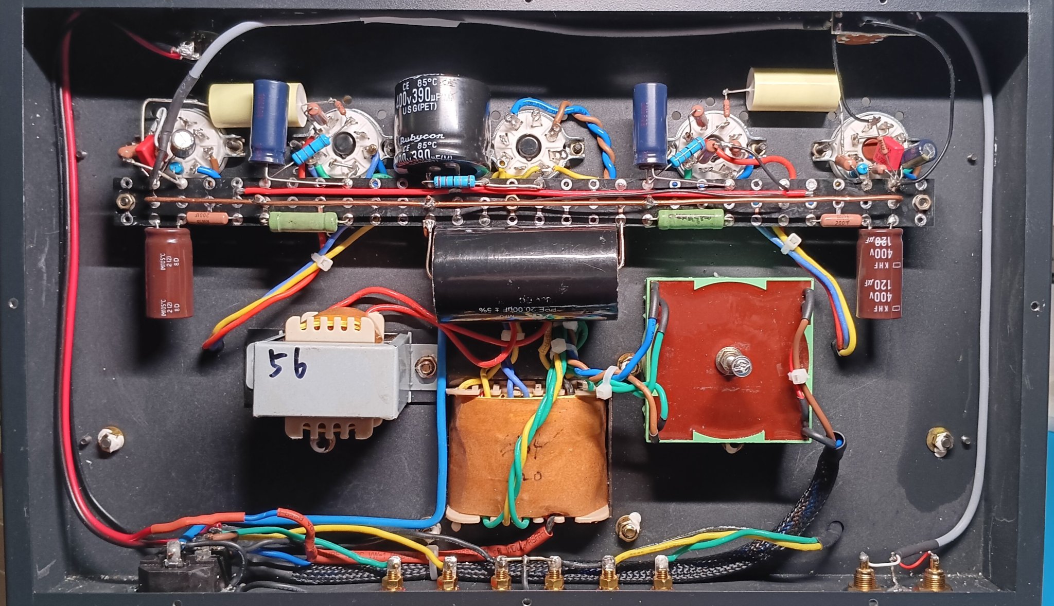

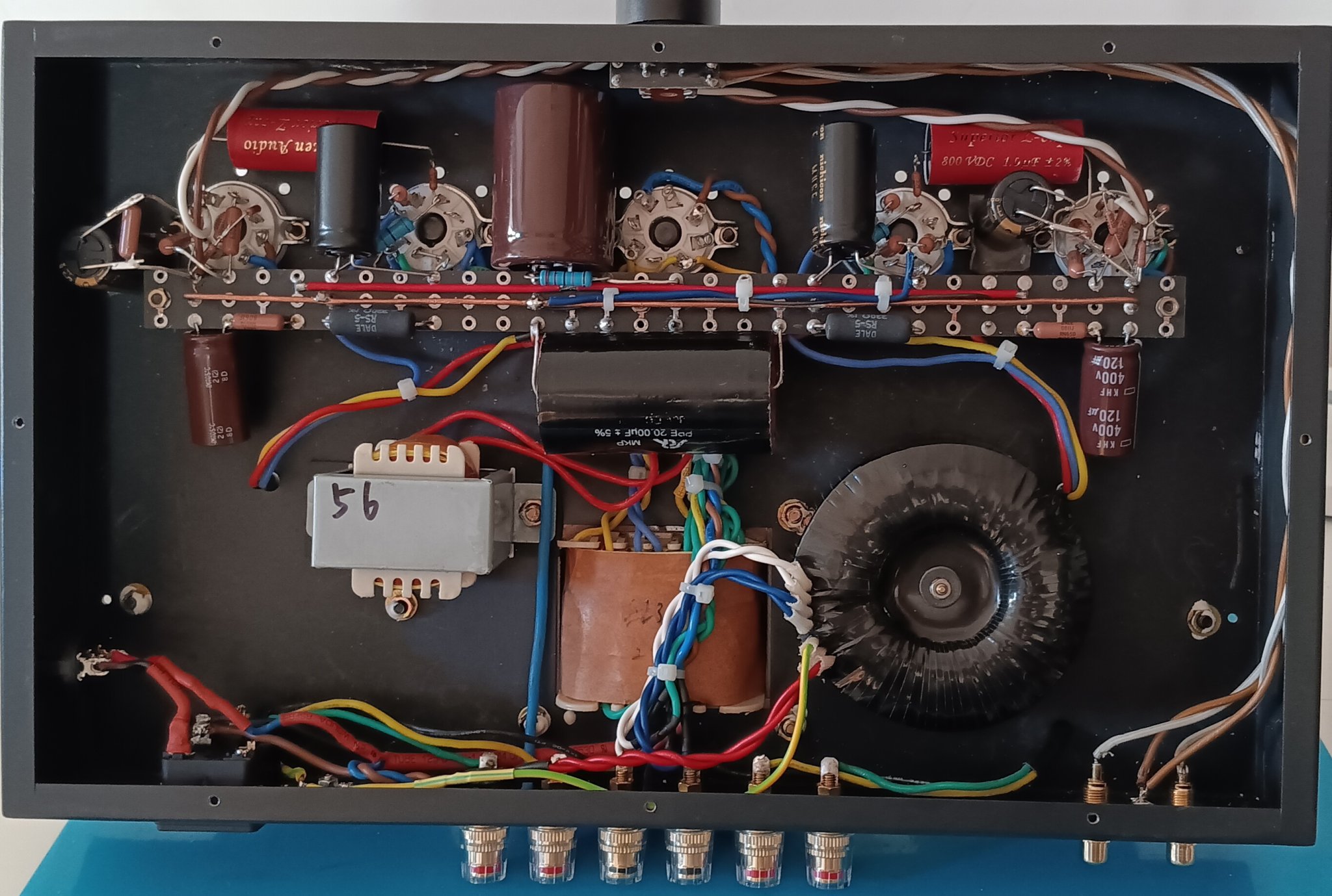

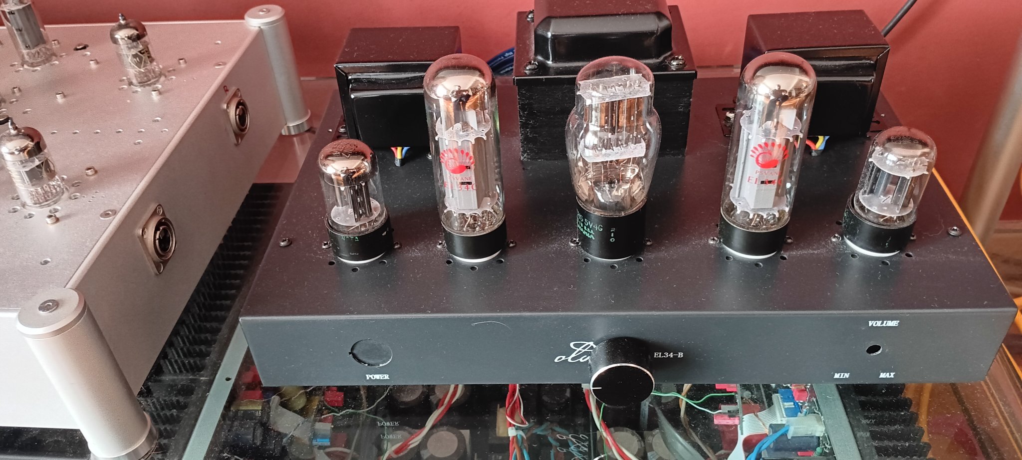

I am finished with the bulk of the "changes". A picture first and then a summary:
(To the left my push-pull triode-strapped EL84 amp). Sorry Oldchen for your logo but that was no place to print it.
Measured voltages are very close to those indicated by LTSpice.
The 8K06 B+ isolating resistor needs to be that high otherwise the two stages interact at low frequencies where the RC network does not isolate enough.
The lead network is a placeholder for when the FB experiment will be made (if ever). The cap strating value should be 150p in that case. Same goes for the feedback resistor which can be 18K for 5.5dB of feedback.

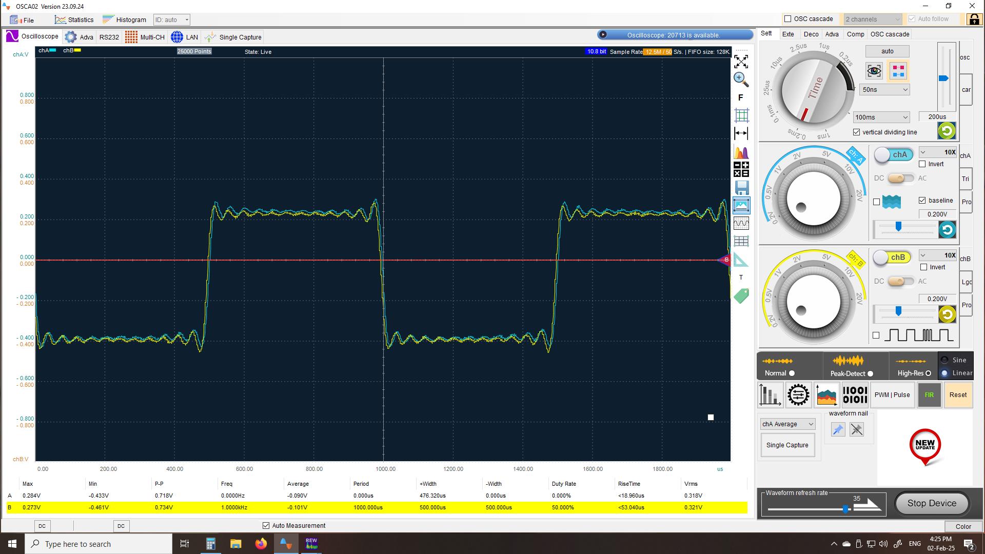

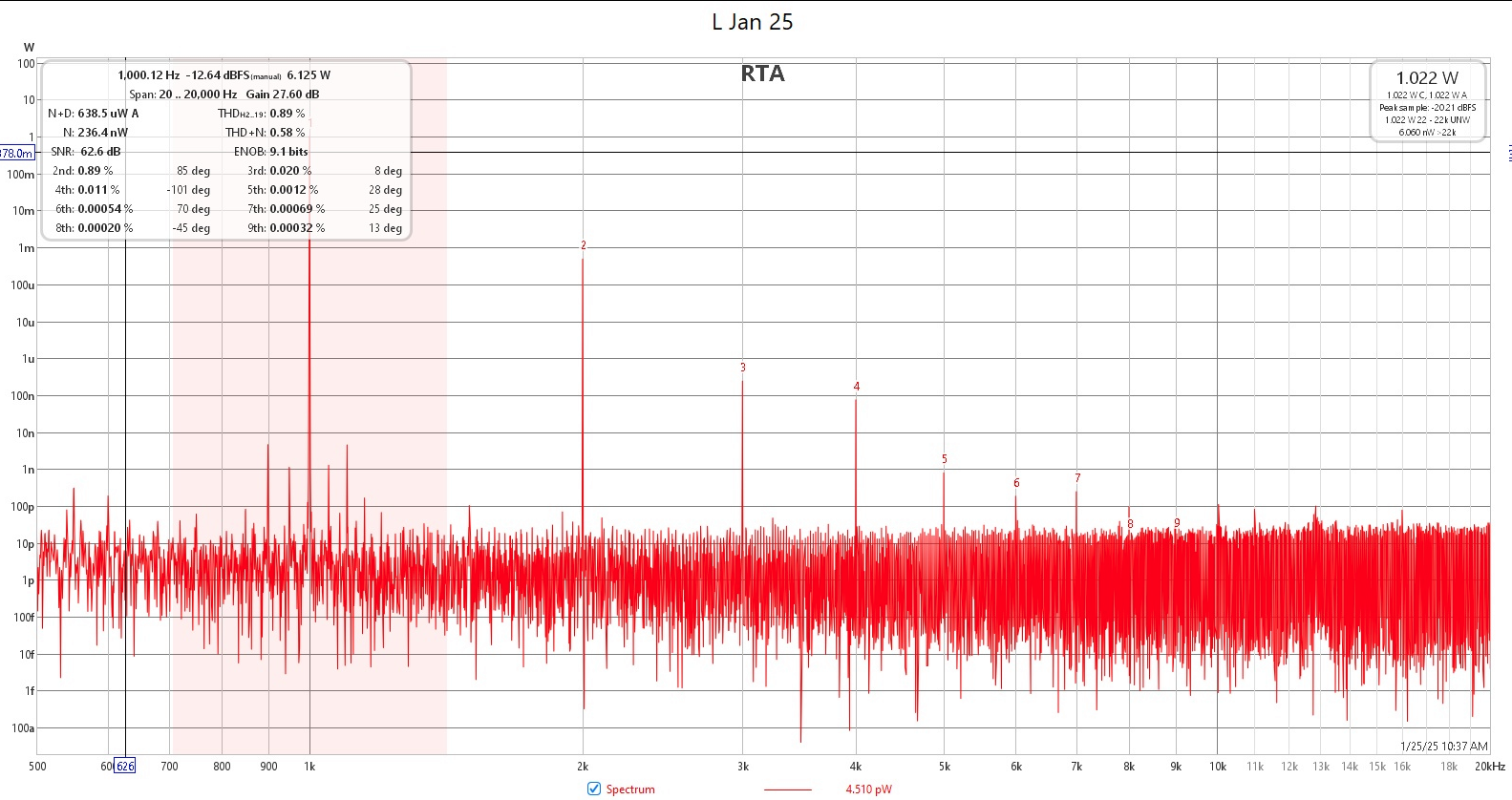

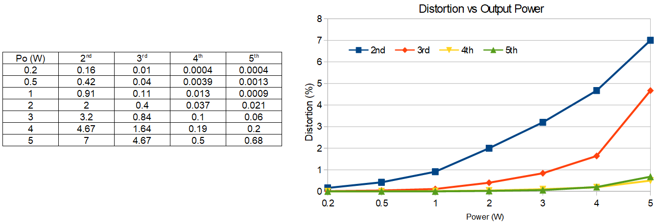

Output power is plenty enough for me. Measured distortion is:
Also, mains hum is all but obliterated. What is shown here is a measurement artifact. No need for DC on the filaments.
3dB 1W power bandwidth is 8.5Hz to 43KHz.

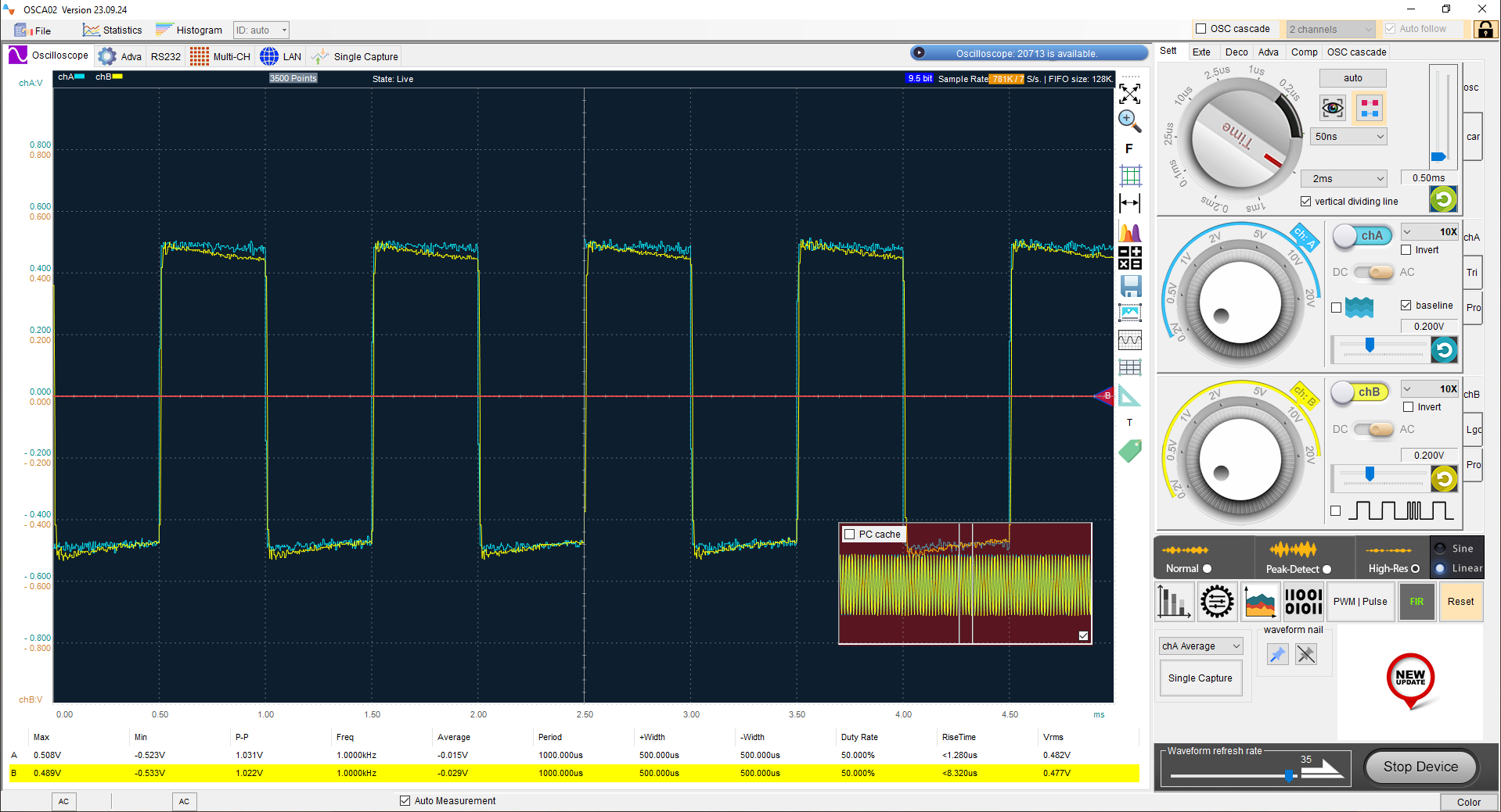

Yellow and blue traces are input vs output 1KHz signal. Can you tell which one is which?😉
And yes, it sounds fantastic by any high-end standard (to me), and no, the sound bears no resemblance whatsoever to that of the factory unit.
- The black toroid is a 2x45V one. This coupled with a change of the stock 5U4G to a Sylvania 5V4G increase B+ from 300V to 350V, where I want it to be. This makes for an anode voltage (after the cathode voltage drop) of 300V. The rectifier filament voltage is also happier now at 5.02V from 4.6V, as the 5V4 draws 1A less.
- The cathode resistors are 330R for the same idle current of ~65mA.
- The big electrolytic is replaced with a Nippon KMH 470uF/450V. During warming up the maximum voltage across it rises to ~420V before reaching the steady state value of 350V.
- Power switch moved in the sensible location away from the 6SN7.
- Coupling caps changed to 1uF Jantzen parts. I am not worrying about motorboating as I am not applying feedback (yet).
- Last to go was the bad input signal wiring with the ground mistake. Replaced by VDH twisted pair silver-plated wires. This removed the persistent ~40% veil that was always there before.
- Cathode bypass caps now are both 330u/100V Nichicon MUSE caps.
- 6SN7s are some NOS Philips ECG 6SN7s I had. Yes, they did improve the sound significantly.
- The o/p transformer leads are reversed, as the is one more inversion now. Easier that swaping the output signal wires.
- Moved the pot to the center of the front panel, as I wanted the two channels wiring to be of equal length. The actual Japanese made pot is not bad, it stays in place even though I have some RK27s lying arround.
- Many other changes and voltages can be seen in the schematic. I used mostly parts that I already had, apart from the KMH, the Muses and the 330R Vishays.
- Double sticky tape comes in handy to hold the parts in place - the toroid is of course fixed with a proper screw.
