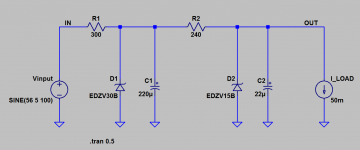

You can get another 30dB (32X) of ripple attenuation if you use two zeners and two resistors for V+ (plus 220uF capacitor), and another two zeners and two resistors for V- (plus 220uF capacitor). It all depends on how ugly you think your +/- 56V supplies are, and how pristine you want your +/- 15V supplies to be.

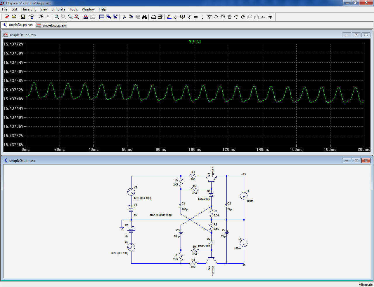

A sensible proposition, at last: dropping voltage with series zeners or similar techniques is generally a lousy idea because it magnifies the instability proportion, and zener droppers tend to change into short-circuit droppers at the first start on a capacitive load.
Opamps are not too picky, and safety + efficiency is probably a more sensible goal than ultimate supply rejection.
A buffered zener provides good enough regulation and ripple rejection, and can survive mishaps with suitably located resistors and suitably absent capacitors at critical places.
This example can be adapted to suit most low power situations: it provides up to 150mA with an Iq of 5mA, and the residual ripple remains low enough, even in the presence of 10Vpp at the input
... the residual ripple remains low enough, even in the presence of 10Vpp at the input

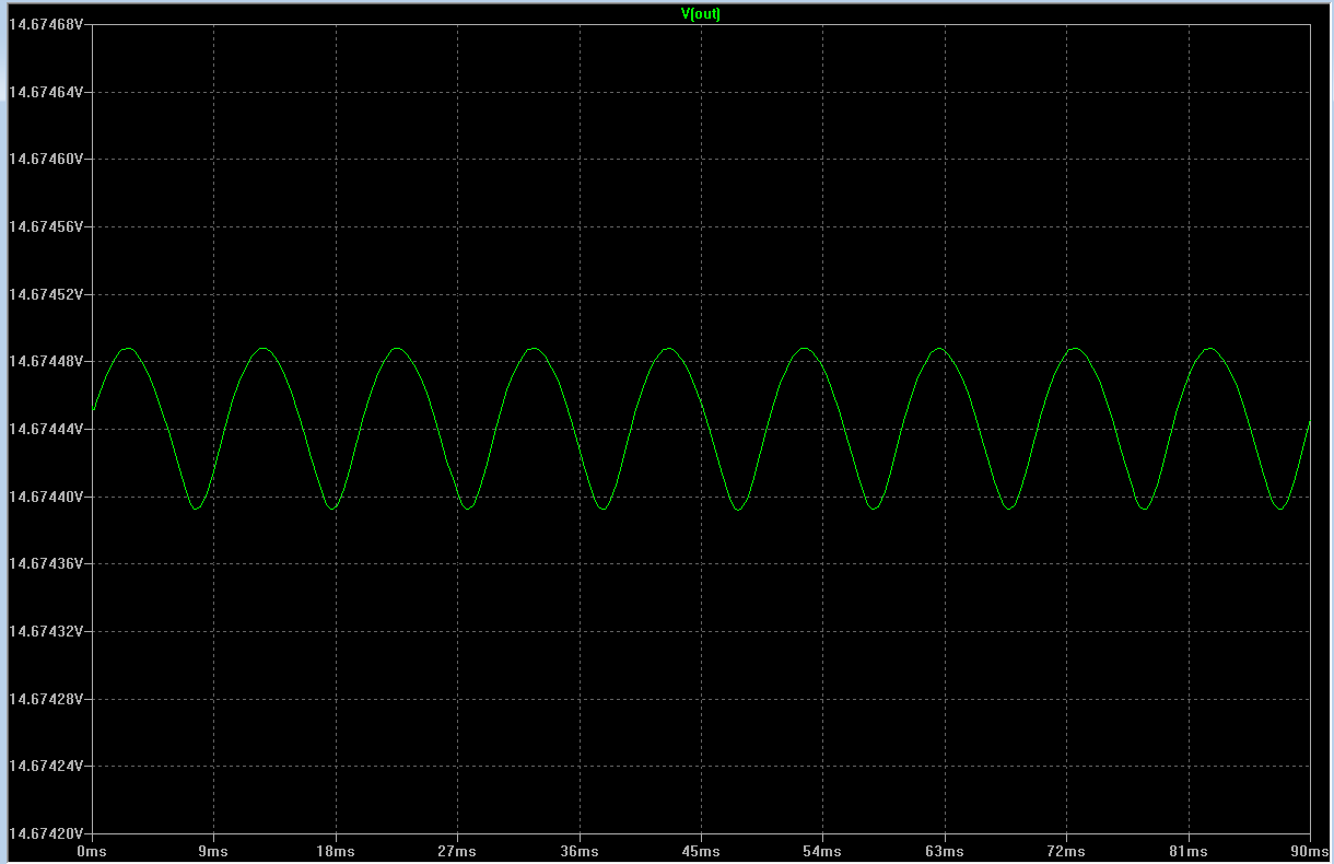

Post #11 waveform appears to have 2 millivolts peak-to-peak ripple.

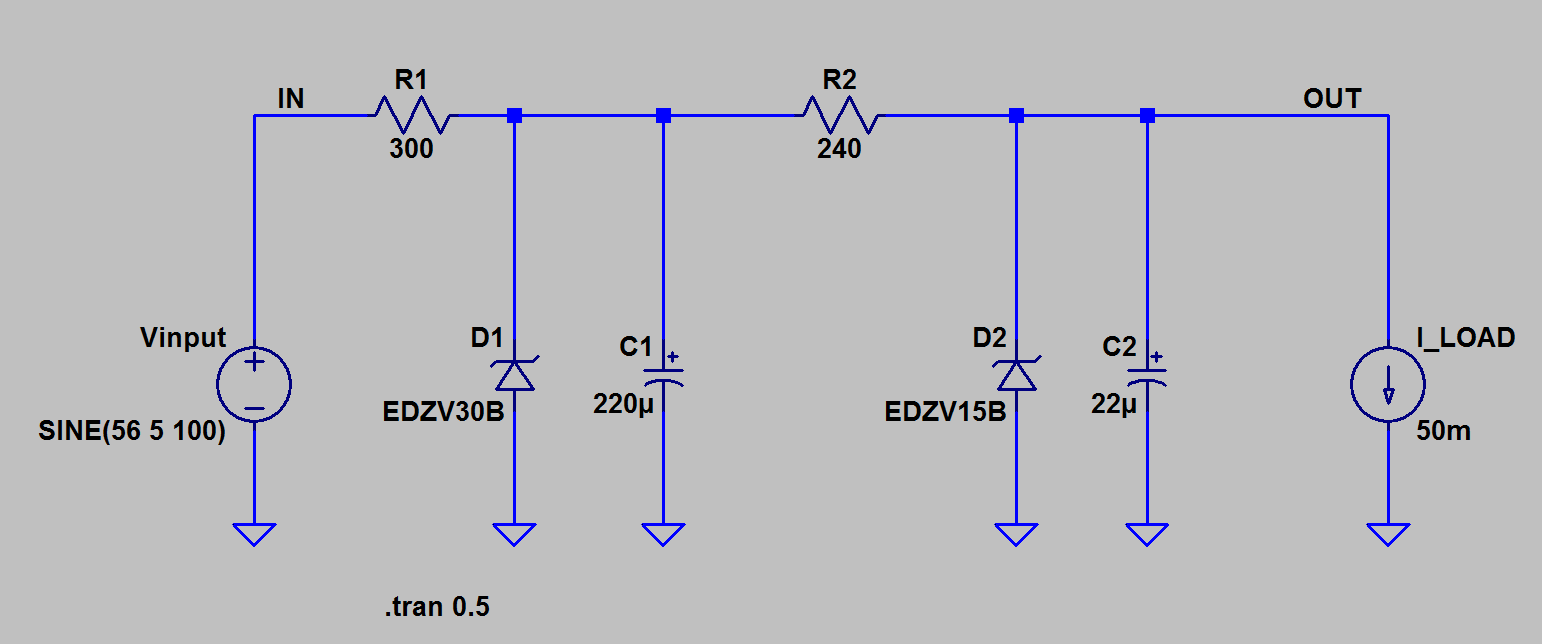

If member flyingtele desires even less, the two zener schematic below gives 0.1 millivolts peak-to-peak ripple with the same 10Vpp input. At the cost of less efficiency / greater quiescent current.
_
