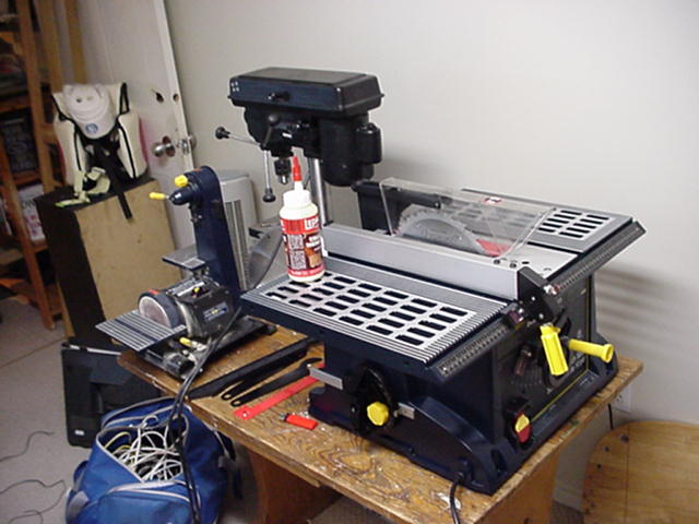

Start looking for a table saw and a jointer if you are going to want to make 45 degree joints. The best way I have found to make a 45 degree joint
One of these
But then you need a router table
