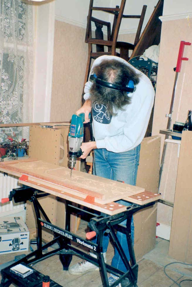

Similarly, I bought a battery drill/screwdriver for screwdriving. I use it a lot, but I would warn you that there's an awful lot of cheap rubbish out there. The only reason I bought the battery drill was that I was making transmission line loudspeakers and knew that there would be panels with perhaps forty screws needing to be tightened before the glue went off. Hand screwdrivers give you blisters on that number of screws, and aren't as fast.
Clamps are invaluable. Clamps combined with a Workmate are even better. If you could clamp everything securely while the glue set you wouldn't need screws.
Buy proper tools from real tool shops, not cheap rubbish from a market. Cheap tools will waste your time and your money (both in the tools and the materials wasted). It's far better to have a few good tools than a copious selection of rubbish.
