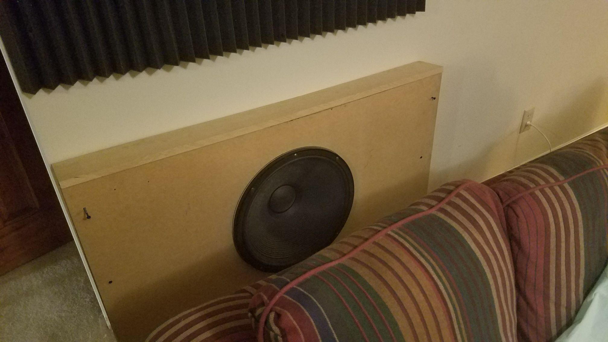

This is going to be ridiculously east to implement. I'm going to use the baffle I made for my fireplace sub and add three sides the width of the woofer depth, 7 inches. My carpeted cement slab will work fine for the bottom. This gets placed up against the wall right behind the couch. There is a very large under stair closet behind the couch, so I will vent the backwave into the closet with hundreds of 1/4" holes into the closet. Voila! Instant near field infinite baffle sub.
Unless your hundreds of holes are equal or greater than the JBL 2245H diaphragm area (Sd) they will act as a ducted port equal to the combined area of the drill holes.
Cutting a speaker (or greater) size hole would take a lot less time than drilling the equivalent area out one 1/4" hole at a time.

H have completed this project (except for the cosmetics). The voicecoil is about 24 inches from my head, at my lower spine height. The crossover is 50Hz LR/4. The "cabinet" is a very large under stair closet. I'm rolling off the mains, VMPS Super Tower III Special Ribbon Edition with double free swinging ribbon tweeters. The extra tweeters helped get balanced sound for listeners of varying heights, a mod suggested by Brian Cheney. I am extremely happy with the results.For movies, I crank the level up 2dB to get some visceral impact.
Agreed. I just cut a 20 x 20 inch square out of the drywall and saved it for when I move, in the off chance that the new owner isn't an audiophile.
