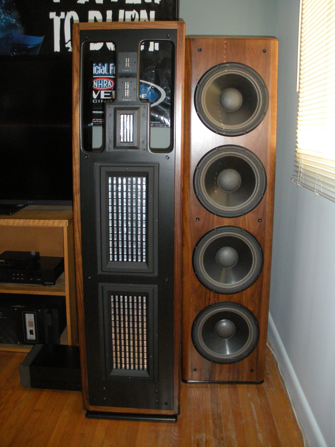

I, on the other hand am a fan of the woofer tower on each side approach (Four 8 inch drivers on each side in a vertical array, closed box, active EQ to make them acoustically relatively flat to 30HZ at the couch). This creates different reflections on the Y axis (floor and ceiling bounce) which increases the probability of nulls getting at least somewhat filled in by the alternate comb filter mechanisms. Each driver will have slightly different null frequencies, so they average out a bit. With the really long wavelengths (20 - 70HZ) this makes little difference, but most of the problems with nulls that I've seen are usually up around 70HZ to 300HZ, where this can make a significant difference. Having the towers be separate from the "satalite" baffles that give you the higher frequencies gives you the ability to optimize further. The higher frequency satalites create the sense of soundstage position, and the woofer towers fill out the bottom with wavelengths that are hard to localize due to their size. I've noticed that several of the high end speaker companies are doing this. McIntosh, Infinity, etc. Here's the IRC Beta speaker for example:
