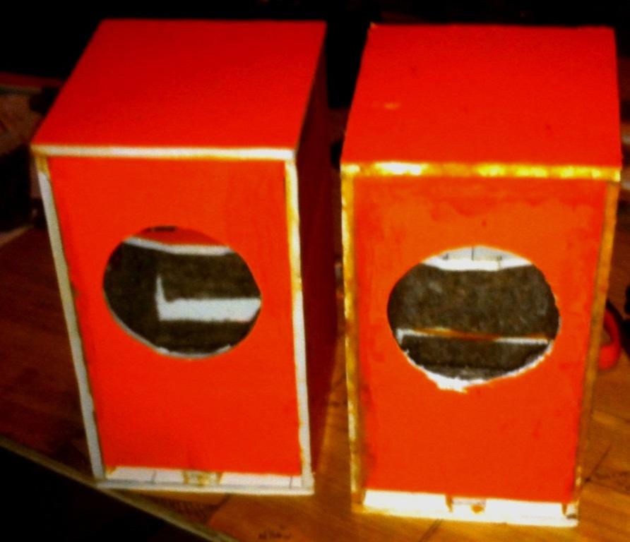

Thanks! They are lined allright...Front, back, top, bottom, and sides. Vents are not obstructed. Made a foam core model, then will build 12 mm baboon plywood cabinets. It was quite a learning experience working with foam core, hadn't done that since my college years (1987 - 1992). Not having a good pulse didn't make for really straight cuts, the first enclosure had some gaps larger than the usual hairline; sealed with epoxy. The second was much better, there are some hairline gaps, but will also seal with epoxy. In order to cover the imperfections I will prime and paint with a stone textured spray paint. Here is a picture of the pair.
