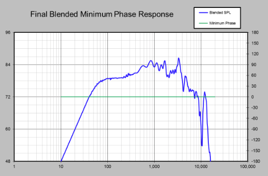

The "old" method would produce this:

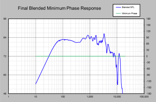

The "new" method would produce that:

The "new" method suggests that the lows need more boost hence there would be more low frequency energy radiated into the room compared to the "old" method.

The after allows a proper crossover to be designed to match the levels, eg no bass boost when completed from an accurate simulation. Example given looks like a good candidate for a 2.5way IMO.
I see what you are saying. (With the new method) you would predict the bass level is lower and compensate by EQing it louder. I was saying that, in the splicing process, and assuming that the upper range was fixed, that you would splice the bass curve at a lower relative level.
