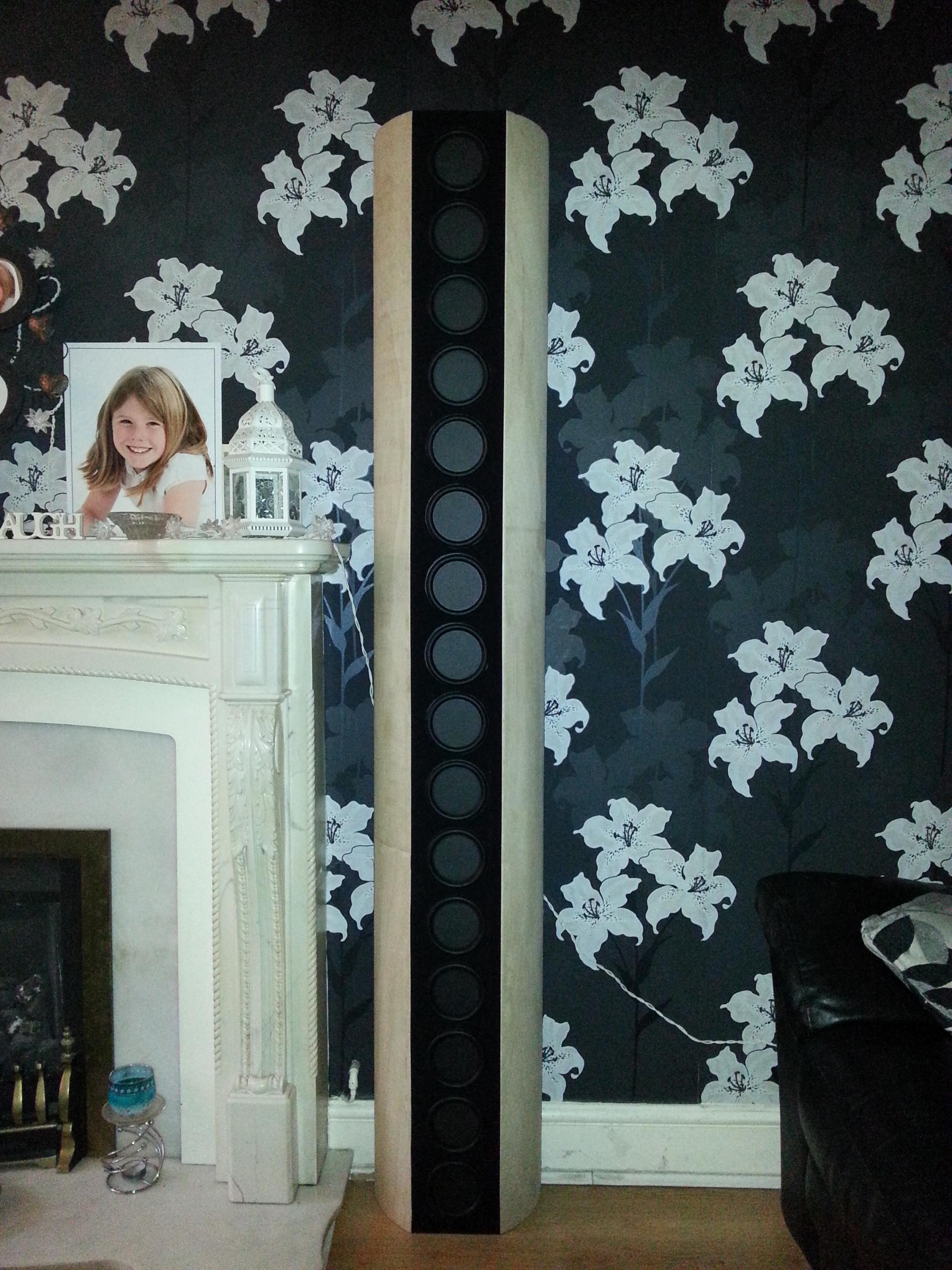

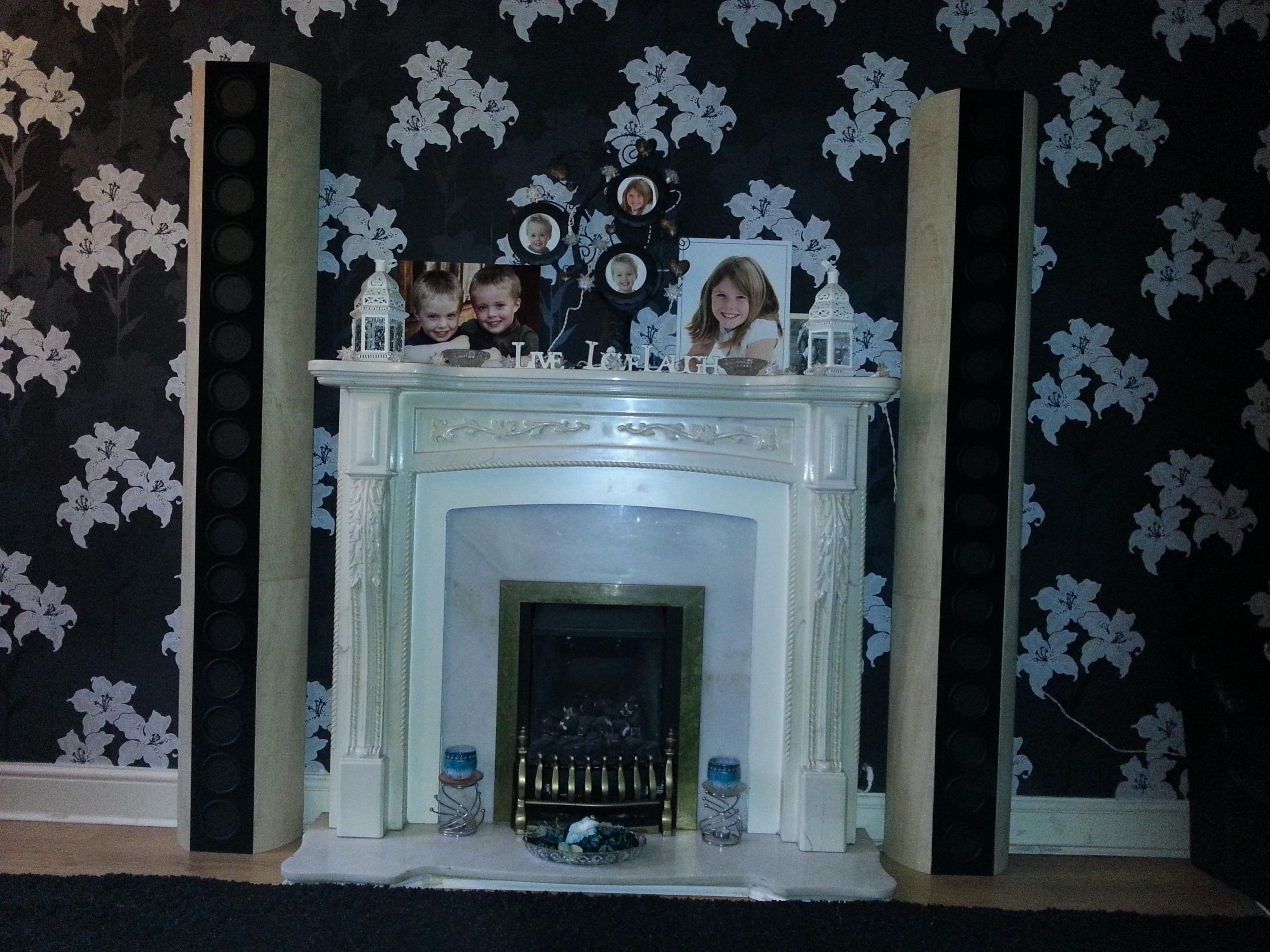

Felt baffle covers on
Overkill's own " Welcome to the Jungle " wallpaper!
I got the felt baffle covers on now, also got nice foamy rubber stuff on the rear panel so the are cushioned for hanging on the wall.
Still to finish the ply wood sides, cant decide between gloss black or gloss white...Got to think of that wallpaper!
Cheers
Derek.
Cheers
Derek.
