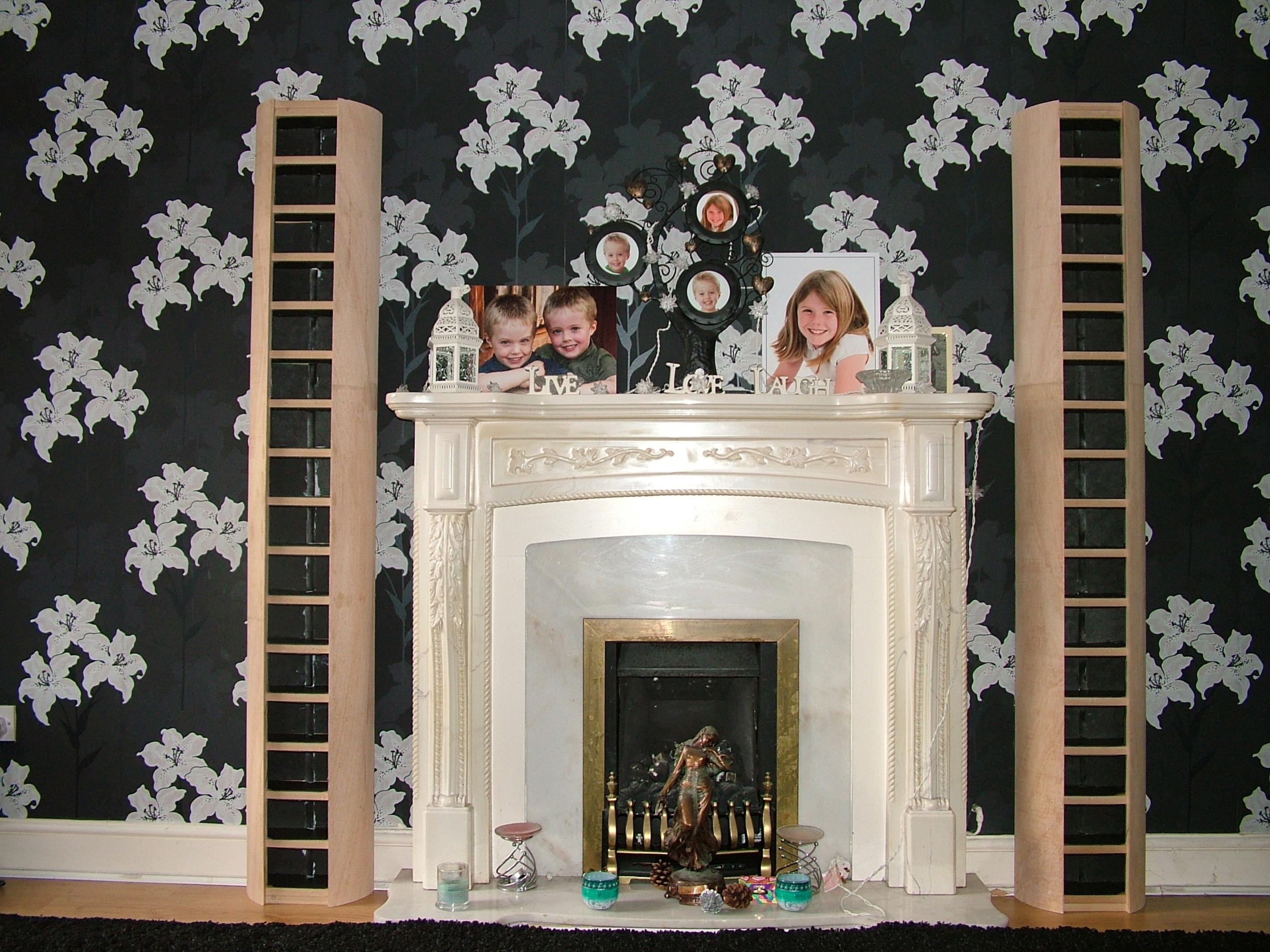

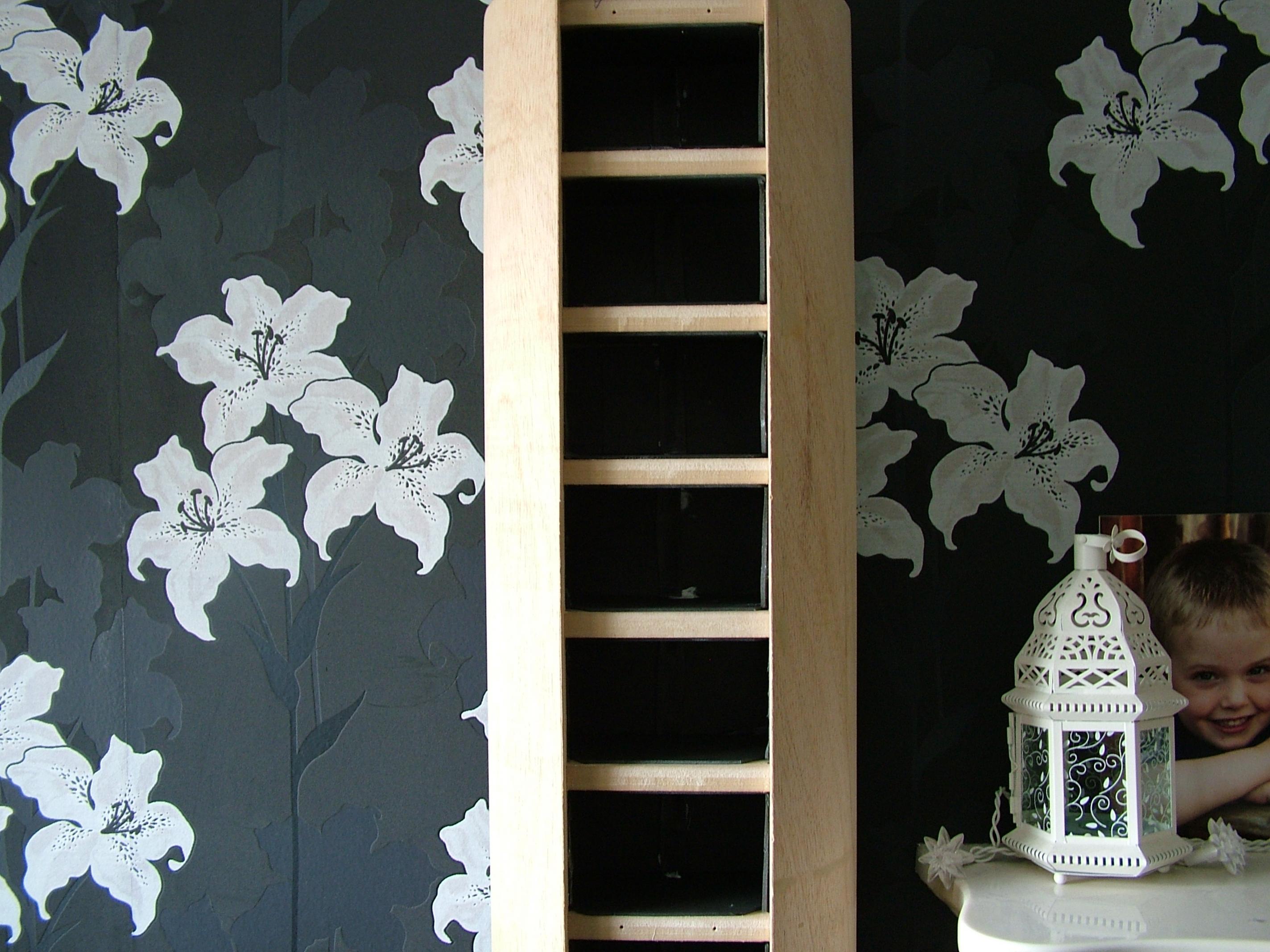

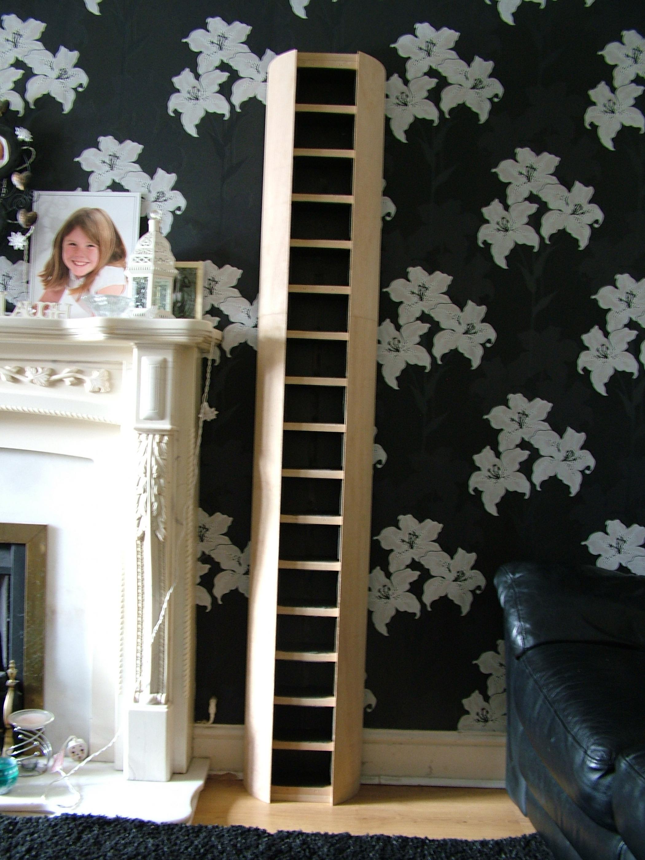

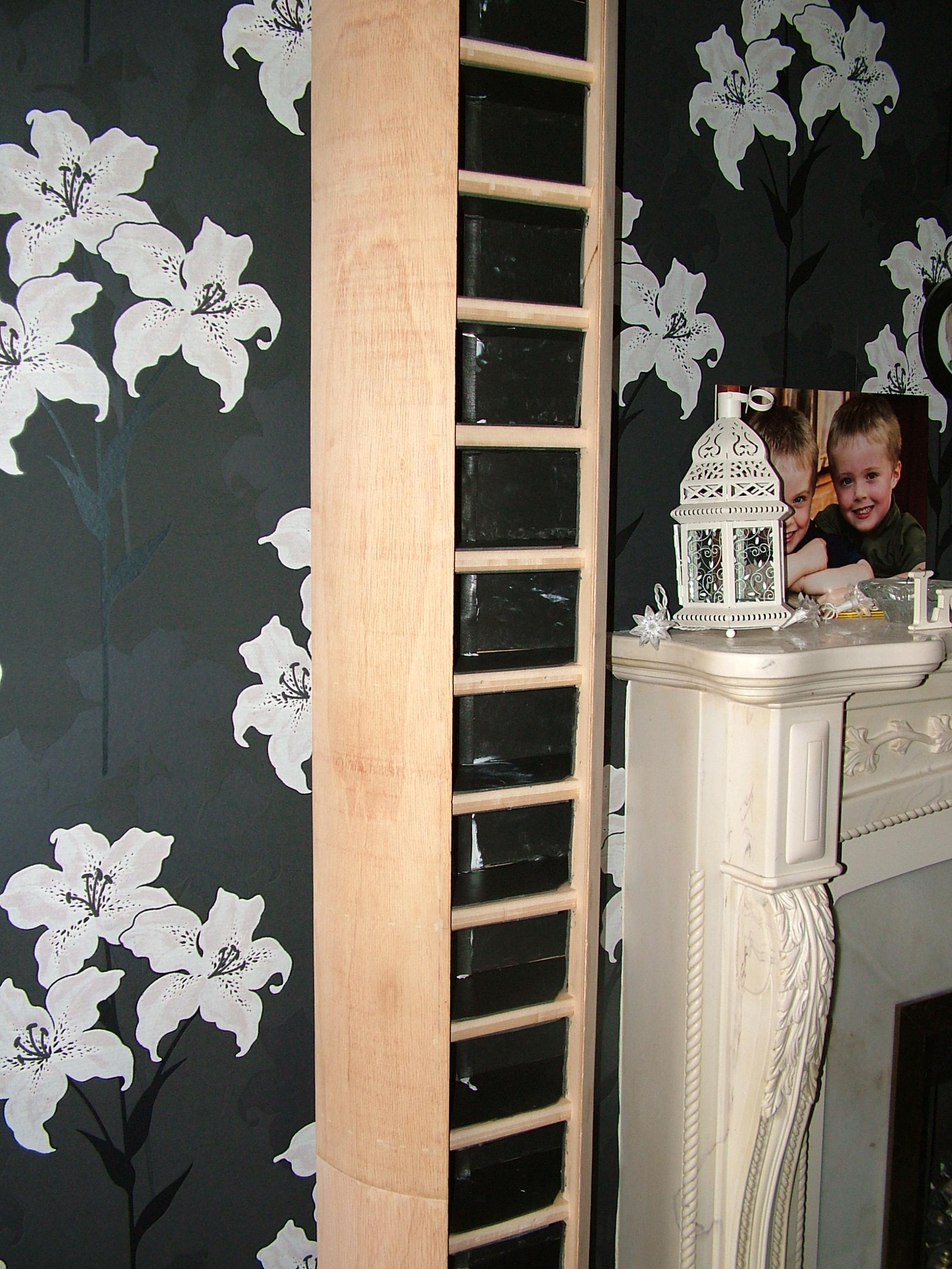

1.85 meter tall, BMR line array
Hi Thomas James,
Yes they would indeed!!

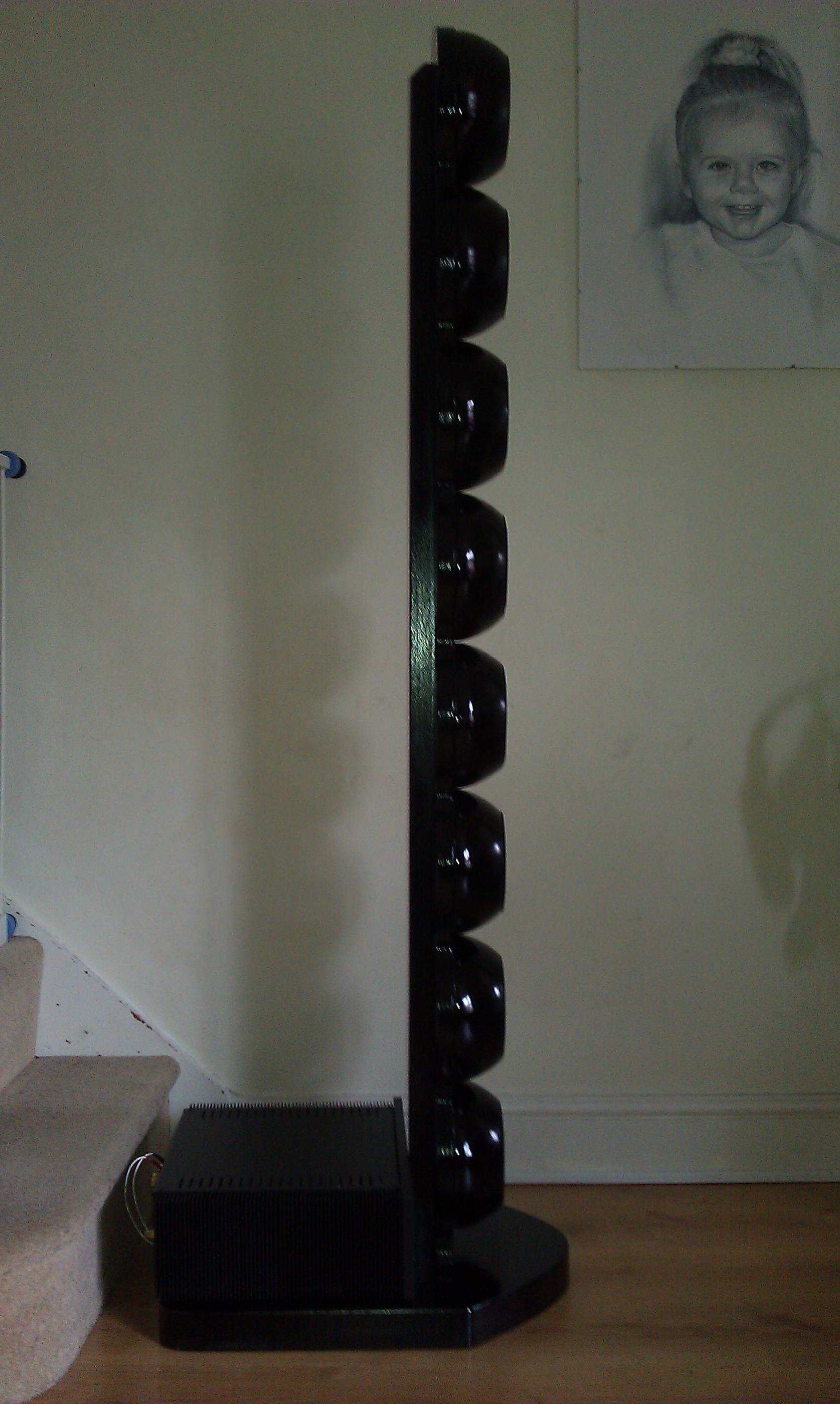

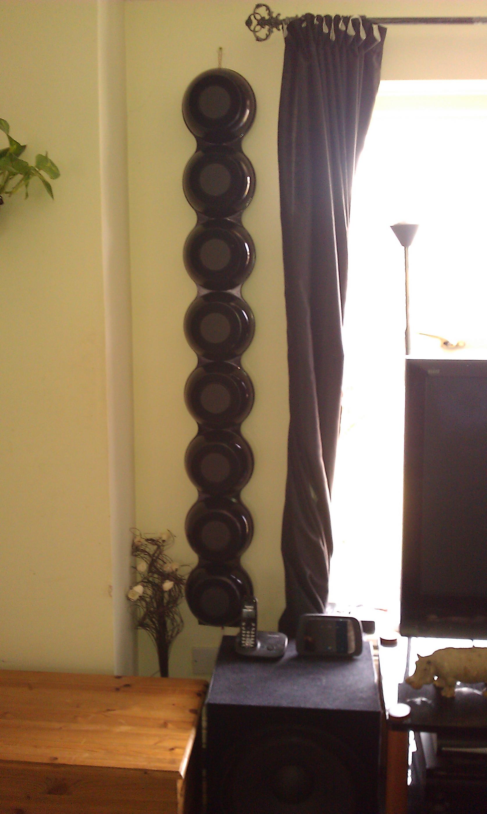

I am working on a 1.85 meter tall, on-wall line array using 16 4 Ohm BMR's per channel, wired in 4 by 4 to give a 4 Ohm load with a genuine 100dB for 1 watt ( 2.83 volts) sensitivity.
If all goes well I am going to offer DIY Kits, I now have the drivers in stock and the first pair of cabinets will be ready soon.
The attached is an array with just 8 BMR's per channel and it is a great performer.
I have demo'd them to various groups of people and they loved them, I also ran them at last months Bristol HiFi show (on the Sunday) with the AVA Media digital amp being fed from my lap top running JRiver 18 with JPlay.
100% positive feedback, including 2 reviewers, one ( print magazine) requested the first UK review if we go into production...
Re your question about DSP and low end, so far I have tested up to 8 drivers per channel.
For critical listening with two channel music, the 8 drivers / ch need a bit of Eq help from the JRiver Eq, not too much, just a 9KHz notch and then some boost above 12KHz and a few dB boost below 70 Hz. I actually use the parametric Eq the most with just a little bit of graphic Eq, its really great and has no sonic penalty as the JRiver software is already running the music.
For Home Cinema you can just run the BMR's flat, no Eq or tweeking, simply add a sub woofer below 90Hz and the system blends beautifully, speech inteligibilty is fantastic.
Once I have the big 16 driver speakers built up I will post some more pics and results. I have not been this enthusiastic about a driver / speaker since 2004 when I first started using the Manger driver....When used in a line array, the 4.5inch Neo magnet BMR is that good.
Cheers
Derek.
