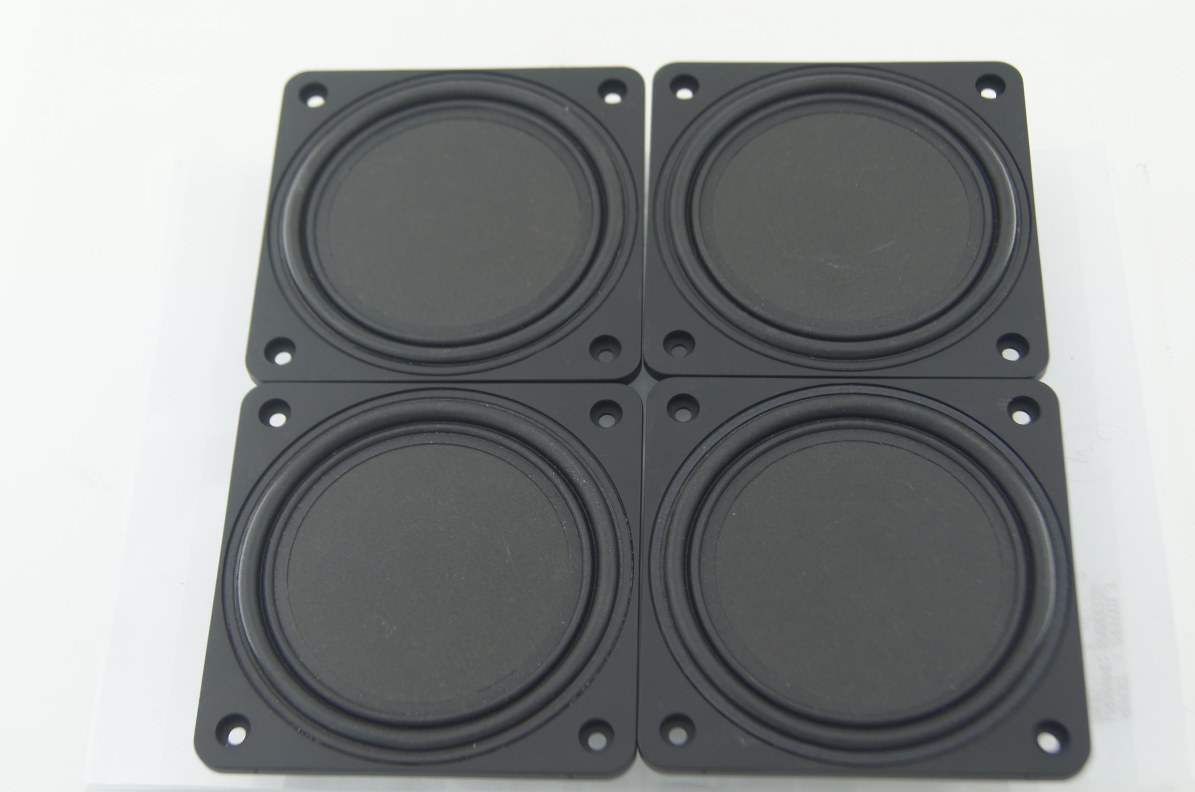

Pic of Silk surround BMR
Hi Jason,
Yes the BMR's do need a very solid cabinet, its surprising just how much energy these little guys produce.
Internal cabinet resonance control and damping are also very important.
I have attached an updated DIY design guide and also a pic of the silk surround BMR driver. This pic is just drivers sitting on a table, not installed in a cabinet.
Cheers
Derek.

Oh,I was zooming in alright 😀
I thought you'd have a cool technical explanation of the surrounds Derek !

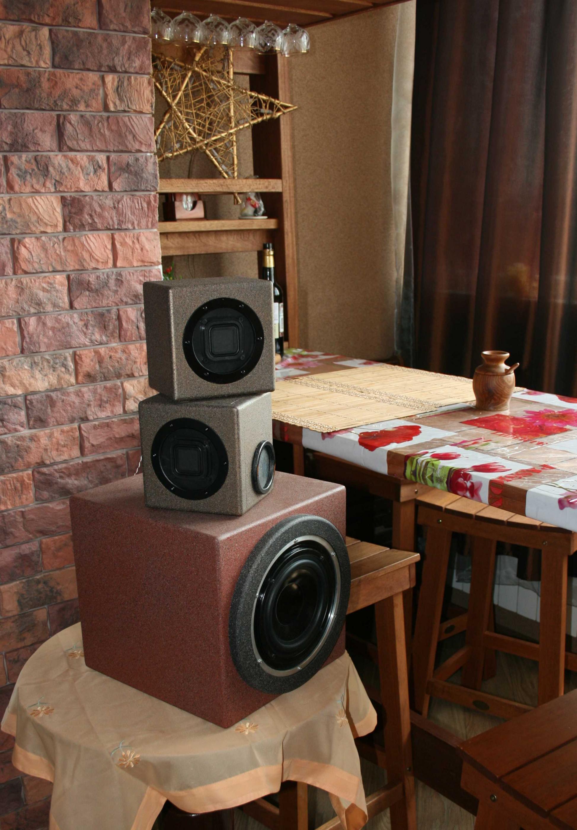

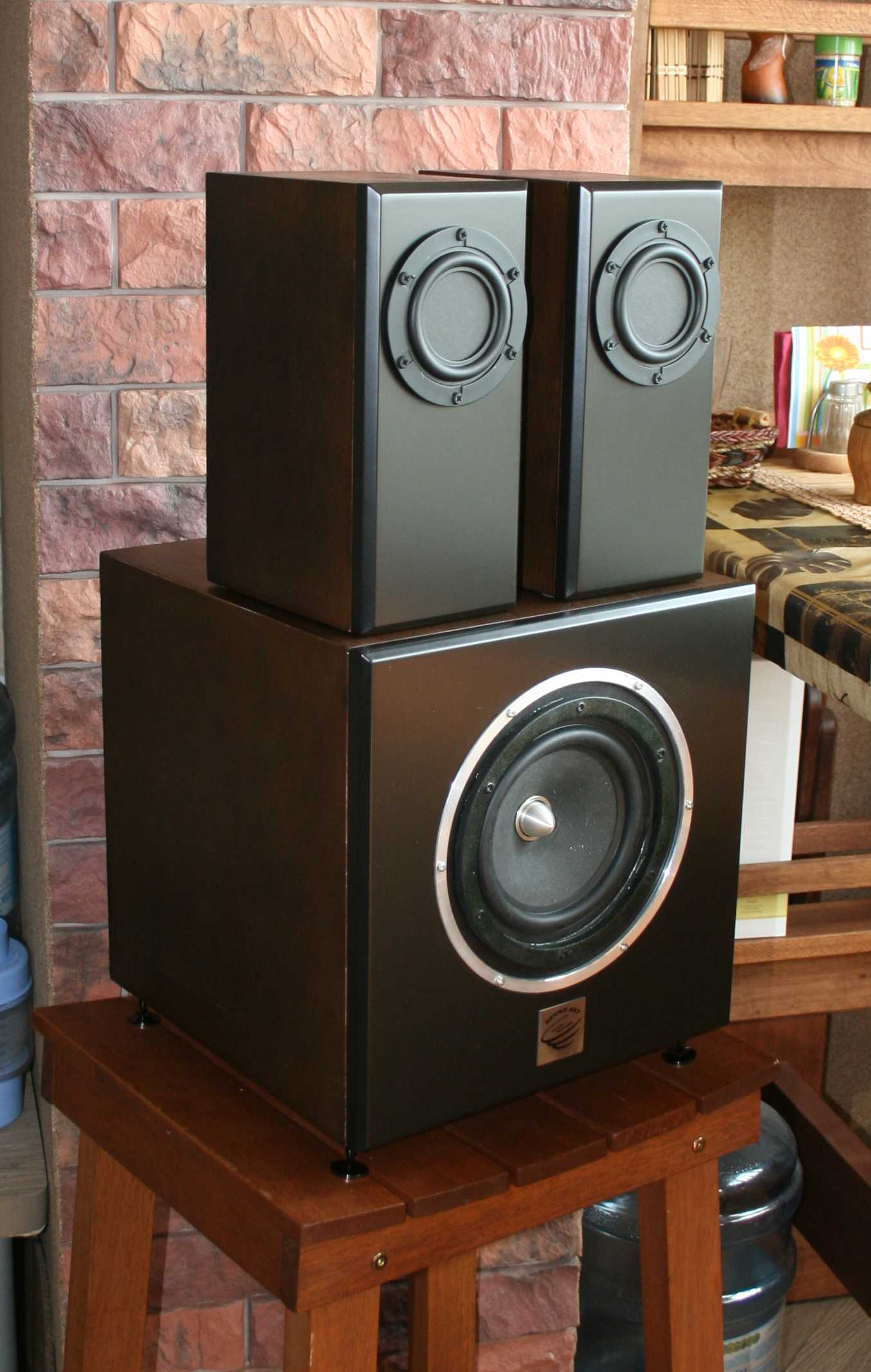

I recently built the BMR trifonic and it turned out to be a great option to get acquainted with the possibilities of Tectonic Elements TEBM65C20F-8 speakers. 3D scene and the microdynamics are impressive!
Those look great. Did you have a build thread for those?
I like the feedback everyone is providing for the silk surround and other drivers that Derek provides. It's unfortunate that those types of drivers are not as widely available.
Thanks guys! This is not my first experience with BMR. I started with Dayton Audio BMT25-4 and immediately appreciated the potential of this technology. Now I have tested Tectonic Elements TEBM65C20F-8. As I sad above my next planned step is line array speakers based on four TEBM65C20F-8 and one TEBM46C20N-4B unit
