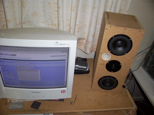

I've had good results with a vented MTM setup with the jaycar response shielded 5 1/4'' and vifa d19 tweeters, pretty smooth response down to 50hz (doesn't shake the room of course, but you can hear it) Used 12db x-overs at around 4k with a zobel network on the mids.

I think usually the reason people put the tweeters at the top is because it is the best place to ensure that the tweeters end up at ear level, which important for imaging. In an MTM config the tweeter should still be at ear level, but the tweeter being between the mids tends to limit high freq reflections off the floor and ceiling, chanelling the high freq straight at the listener.
