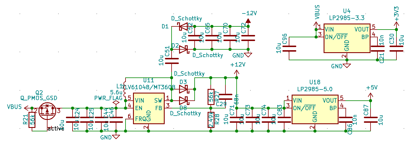

The +/- 12v is always connected, the +12v feeds the 5v LDO for PCM1794 (I don't use VBUS directly).
So those figures show a significant power increase when the NE5534's are plugged in. I suspect, and I'm still analysing, the boost chip can't keep up and becomes inefficient (I've seen this run away condition before with boost). Thing is, the chip is 2A rated minimal and 3A nominal so it should have no problem, and the PCB design is tight with no flaws common to buck/boost design topology.

3. Replaced the boost with a MT3608 which is a cheap equivalent. Exactly same amperage measured. I'm now fairly sure that for some reason the NE5534's are burning more power than advertised in TI datasheet (sleu037.pdf) with no variance on component values. As stated all components are smd and tight with double via's where necessary.

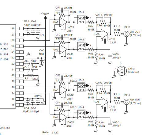

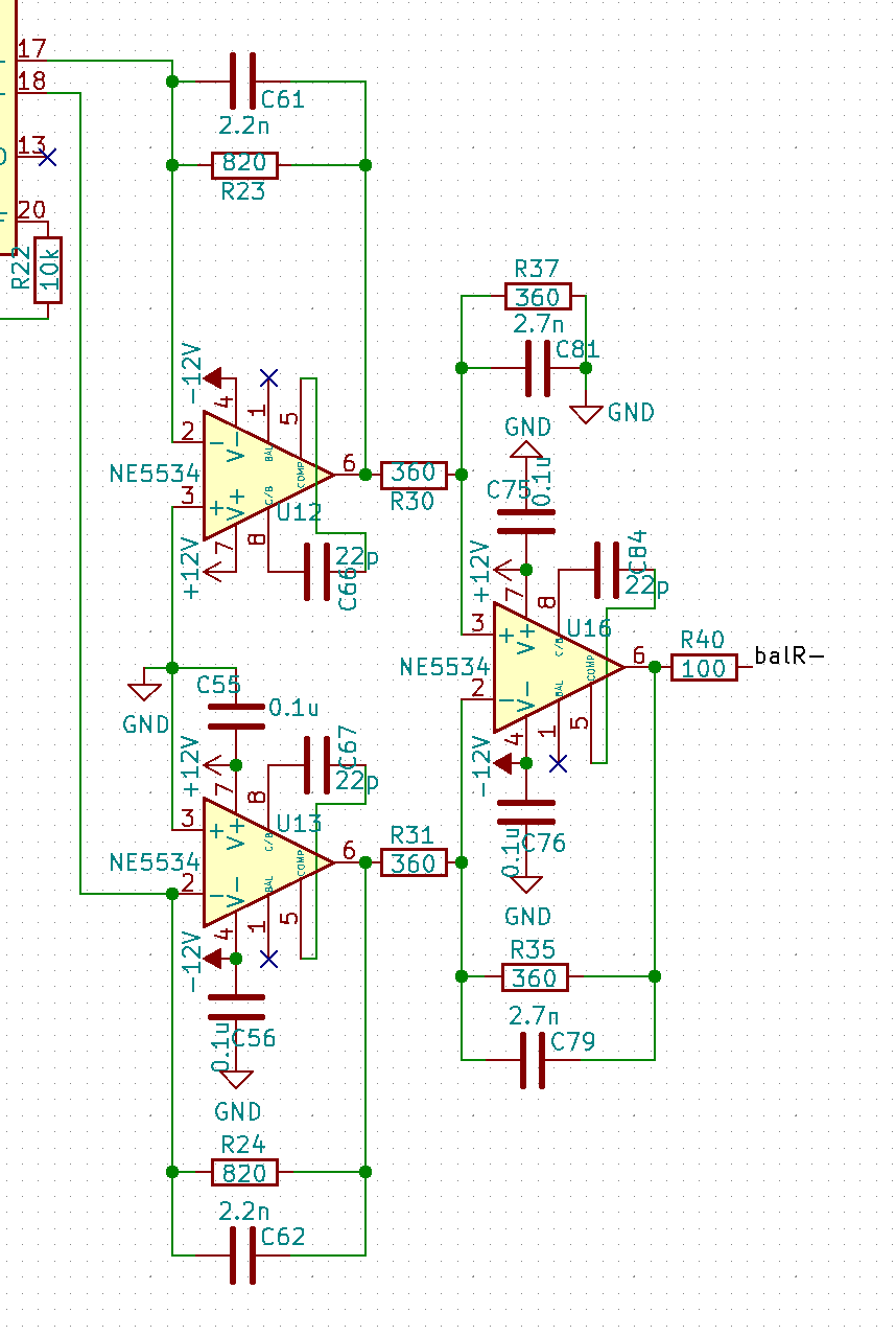

On the NE5534 side, x8 are receiving 0v on pin 2&3 (PCM1794 x2 in mute) and presenting -4.64v on the outputs, or half the expected 9v, to the remaining x4. I believe this is correct. In the schematic posted earlier can see this would draw 6.4mA through 2x360R resistors, 8 times so 52mA loss on top of the 12 x 8mA max. In other words, still I can't explain where the loss is. 🙄

Yes, the PCM1794's is driving both at full outputs (but same polarity) which for the last 4 op-amps gives 0V output. It means the first 8 op-amps are at max output swing (-4.5v).
I think I posted this in another thread already but I can save a lot of power by switching to +/- 7.5v. 4.5v/720R = 6.25mA, I think based on a graph in the datasheett 5534 will be comfortable sinking this running at +/- 7.5v.
Graph shows current output for a 11v signal using 12v power rails. 5534 needs 2V headroom at least, I'm drawing a bit more current hence thinking at least 3V headroom. Even 4.5V headroom (double) is a good power saving.
