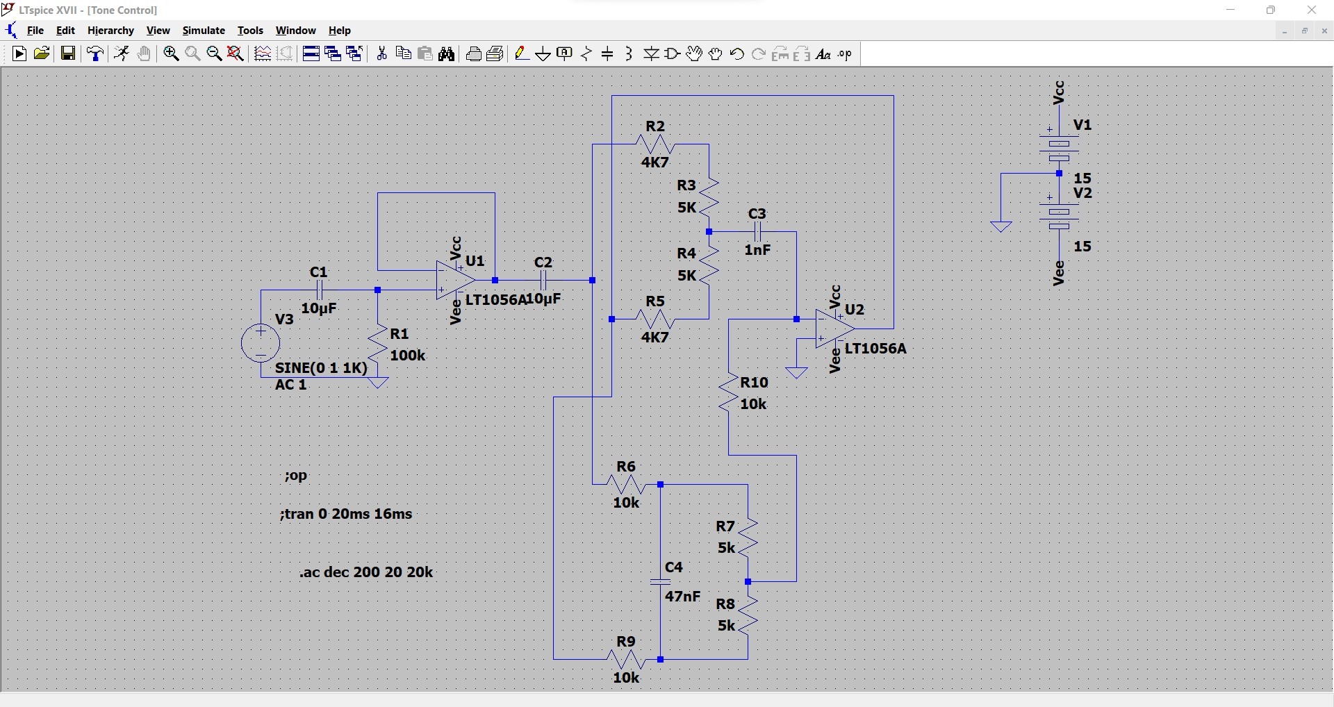

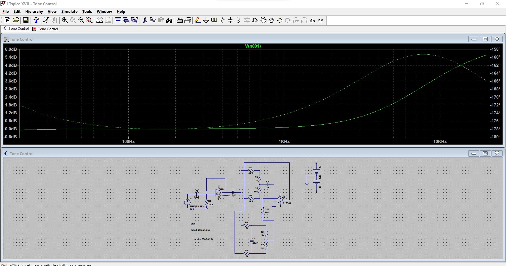

I've simulated the circuit and it behaves as expected really.
This shows max bass boost. You can see by the time you get to 10kHz there is no effect.

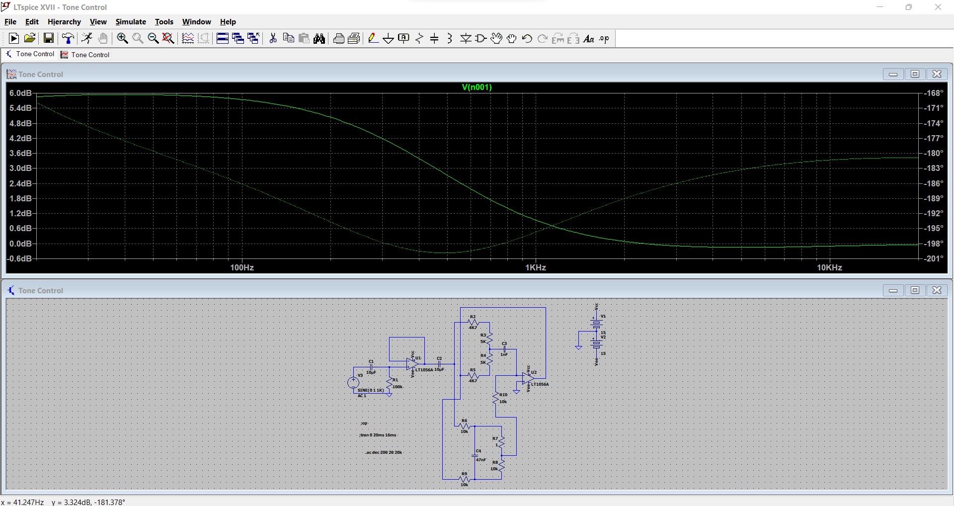

This is max treble boost. No effect as 60Hz.
The cut responses are mirror images.

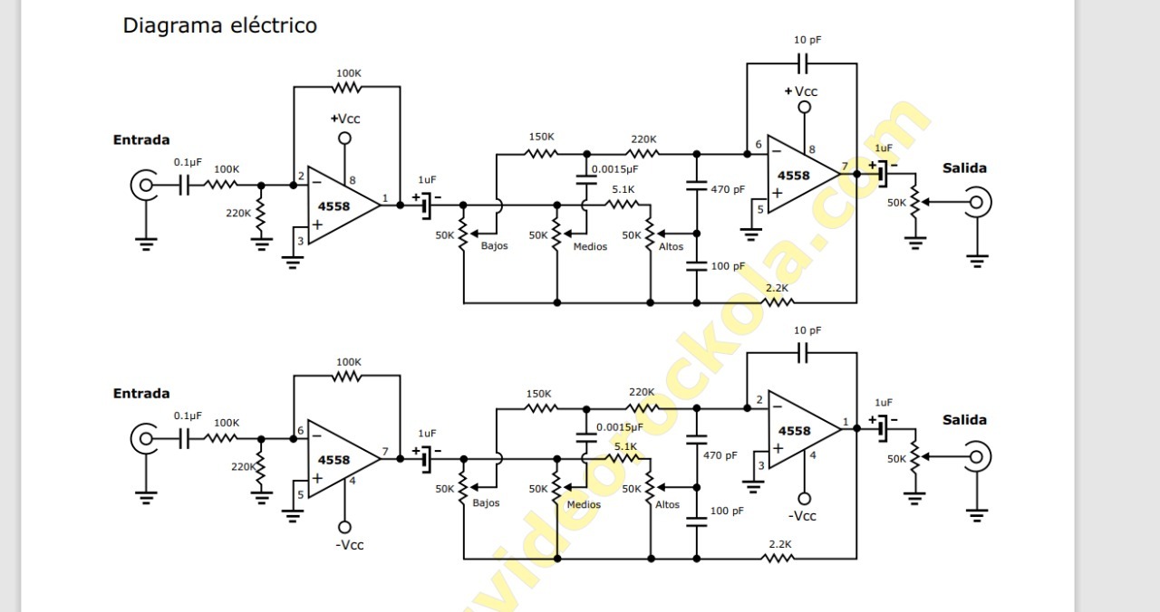

Here is the circuit that just works. Like most circuits sold in my country they are just copies of pre-existing stuff.
The circuit being discused here. If I turn the bass and trebel all the way down. It outputs a clean signal.
The second I try to add some trebel or bass. The wave form goes thick. If you zoom in on the curve. You see its made of a lot of small zigzag waves.
Is this how tone control works ?. Or should the wave form be clean at all settings ?.
Below is the circuit that just works. The opamp used is a NE not the number on the circuit.

A 3rd option given a friend who is into audio was that Tone Control board design can cause oscillations.
As in a defective or poorly laid out board.
My present obsession is to build a test gig where I can throw on an opamp IC and put it thru its paces to confirm that there is nothing wrong with the opamp.
Im trying to read up on various ways to test op amps. So far the only one I could understand was that you pass it a sware wave and chk the raise time on a scope.
I have also started reading up on old posts on this forum. Where the subject of how to test an NE or any op amp can be done. Have also been buying op amp ICs from various vendors in the hope that I can get something that works the best.
Id like to develop this test gig on a bread board.
If anybody has any ideas on a circuit to test things like amplification (With two trim pots). Slew rate, and other parameters to test for.
It is very difficult to fully test an opamp but tbh you shouldn't really need to on a diy basis. They are super reliable and consistent provided you only ever buy from recognised authorised suppliers. There are so many fake products out there with devices being remarked to appear as something else.Im trying to read up on various ways to test op amps. So far the only one I could understand was that you pass it a sware wave and chk the raise time on a scope.
