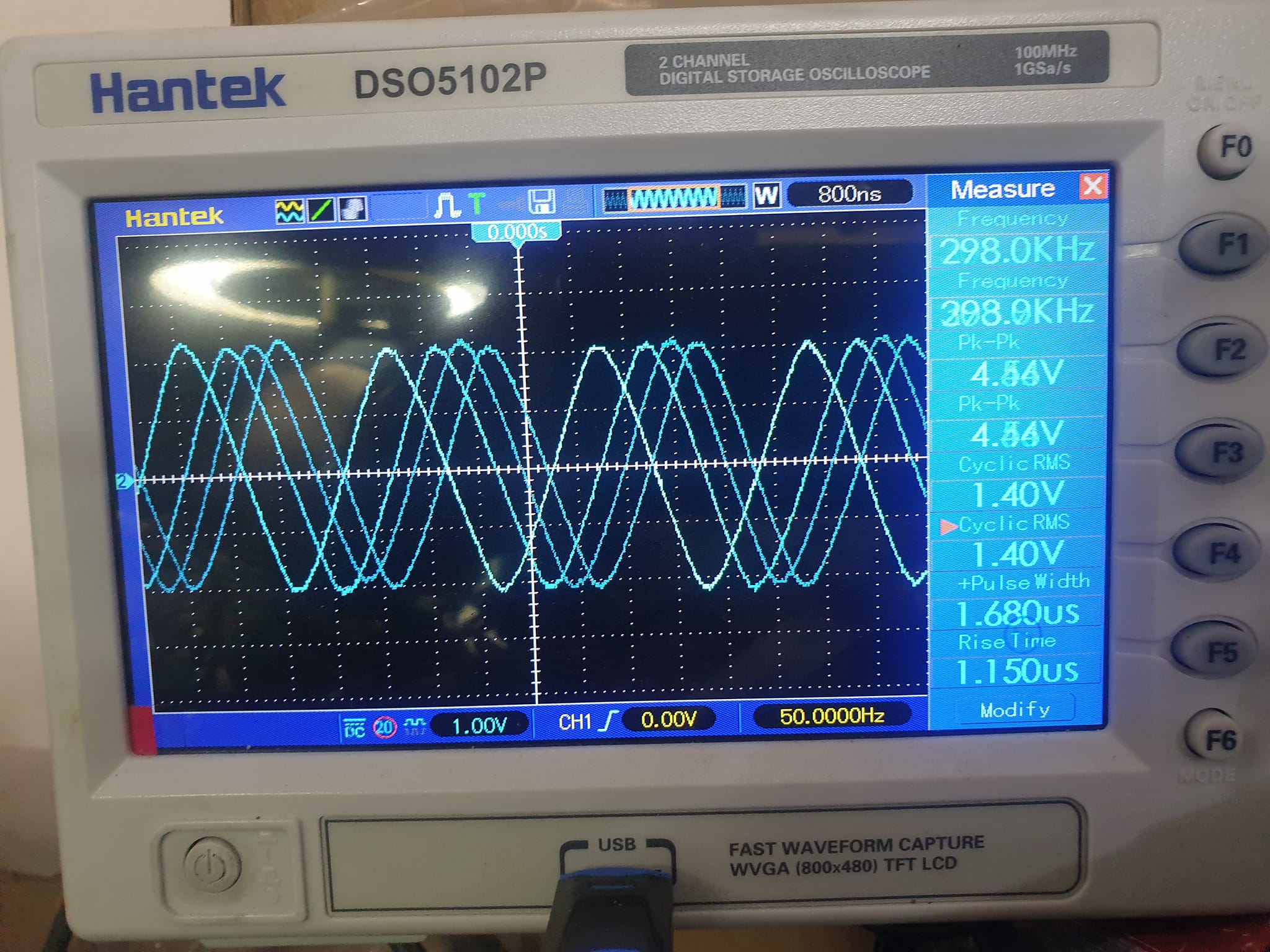

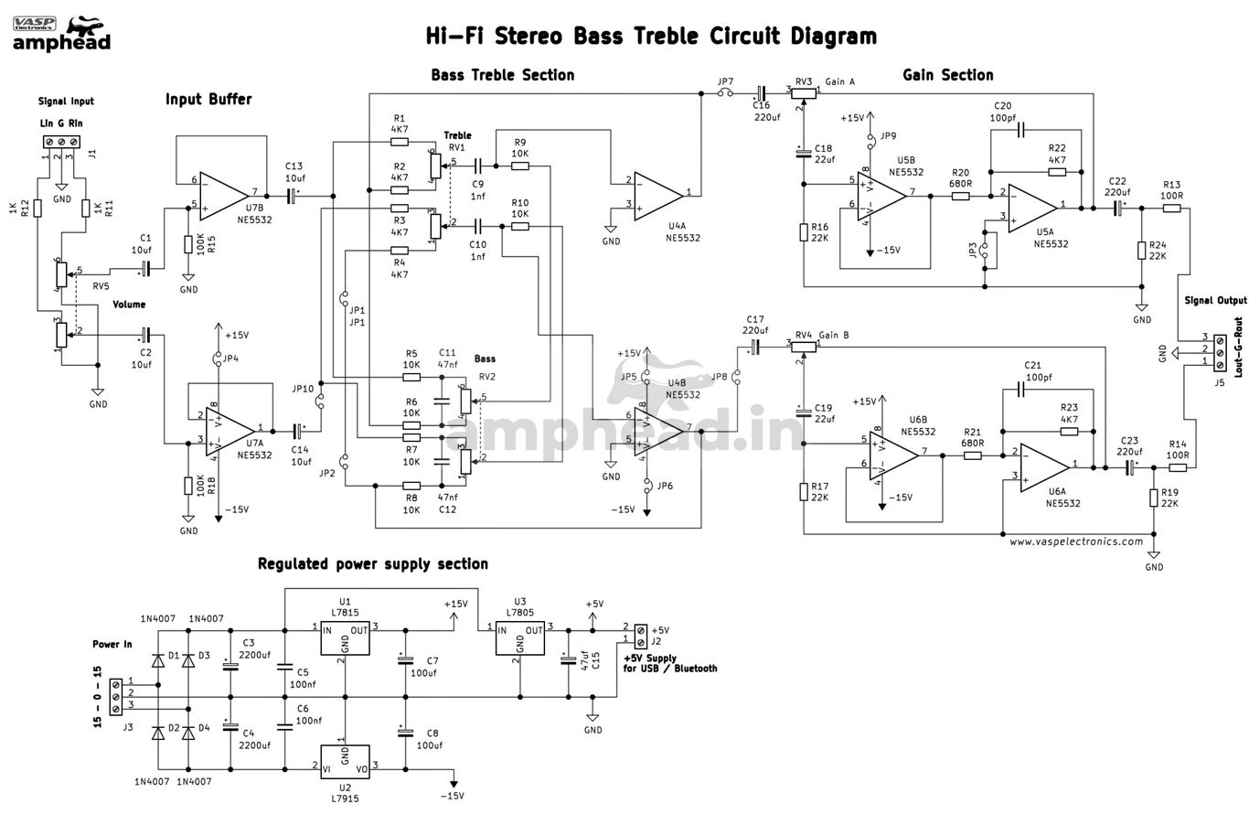

First here is the schematic.
Next here is the output
Questions.
1. With zero input and scope on output pins I see a huge voltage output off 20v peak to peak. The second I put any load across the output (Ear phones). The voltage drops to zero. What kind of load should be put across the output so I can test ?. A friend told me not to put any load. Another said 1K. Another said ear phones are ok. Is it normal for the output to behave like this with no load ?.
2. Playing with the gain control I can get a range of output.
Upstream of this pre-amp and tone control board I have a TDA7294 amp and also a LM3886 (Separate projects same pre amp). , So what voltage should I feed the upstream AMP ?. We tried feeding the amp a signal from my phone direct and the output was very disappointing. I read the data sheet for the TDA and LM multiple times but nowhere could I find a recommended input voltage. Am I blind / stupid or they expect you to know this ?.
3. Any ideas to improve or tweak this circuit ?. (Yes I know its an old design from the 50s.).
4. What could be causing the distortion on channel 2. (Blue line).

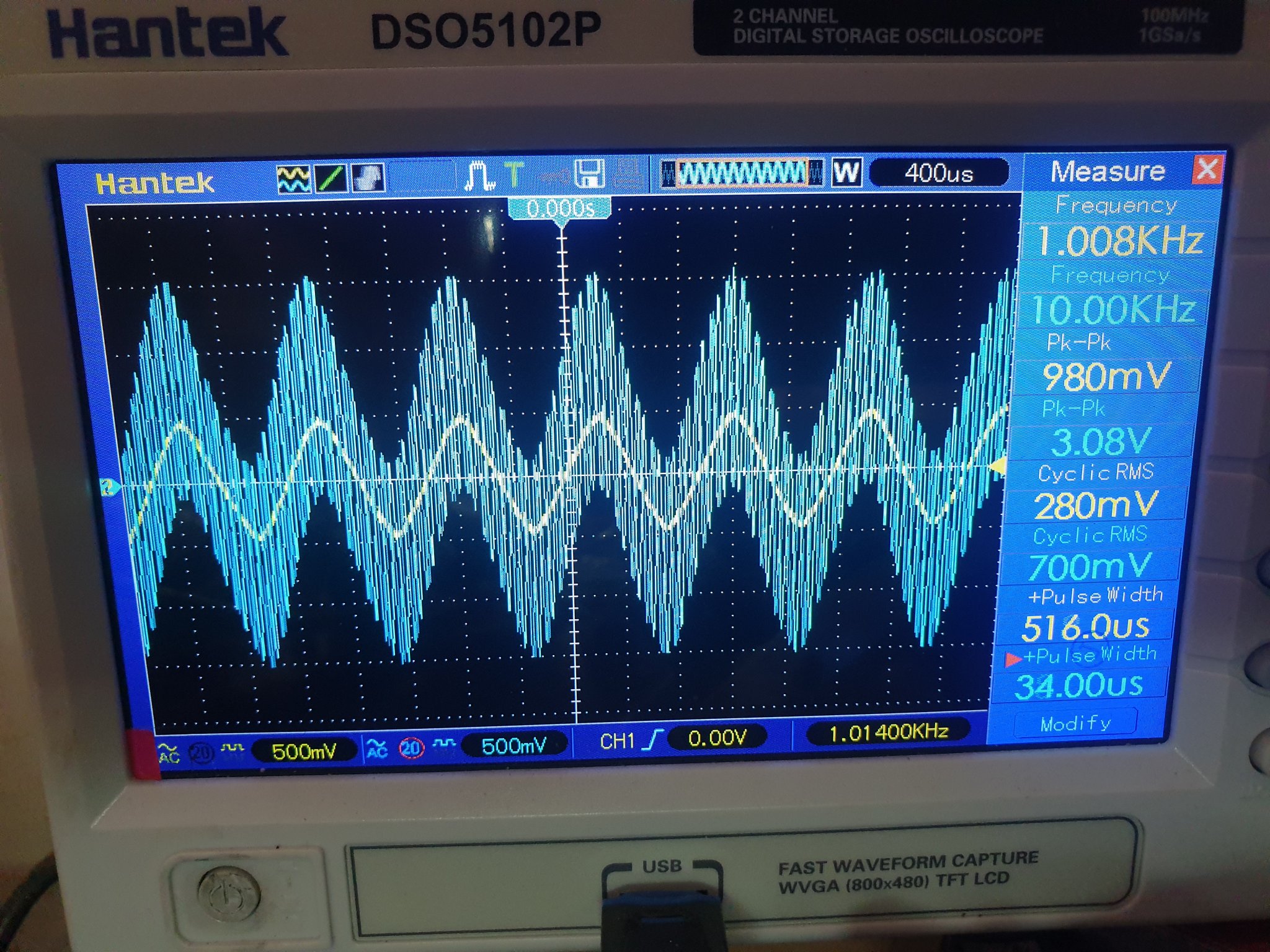

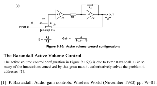

Now I look at the schematic... Thats a weird way to have the gain control in the feedback loop? Could be the reason..you build an occilator probably you need to add a capacitor somewhere..
Max input voltage is usually max output voltage divided by gain of amp.I read the data sheet for the TDA and LM multiple times but nowhere could I find a recommended input voltage. Am I blind / stupid or they expect you to know this ?.

So I have changed all the NE Chips, Changed all the caps to top brand. Added all the decoupling caps. Across the power of each NE.
Yet I am getting this output signal with nothing hooked up. Have not been able to clean it up.
Plan for today. Is to short the input lines. And try again. And then to input a low voltage signal and try again.
The circuit has 4 NEs. So its almost like each NE is contributing one wave. Cant think of anything else.
4 volts peak to peak with gain at 40% is going to be a problem. I did try shorting the input pins but still getting this output.

The problem is with RV3 and RV4. I see no value marked on the schematic. You need to limit the range these two gain controls have so I would recommend you add a series resistor between the 220uF and the pot. The value should be 0ne tenth the pot value. This will limit the gain to 10 times.
P.S. The design is not from the 50s. The NE5532 first appeared in the 70s.

The active volume control part of the circuit is a direct copy from Doug Self's precision Preamp of 1996. The volume control should be a 10k linear pot.
Typical practice is to use a 100nF cap on each opamp supply pin, other cap lead grounded. Use ceramic caps (X7R dielectric) with lead length as short as is practical.
I agree with comments that volume pot design is unusual. The tone control stage inverts, so that probably motivated design of an output stage that also inverts to yield net non-inverting behavior.
It might be useful to know volume pot resistance. With power off, you should be able to measure pot resistance in circuit with a multimeter. To determine the pot's resistance taper, would you also set pot to 50% rotation and report resistance between wiper and each end?

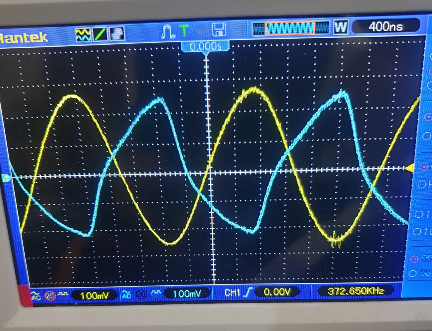

With no power there is no output. In fact as soon as i hooked up my function generator to the input the output dropped flat.
As of today This is the best signal I could get so far. With bass and treble turned all the way down.
The pot Rv3 Rv4 is 10k. At half way the input and output both both give the same voltage I.e. 1 volt in = 1 distorted volt out. Taking it up to 70% gives me what I want which is 1 volt in and 5 volts out. Have given up trying to get a clean signal with no input and now just trying to get the circuit to work. yellow is 1 volt in @ 1kh

Well it looks triggered now, that's good.
But you have what looks like an oscillation. Do you still see the oscillation if you turn down the input signal level to zero?
Just to be sure, check that the function generator is clean, connect it to the scope directly and check for a clean signal. Step by step is the word!
Jan

With no power to my function generator or my board I get this then again I don't trust this scope that much may need to get my fluke out of storeage and chk with that.
@jan the function generator signal is allways squeky clean from 100 mili volt to 9 volts. The oscillations remain even with zero volume

Sorry can't edit post but problem resolved went step by step found u4 to be culprit changed it and its all clean now. Fake chips are a huge problem in some markets. This is my first ne board and its been a good learning experience. I suspected the 15 volt regulator because one power rail was very different from the other.
What I learned from this is that TI chips are more often cloned i.e. they stamp the fakes with TI. A fairchild chip is less likely to be faked. The logo looks like a V.
