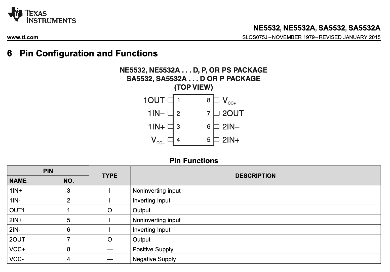

Pin 7 Vcc departure from standard pin out, ensuring replacement difficulties for the Pin 8 Vcc standard.
NE5534 has pin 7 positive, standard for single op amps. NE5532 has pin 8 positive, standard for dual op amps.
Very interesting thread. I was impressed by Mark Tillotson's notion that the NE5532 is good for RIAA MM stages, less so for MC stages.

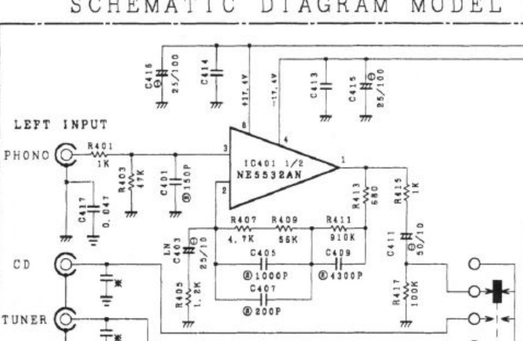

And can confirm what anatech said about the power pinouts on my now defunct Rotel RA-931 MM amplifier:
It then feeds a x10 buffer amp before the main amplifier stage. Looks competent enough. But TBH, I always hated MM cartidges at the top end, and that awkward 150-400 pF capacitance added to the inductive MM cartridge's RCA phono lead.

As mentioned this is actually the de-facto standard - go read datasheets some more! What varies amongst single opamps is the input offset and compensation arrangements on pins 1,5,8 - so there is no proper single standard pinout for single-opamps, whereas dual and quad are pretty much completely standardized.Pin 7 Vcc departure from standard pin out, ensuring replacement difficulties for the Pin 8 Vcc standard.
Of course the fact the pinout is compatible doesn't mean you can randomly swap opamps into a circuit, there are far more factors at play from bias currents to stability, noise, precision, bandwidth and more.

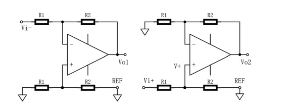

My take on that would be to make them large enough to make them zero impedance in any range of interest. It is most important to have good CMR at 50 or 60 Hz. If we move that down in subsonic by large caps, poor CMR in that region will not harm .Does anyone know the definitive answer about matching the capacitors before the R1. I was always curious about that, being a perfectionist. My transfer function maths calculation said match them. 🤔

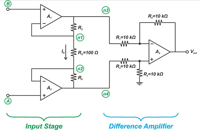

Replace each R1 with a Z1 and the circuit is still balanced. Realize Z1 with any RLC circuit you like and everything is still balanced as long as the RLC circuits for the two Z1s are the same.
When you pick an RC series circuit for Z1, you have a differential amplifier with input coupling capacitors. Those capacitors need to be equal to get equal Z1s and keep the balance.

Yes, a departure from IC pin layout/ convention.de-facto standard
Just look up a TL071 datasheet or a uA741 datasheet or an AD797 datasheet. Pin 7 is almost always the positive supply for 8-pin single op-amps.
IMO that wasn't a common sense approach when ever it was implemented, way too late now, but IMO someone took a wrong turn when they decided to depart from the top right pin being positive and the bottom left pin being negative. (given indent 'North' or 'up').
