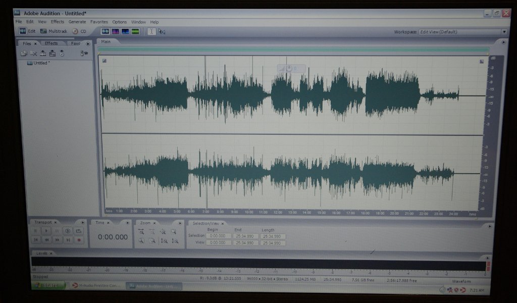

Will test with some recordings over the next week and report.

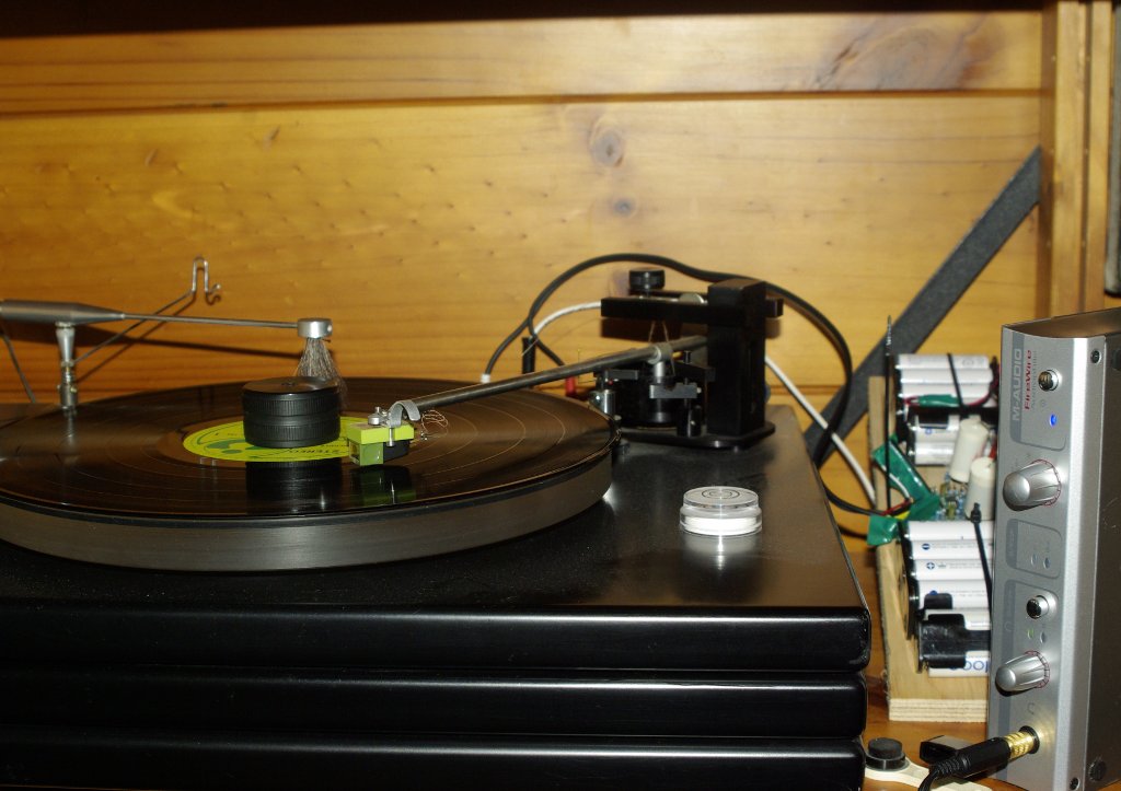

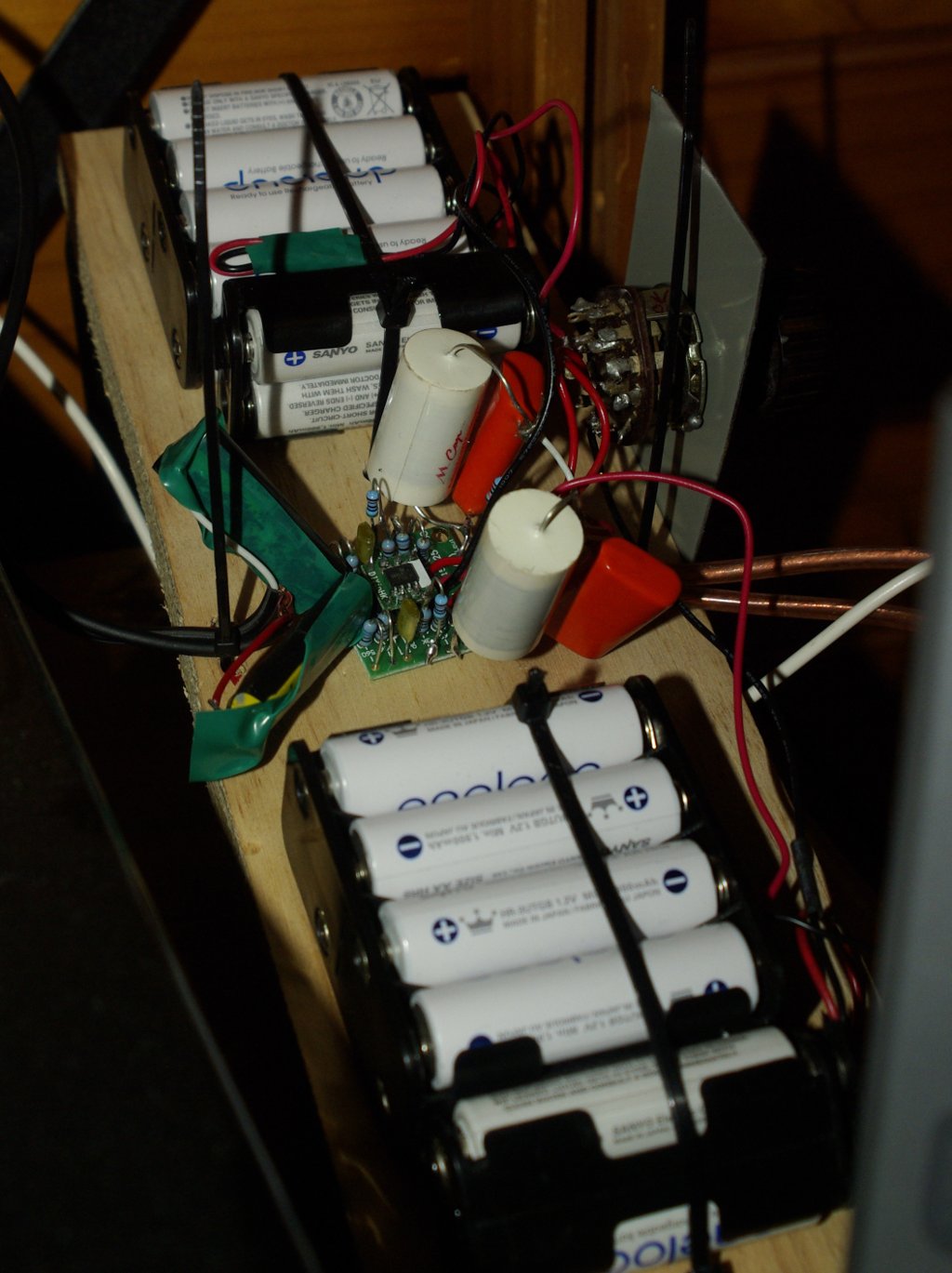

Some pix attached...I'm sure you will all shudder at my layout and point to point soldering but it has been quick to trial and once it is all working I will consolidate and build a power supply.
Again, thank you all for your input, it has been so helpful !.
