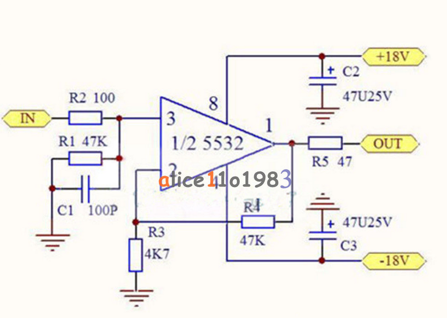

NE5532 circuit.What to change to increase amplification
NE5532 preamp/buffer.. (Schematic attached) Running from battery@~14.5 volts+/-
What resistors do I need to change to increase the amplification ? Seller claims 3x as shown and this is too low.
Use case= I am wanting to amplify the output of my Moving Magnet Phono cartridge and record it. (yes I know it will not be RIAA equalised...that is what I want 🙂..)
I am feeding an M-Audio Firewire-Audiophile and using Adobe Audition 3.1
Currently the recording levels barely register and I have to use the software amplification within Audition to process the recording and increase by 30db.

Thanks ! I will try 1k for r3 and see what that gets me.
Edit....Lol....just checked the board and none of the values are as per the sellers schematic...
r1=39k r2=560r r3=1k r4=3k r5=68r
is it set up as a buffer with unity gain ?
I will try 47k at r4
If you use 100K for R4 and a 1K for R3, you'll get about 40dB of gain. If you set the gain too low, you may end up with more hiss noise, when you have to add more gain downstream. A metal film resistor for the 100K will generate less noise than CC or CF types. You might need to put a small cap across the 100K if there's any indication of instability (oscillation), maybe around 20pF (for 80kHZ rolloff). It's also wise to have 0.1uF caps from each power supply to Gnd within an inch of the chip (for stability). Another thing that could help stability is to increase R5 to 100 - 200 ohms.
Wow ! Thanks so much... this is just the most helpful forum.
I've changed r4 to 56k and that has given enough signal for what I am trying to do.
Have to do some recording and processing with inverse RIAA to evaluate.
Initial headphone monitoring shows some distortions so will have to try Bob's suggestions for stability... such good fun!

Disagree on that 🙂 Look at the input bias currents for a 5532. They can be as high as -800nA which would develop -31mv across the 39k input resistor. That voltage would then be multiplied by the DC gain of the circuit (57) giving an offset of almost -1.8 volts.
800nA is worst case, typically it will be around a third of that, and the above calculation also assumes nothing (with a DC path to ground) is connected to the input.
So as the circuit stands and with a genuine 5532 I would expect to see at least around -0.5 volt offset at the opamp output.
That's right. The final offset depends on what is actually connected to the input and what the DC resistance to ground actually is. A moving magnet cartridge might well be in the 1k ish zone and that would work to reduce offset errors based on the component values used.
Interesting to know if it really is a 5532 that is in there though. Checking the offset with nothing connected would go a long way to confirming (or otherwise).
Phase just means does it invert the signal or not. It doesn't usually matter, as long as both channels of a stereo are the same phase. The schematic shows a bipolar power supply, which is optimal. If you want to run it off a single battery (monopolar power supply), you'd want to tie all the grounds to the center of a resistive divider (2- 5K R's across the battery should do it), and put a 1000uF cap across the battery, and maybe 100uF across each of these 5K R's, so the opamp sees zero ohms when it looks at the battery (for stability sake). I'd put a 2uF non-polarized cap in series with the output with a 100k resistor to computer ground after it, to get rid of any DC that would be fed into the computer card. Also put a 1uF non-polar cap in series with R2 to keep DC out of the cartridge (0.33uF would cut you off at 10HZ). Regular op amps like the 5532, TL072, etc. may be a bit noisy (hiss) for use as a phono preamp, but may be good enough for what you're doing.

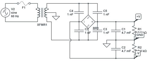

+- supply rails is NOT battery. Unless you use two of them. Most op-amps can be connected to single supply rail. ie a battery. Have you come across dual supply rails? ie, +, - and 0V ?? the circuit above is designed to run thus. And NOT from a single supply rail!
I think Mr. Mooly is hinting towards using series capacitors on the i/p and o/p. I'd suggest may be using 1-10uF on i/p and using a 10uF on the o/p. Use n.p. capacitors, preferably film types...
I will do a quick search for a simple power supply for that circuit. See below for an example... Obviously mains can kill... So be careful!
