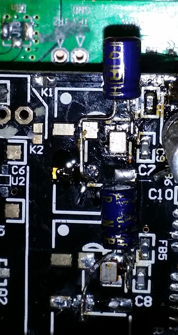

So I can attest to the nightmare of using wire to attempt an installation onto a board that once had a larger clock on it.
I’m afraid it has cost me a single device, and will not be using that one. I will need to order another and find an adapter board solution as well. Unless you are upgrading a cell phone, these probably won’t do you much good as is.
Actually will just leave my project alone for now, been a really bad week here, and not wise to attempt any heroic soldering for a while I’m afraid.
So the pad that I thought I had lifted was intact, and I mounted it to a fabricated breakout board, thought that was some good news.

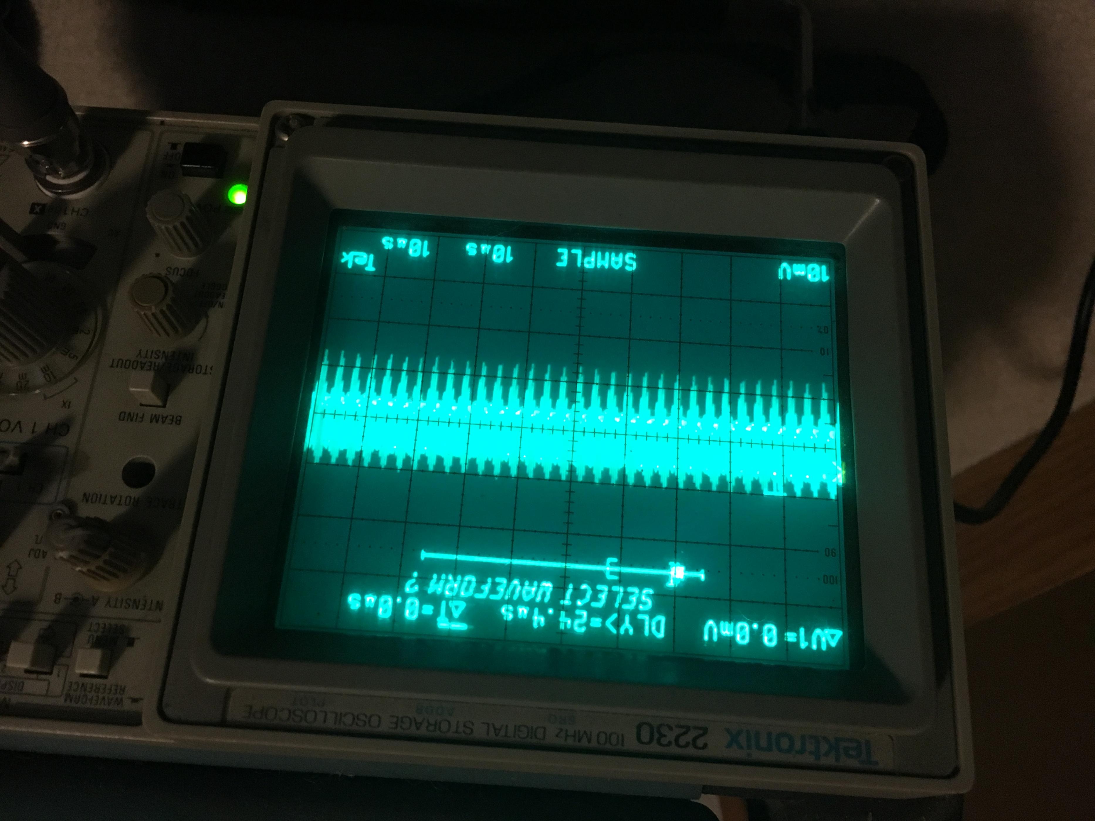

I powered it up and it makes an asymmetrical wave form of sorts.
Any ideas what is going on? I’m new to oscillator circuits, intentional ones anyways.
