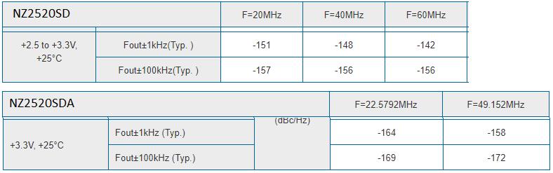

Found the data page for the older SD model:
NZ2520SD(OA / AV)/Crystal Clock Oscillators/NDK
versus the new SDA model:
NZ2520SDA(OA / AV)/Crystal Clock Oscillators/NDK
Looks like a substantial lowering of 1kHz phase noise by about 12dB (wish they specified 10Hz and 100Hz noise too, but realize those are much harder to measure).
