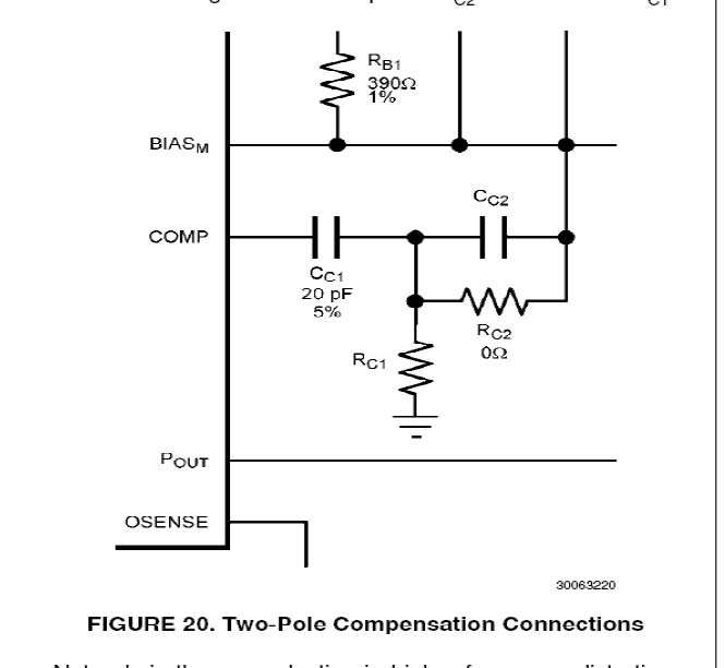

jackinnj said:Is this the new "correct" comp circuit for the LME49810?
Jack,
Have a look at AN-1850 page 13 for the comp circuit - sorry, didn't have time to make a nice drawing like yours... It shows the circuit a bit differently. Is An-1850 for something different?
thanks,
Ken
Hi Klewis,
AN-1850 was written for the LME49730 which is the FET driver in the series. The added circuit shown (which is not in AN-1850) was designed by Bob Pease for the LM4702 and the LME49811 (the 811 is a mono 4702 with a minor tweek). The circuit that is "added" in the posted drawing is actually a "noise gain compensation" circuit. (I had never seen one before Bob showed it to me!) It is required for the 4702 and the LME49811.
Best Regards,
Mark / Audioman54

Mark -- did you tweak the amp in AN-1490 for the new compensation circuit? If so, what was your impression.
I just got in another Crown DC300 for an amp-ectomy.
Hi Jack,
That circuit was designed for the amp in AN-1490! It solved a stability problem in hard clipping and improved the sound quality a bit. Again, it is a "must do" for the LM4702 and LME49811. It was not required on the LME49710 which is a totally different animal.
Mark / audioman54
Mark / audioman54

Mark,
I really appreciate your comments and tips, they've been quite helpful.
I don't want to be a pest about this, but, this is what is shown in AN-1850 called a two pole compensation circuit. (I hope the image shows up)
I'm currently stuffing a preamp board with the LME49720's with a dc servo - I switched to the metal can variety on your recommendation and am really looking forward to hearing the results. I've also built the power regulators around the LME49860, that up and running - it shows less ripple on the scope compared to LM317 regulators.
Ken
Hi Ken,
Yes the circuit shown in the AN-1850 ap note is a two pole comp circuit but it is different than the one show in your previous posting. In that one the comp cap (Cc) goes from the comp pin to Biasm pin and then the resistor cap combo (3k/75pf) that is the noise gain cancellation circuit also connects to the comp pin but then it is connected directly to ground. The two pole comp is quite different.
Does that make sense?
Mark
Mark
