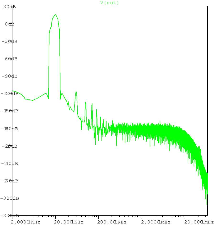

Mark, sorry to hear about your layoff and the issues at NatSemi. There's a small irony here, in that the LM497xx/8xx series opamps are not available at retail in places like India, where I'd grab a few dozen to play with, if I could. However, that's not NatSemi's fault, but their distributors'. For now, I have to remain content with simulations.
Anyways, here's my first try at an ultra-low distortion low-power headphone amp with an LME49860. Nothing terribly clever, just a slightly tricked-up Class-AB Diamond-Buffer to increase the power capability, and a current-dumping reactive bridge to add a bit of feed-forward error correction. It can put out about 2W into 32 ohms, which is waaaay more than anybody needs for a headphone amp. At 0.5W into 32 ohms, it runs in Class-A. It will also give comfortable levels of power into higher-Z headphones, at even lower THD.
Edit: On a related note, is there a publicly-available Spice model for the LME49600 high-current buffer? I could greatly simplify this circuit with the LME49600.

Hi, Linuxguru,
Do you have your version of patent #4,716,378? It reduce distortion because the main amp see a much higher impedance of the load.

Is this the new "correct" comp circuit for the LME49810?
Hi, Mark,
“Noise Gain Comp” circuit from Bob Pease, if I'm not mistaken, it should be placed in (-)input to ground or to (+)input. Is the "comp" pin equal to (-)input pin ?
lumanauw said:Hi, Mark,

Good Morning Everyone,
Firstly, Jackinnj that is the correct circuit, however the LME49810 does not require that circuit although it probably won't hurt. That exact circuit is required on the LM4702 and the LME49811. For higher quality amplifiers under 300w use the 4702 or the 49811 with both have 5ma or so of output current. For higher power amplifiers that need the 50ma of output current to drive them up to 3kW the LME49810 is the way to go. (The 49810 has an extra A/B stage to get that extra output current.)
Secondly Linuxguru, yes the LME49600 would be a great choice for your headphone buffer as that is what the 49600 was designed for. It is built on the same process as the other LME parts and has the same sonic qualities. I might also suggest the LME49713 as a second possibility as it has 100ma of output current which means you don't need to use a buffer at all to drive your headphones. The metal can 49713 with a clip on heatsink would give you even a little more!
