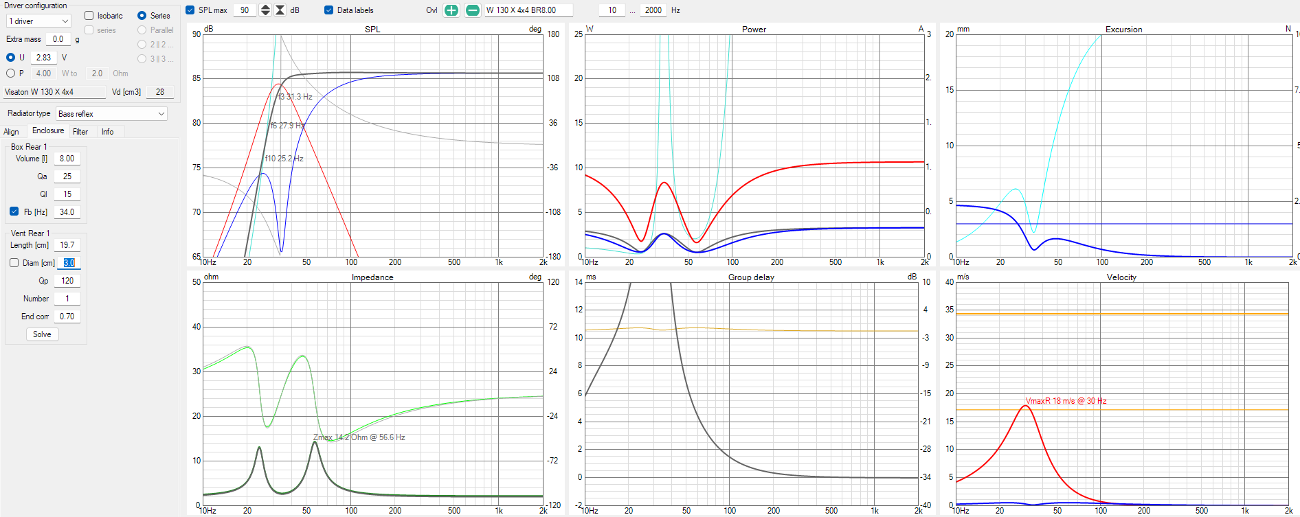

Do I need a certain f3? Really I'm just aiming for as low as I can reasonably get given the dimensions I'm working with. I'm not aiming for awe-inspiring home theatre, just a general improvement for a fairly low budget.You got a limited volume, but need a certain f3.
The Visaton in a ~8L vented box actually appears to be an option. The datasheet even suggests vented 7.5L so one would assume it's not an awful idea, though that doesn't indicate which coil setup that would utilise, if that makes a difference. I had tried this before but for whatever reason must have moved on to test something else and forgot. I'd imagine that excursion (28Hz and below) could potentially be a problem, but is there anything else I'm missing here?

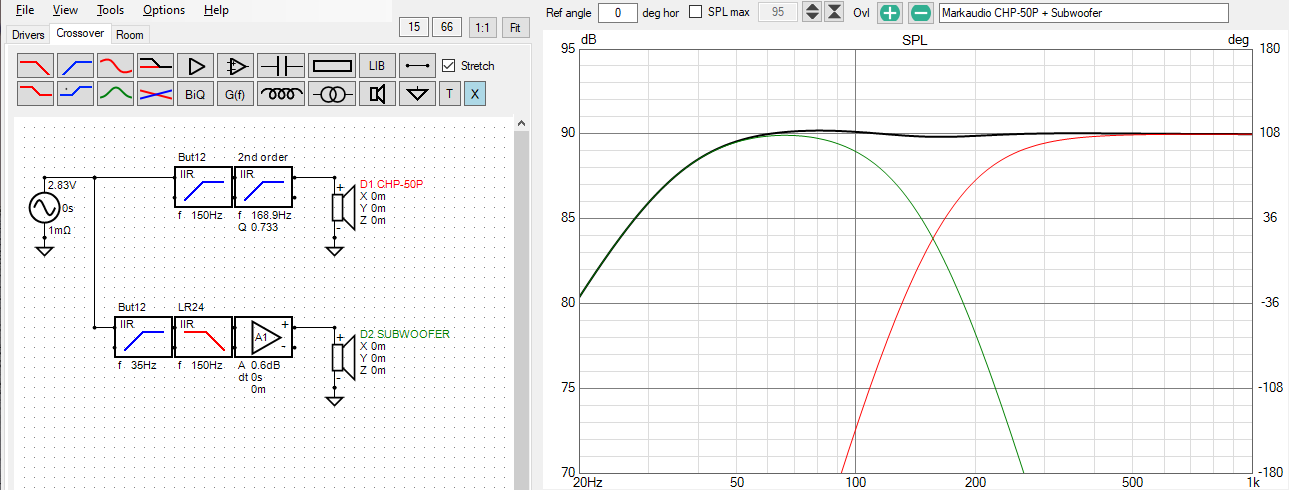

As @Turbowatch2 commented, the Denon AVR is quite nice. It can certainly enable a proof-of-concept investigation. It has 75W per channel @ 0.08% THD available, which is a good power capability. The small 3-inch driver, with Re = 3.3ohms, can't handle anywhere near that sort of power before maxing out, so driving it with a few watts shouldn't pose any major problems for the AVR.I have an old Denon AVR-1513 but it's pretty basic and dated (no ARC, for example), isn't rated for <6 ohms and would require a secondary sub amplifier.
If the AVR has a 150Hz filter setting, that would certainly help protect the CHN-50P drivers from handling excessive high-power low-frequency signals. A simulation of the result when a subwoofer is added is shown below, which shows promise. The CHN-50P 2nd-order response is modelled, to which the AVR's expected 2nd-order Butterworth 150Hz high-pass filter has been added. The subwoofer has a 150Hz 4th-order Linkwitz–Riley low-pass filter included, as this is the type of filter that the AVR would be expected to have added to the subwoofer. As you can see, the bass integration between the subwoofer and the main speakers is quite good.I was thinking to sell that and get a cheap 2.1 amp such as the SMSL A50 Pro which has a powered sub out with level adjustment and a limited number of crossover points, one of which I believe is around 150Hz and seemed like a decent fit.
As a result of the small room size, you probably won't need much power, saving the little 3-inch drivers from too-early destruction.Edit: as a note, I currently have an SMSL A100 powering a pair of Mark Audio Alpair 5.3s in slot-vented bookshelf cabinets, and have been very happy with them. As a second note, the room is a small living room in a Victorian terraced house.
Thanks for taking the time to run through this! My main issue with the Denon is it's lack of CEC, and therefore control via TV remote. But as you say, I can at least test the speakers with this and one of my other amplifiers for now.As you can see, the bass integration between the subwoofer and the main speakers is quite good.
