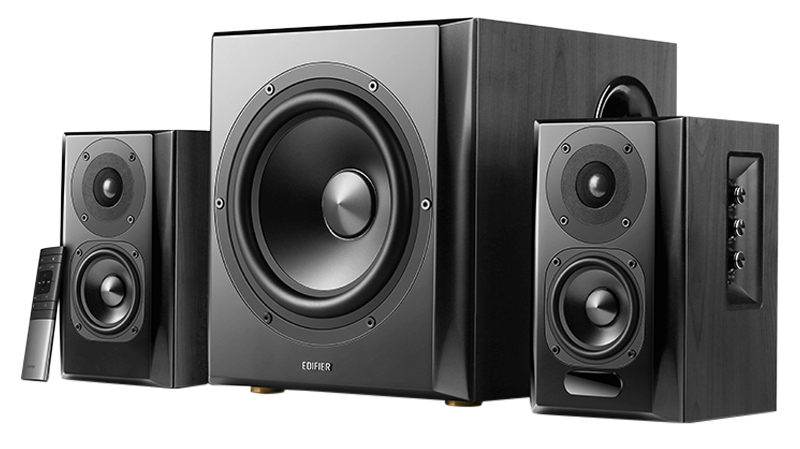

Although it's not a DIY solution, considering that space is limited, a turnkey system such as the Edifier S351DB 2.1 bookshelf speakers with an 8-inch subwoofer might be worth considering (see photo below). They can take digital input from the TV and also have a remote control, which allows them to be switched on/off remotely. They can probably go reasonably loud as long as the listening distance or room size isn't too big, and the bass response also seems to be quite extended. By the time the individual costs of drivers, amplifiers, cabinets, etc are factored into the DIY solution, the S351DB seems like very good value for money, while still being quite compact.

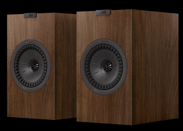

The other non-DIY approach would be to use a set of KEQ Uni-Q Q3 Meta 2-way vented-box bookshelf loudspeakers. These are quite compact in size, with moderately extended bass response, and have excellent dispersion, and wouldn't look out of place either side of a TV. They need an amplifier of course, but there are plenty of those to choose from.
The previous model, the KEF Q350, may also be available at discounted prices.

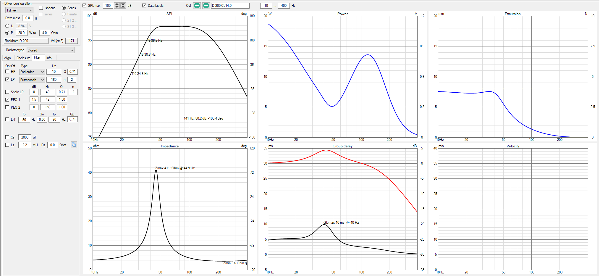

A single Reckhorn D-200 woofer driver seems to work reasonably well in a PEQed closed-box enclosure of 14-litre net volume. The simulated results are shown below. A 2nd-order 160Hz Butterworth low-pass filter has been applied, and an f3=36.2Hz seems possible when PEQ of 4.5dB and Q=1.50 is applied at 42Hz. This produces about 98dB SPL with the driver almost reaching its Xmax.

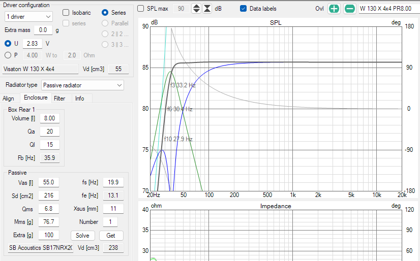

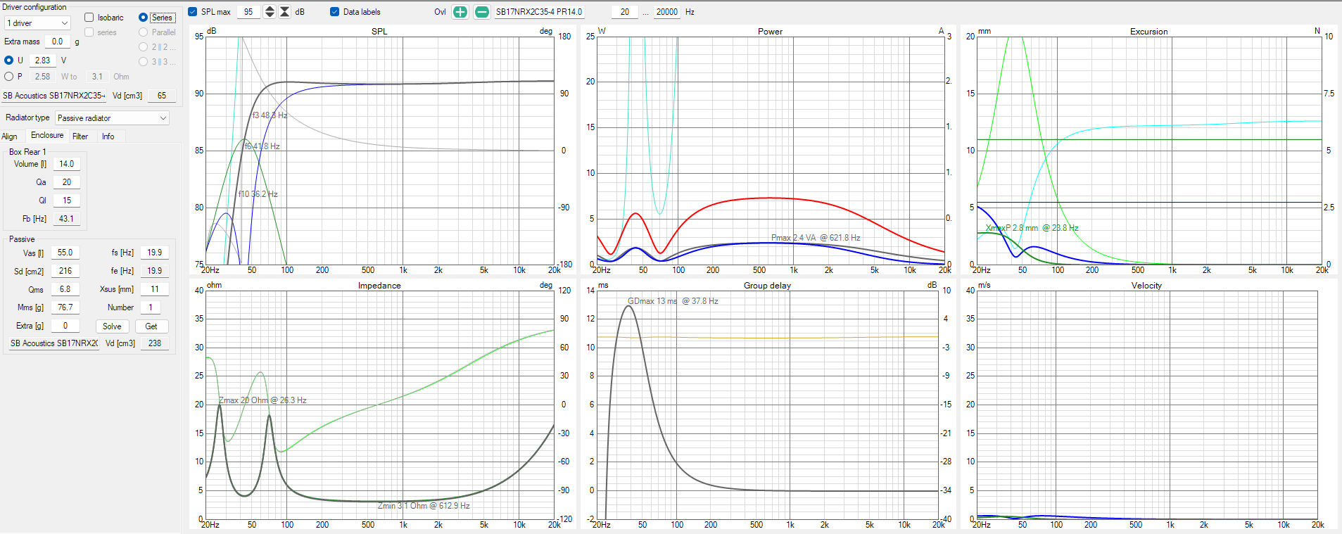

I've done some more research, modelling a couple of options and come across a combination that looks interesting: pairing a SB17NRX2C35-4 with a SB20PFCR-00 in a ~14L box. Thoughts?

Can you share the results of your modelling?I've done some more research, modelling a couple of options and come across a combination that looks interesting: pairing a SB17NRX2C35-4 with a SB20PFCR-00 in a ~14L box. Thoughts?
Just one point, the SB17NRX2C35-4 is no subwoofer driver.
The combination with the passive radiator would be used in a nice, compact 2-way speaker.
If you use a lot of trimming wheight on the passive, the poor SB17 will not have enough power to move it.
This is why there are dedicated subwoofer driver, which have a large coil travel, heavy cone, large voice coil and matching motor.

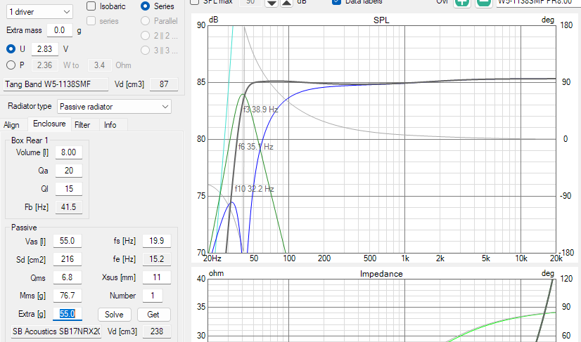

Interestingly, two other drivers appear to be an option for extended bass (albeit at a large trade-off with SPL) using the same PR but with some weight added, in a much smaller box. At least, they do to my untrained eye.
Tang Band W5-1138SMF
Visaton W 130 X (DVC wired in parallel, resulting in 2ohm draw).
@hodephinitely Thank you for providing the plots. If I may, I'd like to offer some small suggestions that help with the interpretation of the data. 1) use an upper frequency limit of 200Hz or 500Hz when plotting the low-frequency response; 2) use a lower frequency limit of 10Hz, or even 5Hz, to showcase the low-frequency roll-off behavior; and 3) use a dB range that covers at least 20dB of the SPL response function. All of these together make for plots that are a bit easier to interpret.Sure! Here it is.
The W130X has a very small surface area compared to the passive radiator and an excursion of +- 5.8mm with 10% distortion. A 6.5" passive radiator should be a better match.
Not anything you can do in a simulation makes sense in real life. You need to add some common sense, which comes from learning theory and doing practical work, as well as listening to people "that know". Maybe not anyones style. Some may be born as subwoofer designers, but those are quite rare I guess.
That makes sense! I'd kept the high frequencies as I was messing with filtering and series inductors.All of these together make for plots that are a bit easier to interpret.
I was under the impression a good rule of thumb was to have at least 1.5 to 2x the Sd value for a passive radiator. What would be the negatives to having such a mismatch in this instance?A 6.5" passive radiator should be a better match.
I do not understand why that should happen, unless the PR has a very nonlinear suspension, which again would be independent from weigth and a sign of very bad PR design.If you use a lot of trimming wheight on the passive, the poor SB17 will not have enough power to move it.
Of course there can be a problem if you use a very big PR in a very small enclosure and for tuning low you have to add weigth up to the point where the suspension system is being deformed and gets non-linear.
It's similar to a single man pushing a huge ship. The ship will move slowly and take long, but it will move.
@Turbowatch2 Thank you for pointing out that the displacement figure of ±5.8mm corresponds to 10% THD. It's very good of Visaton to provide that sort of detail in their specifications.The W130X has a very small surface area compared to the passive radiator and an excursion of ±5.8mm with 10% distortion. A 6.5" passive radiator should be a better match.
From the magnet structure and voice coil winding height, it seems that Xmax = ±3.0mm for linear operations. That's quite a limited displacement capability. As long as a relatively low maximum linear output capability is acceptable, this driver does produce excellent low-frequency extension in compact enclosures.
The PR displacement (Sd times excursion) should be double the active driver, regardless of size.I was under the impression a good rule of thumb was to have at least 1.5 to 2x the Sd value for a passive radiator.
Since the PR diaphragm is heavy, it should be placed vertically, or it's displacement may only be around half it's rating, as it's weight will cause it to sag from the center position.
Since you want to limit your vertical height to ~100mm, that's the limit of your PR height.
There are oval "racetrack" shaped PR that have more Sd than a round PR.
The usual PR "Xmax" is generally just under or equal to Xlim or Xmech, the maximum the suspension can travel.What would be the negatives to having such a mismatch in this instance?
When the suspension reaches it's limits, a slapping ("pup-pup-pup") non-musical noise will be heard (and the suspension or cone may be damaged), while a driver passing Xmax just generates more harmonic distortion rather than nasty noises.
With little drivers with limited excursion, doesn't take but a few mm to go from 10% THD, hardly noticeable with most music, to over 100%, which is noticeable.
