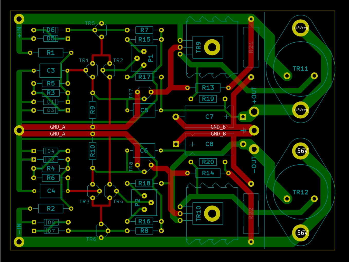

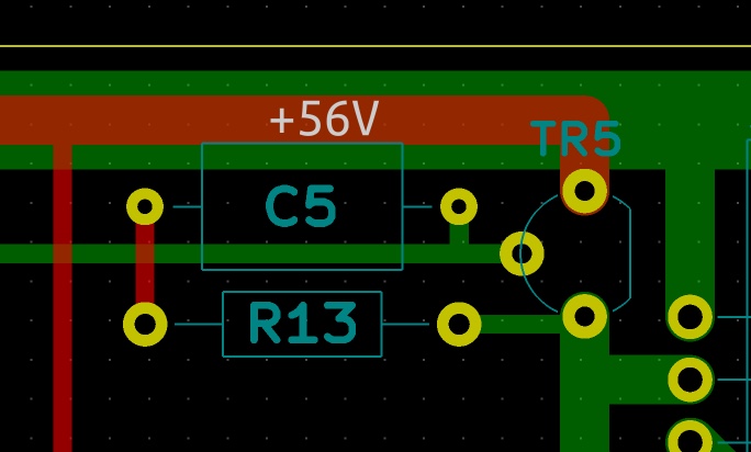

NAP250 clone
Too subtle? :confused:

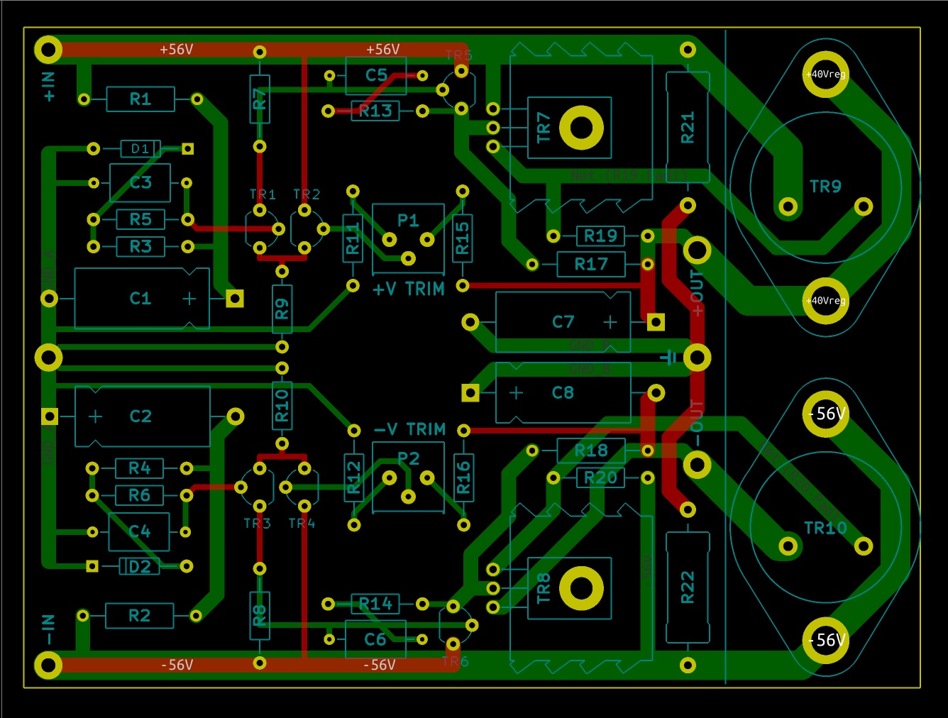

Are you referring to the NFB trace? It has a resistance of 17mOhms, which is well below the tolerance of the 27K resistor already on that net.
The LTP's tail is also a bit long, but that's just a CCS, so a bit of resistance there isn't going to do any harm.

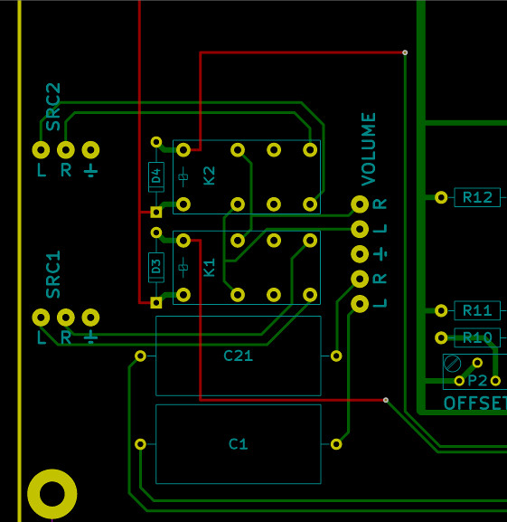

I'd just add one thing: when you can't keep sensitive traces completely away from dirty ones, at least run them at right angles to each other.
Here's an example from a preamp:
attachment.php
K1 and K2 are relays that select the input. Their 12V power lines come in on the front of the board (red traces). Note how they are not optimized to be short, but rather to stay away from the input traces (on the back of the board, in green) until they have to cross, and then to do so at right angles.

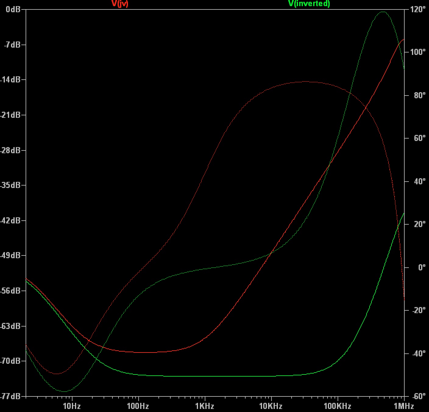

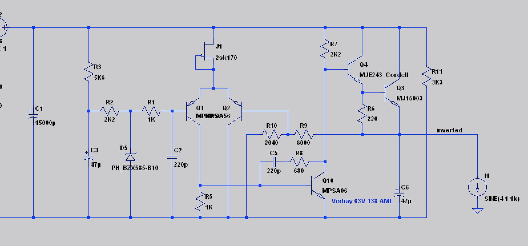

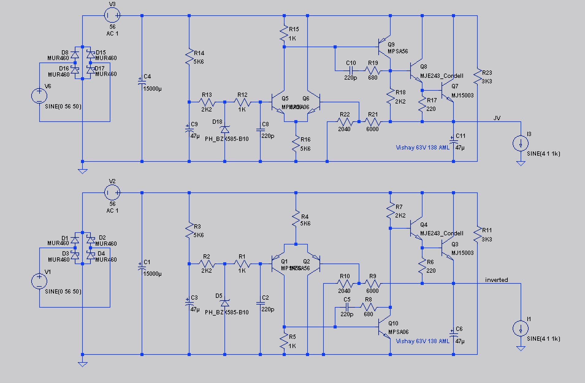

Piglet'sDad over on PinkFishMedia mentioned that the NAP250's regulator was greatly compromised by having its VAS referenced to the noisy power rails (thereby giving it poor PSRR at high frequencies -- right where the NAP amp circuit needs it).
So I tried a version with the VAS referenced to ground (which also means flipping the LTP):
attachment.php
(This also has the advantage of looking like a VAS followed by a Darlington, rather than visually masquerading as an output triple.)

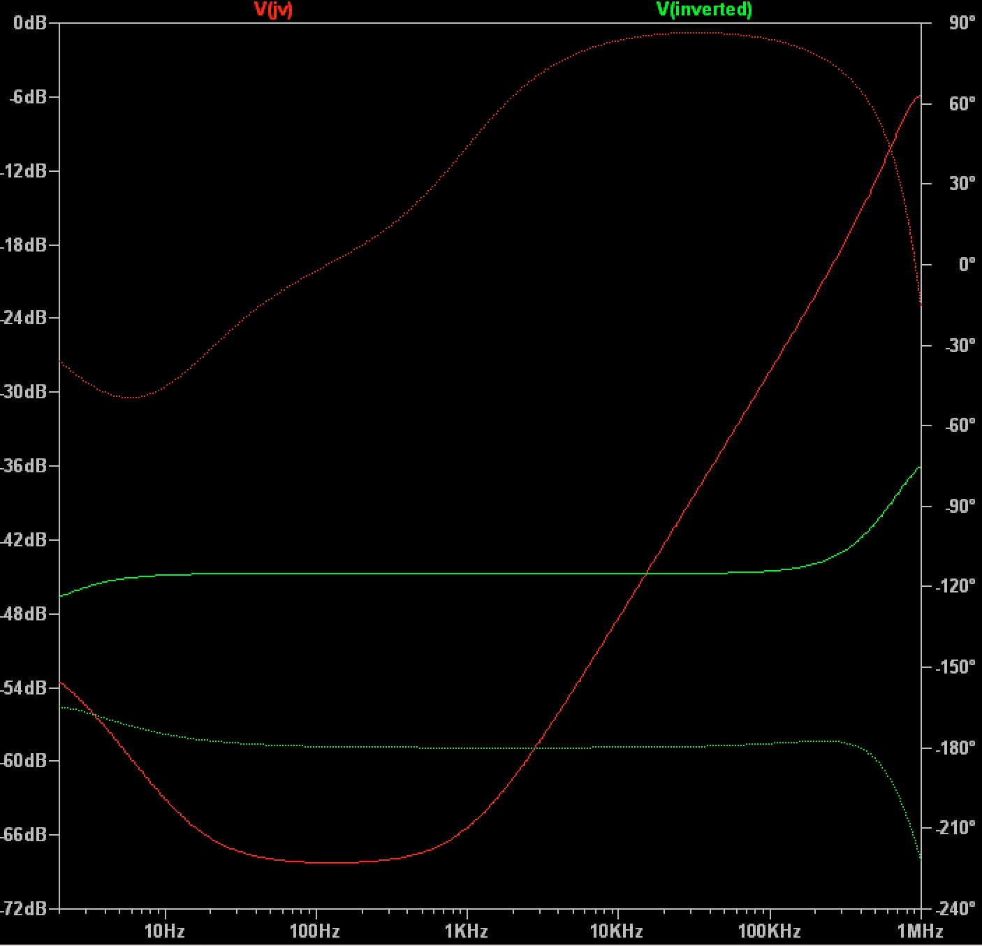

While it has vastly improved attenuation at high frequencies, it gives it back a low frequencies:
attachment.php

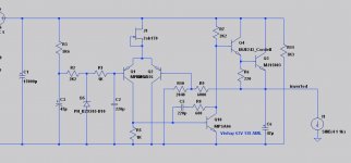

Swapping a resistor for a JFET lets us have our cake and eat it too:
attachment.php
attachment.php

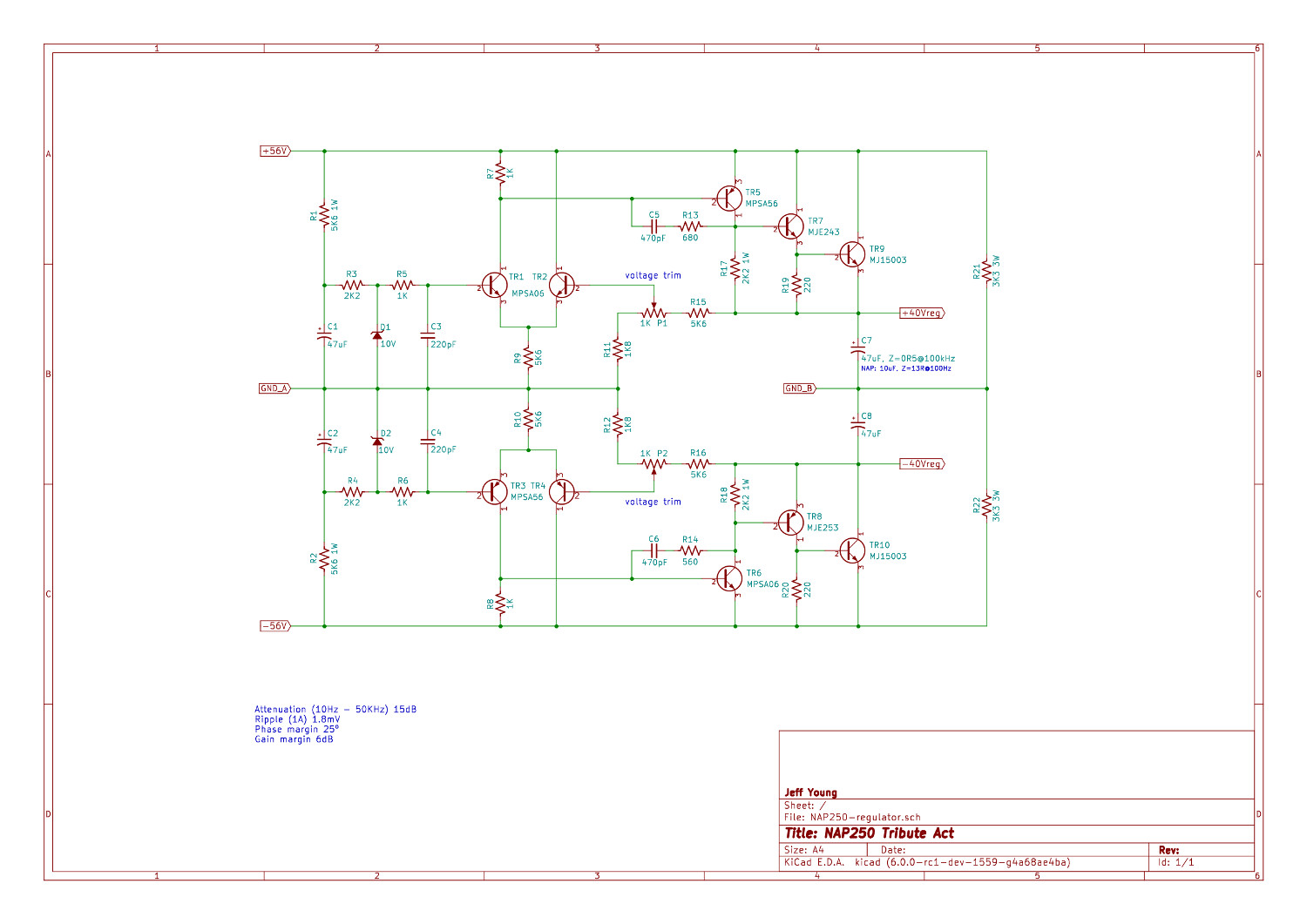

Naim NAP regulator (sans current protection):
attachment.php

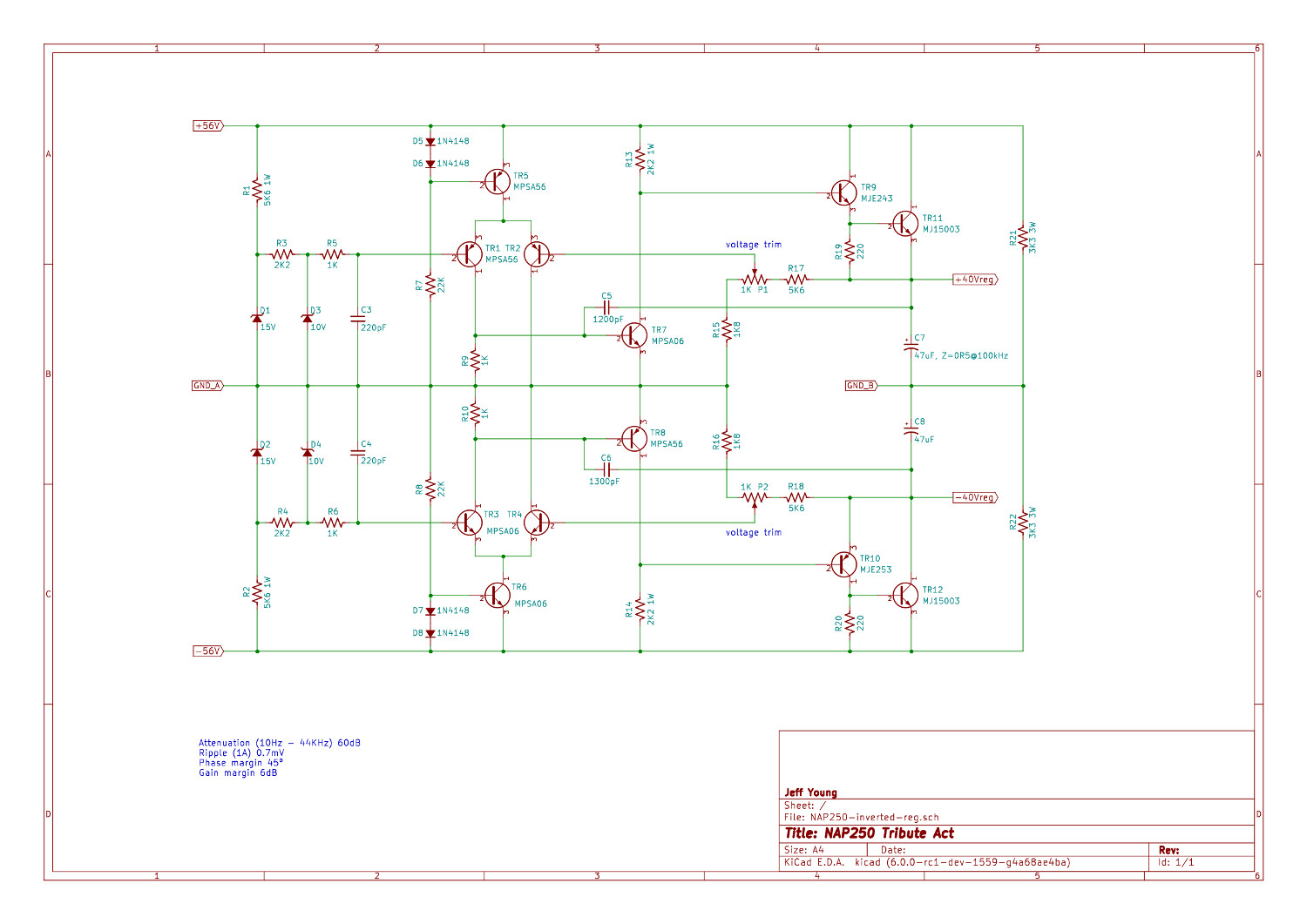

Modified regulator. LTP & VAS re-referenced to ground, CCS added for LTP, Miller compensation changed from local to global.
attachment.php

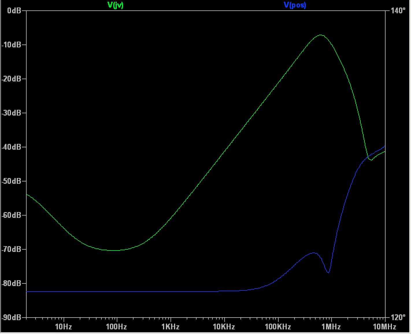

SPICE has the modified regulator giving vastly better performance in the higher frequencies:
attachment.php
Can you hear the difference? Dunno. But I intend to find out.
Naim schematic board:
attachment.php
Modified schematic board:
attachment.php

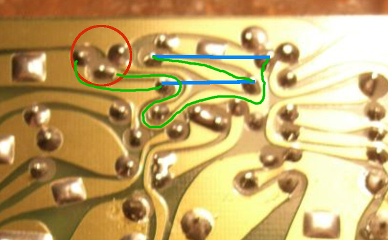

The traces between the Miller cap and the VAS transistor on the amp board are about as short as they can get.
So let's assume you're talking about the regulator boards. Naim's design has a resistor in the Miller circuit, so it is what it is. Those traces could be shorter though. How's this:
attachment.php
On the modified regulator the Miller cap is bypassing the VAS & the output stage. There's no way to make that particularly short.
I'm not trying to be dense; I just am. ;)
Even my first layout was reasonably compact next to Julian Vereker's. :D
VAS in red, Miller cap & resistor in blue, and traces connecting them in green.
attachment.php
Granted, he had the constraints of a single-layer board. But I don't think Naim amps come with radio licenses, do they? :p

Second regulator schematic from post #67 is the global feedback one.

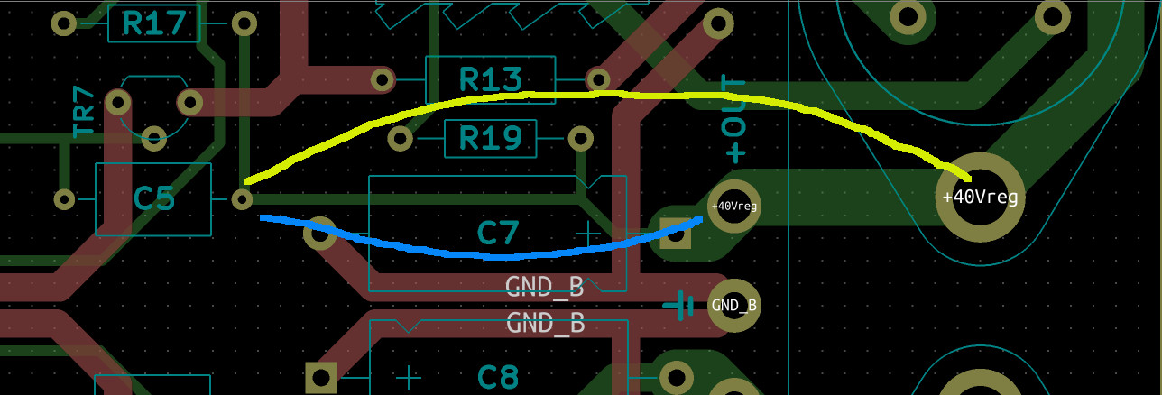

What's the operable length? Just to the current-carrying trace (blue line), or all the way to the output device (yellow line)?
attachment.php
And what's the problem with the length? The trace resistance shouldn't matter: it will just add a zero (which in fact would be mildly useful up at about 47R, but that would be a really long trace).
Is it ringing? C7 is connected in the middle and is an electrolytic so it will have a non-trivial ESR even at high frequencies. Wouldn't that dampen any ringing?
Is it the trace inductance? The yellow length will have an inductance on the order of 50nH. If I plug that into SPICE I do get an ugly spike at 50MHz. Shortening the trace to about 1cm moves that out to 100MHz. But 1cm doesn't even get me out from under the heat-sink.
The 50MHz spike is around -35dB, while the 100MHz one is around -40dB. Those are waaay below unity gain.
What am I missing? :confused:

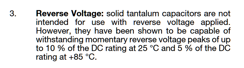

If C1, C3 & C4 are tantalums they need to be high voltage, like 25V or more. This is to do with making sure they have enough reverse voltage tolerance.
Unfortunately, this is incorrect.
Vishay, for example, does not give any guideline but simply advises that tantalum capacitors are never used in a circuit where a reverse voltage may be applied across its terminals. This is good advice.
For those that do the common guidelines for reverse voltage are:
10% of rated voltage to a maximum of 1 volt at 25°C
3% of rated voltage to a maximum of 0.5 volts at 85°C
1% of rated voltage to a maximum of 0.1 volts at 125°C
So for reverse voltage considerations only, there is no advantage to increasing the rated voltage above 10V if you believe that the cap will not get hotter than 25°C - which is pretty optimistic even with a Class B Naim amp.
Vishay
See guidelines section 3.
Source?
