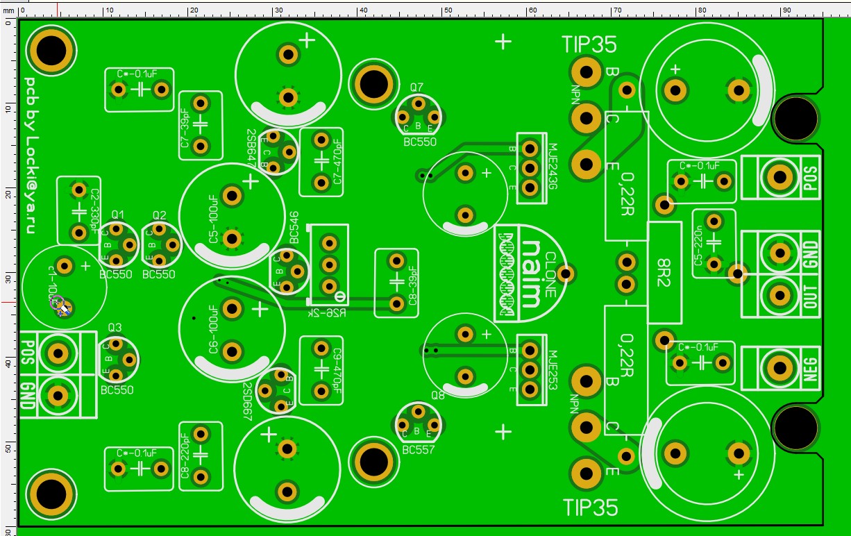

The BC546B I have used had hFE=289. I had build the Avondale NCC200 and there was this reccomandation to use the different hFE by 10% between the 2 input transistors to assure the DC offset. I think I had just a little "bad luck" to have Some of the transistors you used have a lower VCE voltage, Can I use them safely?
The DC offset at the speaker outputs could be adjusted by changing the 620ohm resistor value at the emitter of TR3 in the diagram. You could try installing 560, 680 or 470 ohms and note the value of DC offset with each change. Then fine tune the final value using parallel resistor configuration. For example, if after experimenting, you need the value of 594 ohms to get the DC offset right (+- 15mV) then use both 680 and 4700 ohms parallel in place of TR3 emitter resistor.
Other way to get the DC offset right is by using HFE mismatch for the LTP transistors ala Naim. This is a long way approach. Need to test each transistor (TR1 and TR2) and match specs to within 10% of value. For example TR1 HFE511 and TR2 HFE494 (I'm using BC239C here). Then you don't need to change the 620 ohms resistor.

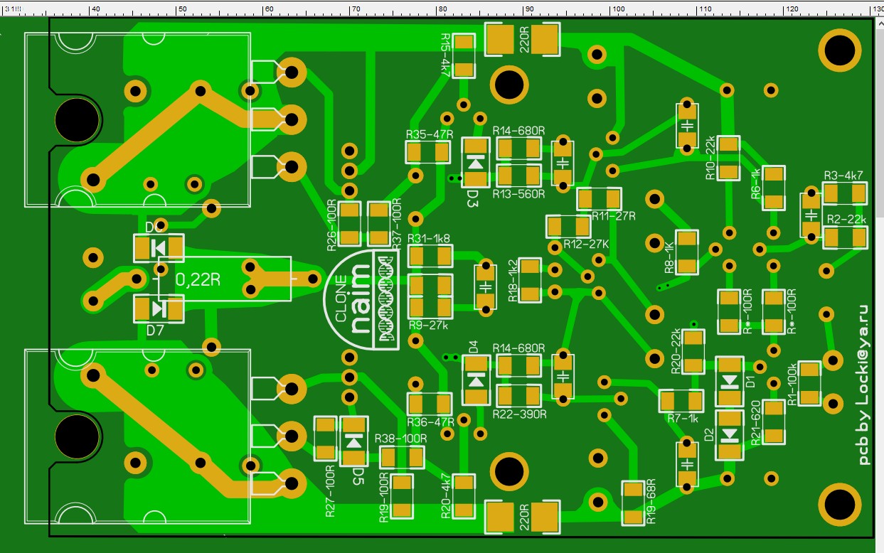

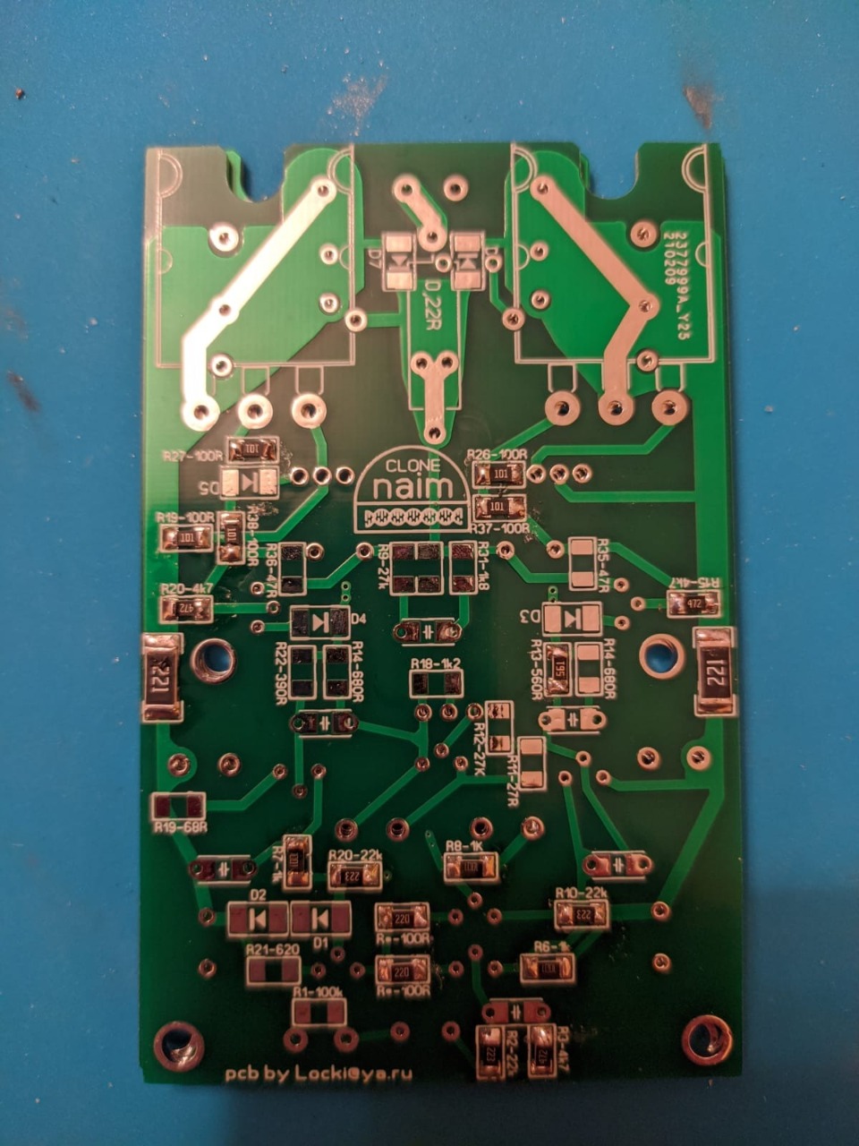

Му PCB -))

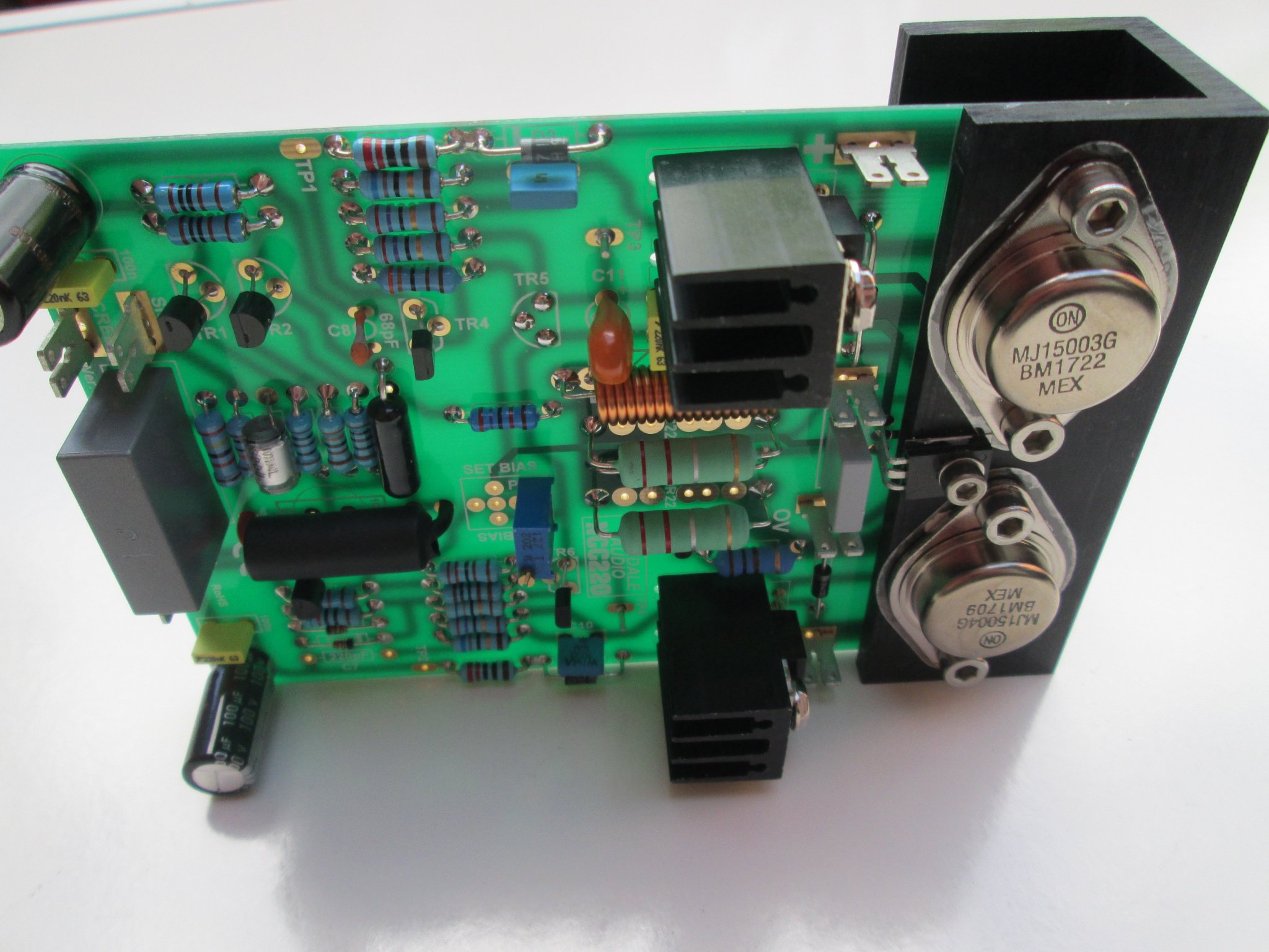

Hello, I would like to ask where the aluminum U-profiles shown in the picture can be purchased.
Basically, the sizes are 31.75mm/31.75mm/31.75mm/4.76mm.If it cannot be bought in these dimensions, then at least indicate a manufacturer with close to these dimensions. I mean the profile for the power transistors. Thanks in advance.
