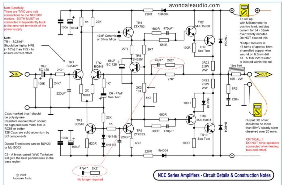

Nap clone pcb
Neutrality have you print any of this pcb's ? Ill love to join inn for 6 of thouse
Those points have been adressed a few days ago, just havent gotten around to post it here.
As you probably know most PCB layout design work is usually a WIP, with continous tweaking taking place. From first draft to the final version a lot of stuff can and do happen.
The 2 x FE gnd, 2 x OP gnd, zobel gnd and signal gnd are all seperated.
Regarding R23, there will be a inductor, just havent put it on the schematic.

Hi there,
I'm the guy that put together the original HackerNAP/HackerCAP project. It's based on the Naim NAP and Avondale NCC200 circuits, with some Acoustica modifications and other bits n bobs gleaned from the Internet. I don't claim any credit for designing those circuits or components, only for amalgamating them in one place for one design.
I did, however, layout the HackerNAP (and the corresponding power supply, the HackerCAP) PCBs very painstakingly. One of the design goals was to think very carefully about separating the power supplies for the front-end and for the output stage. Among those considerations was the arrangement and design of the 0V configuration, which is not very straightforward. The separate power supplies are also highly customised to account for the different needs of the output stage and the front end.
The design that you've come up with is, at best, compromised compared to the original, and I'm afraid your schematic/PCB has at least one error: you have placed R23 (a 15R) directly in series with the amp output. This will not work without the corresponding output inductor! The 15R is supposed to be in parallel with the output inductor and is merely there to stop ringing. Without the inductor, you're going to (at best) ruin the sound of the amp. In all likelihood you'll quickly release the Magic Smoke.
The layout of your board also negates many (most!) of the benefits that the amp & PSU design were designed to bring to the table, especially the grounding/PSU layout, which is the amp's major design feature and was designed to alleviate some of the problems associated with the NAP/NCC designs. For example, the shared 0V returns on your board are going to do you no favours (eg. the Zobel is connected directly to the signal 0V; the signal 0V is also slung right between the power 0Vs, which will modulate the signal; the front-end and output stage 0Vs share a common PCB track, etc etc etc ), and honestly there are so many compromises with your board layout that if you haven't already made it, I suggest you stop right now and do some redesign work.
To help you along, please take a look at the build manual and schematic for the original HackerNAP. It's available for free here: HackerNAP project page. I urge you to read that page carefully before proceeding. In fact, don't just read the web page - download the actual build manual because it contains much more information, photos, diagrams, close-ups, etc etc.
You'll also find the PCB Gerber files, bill of materials, and schematic freely downloadable. This is an open-source project and you are of course welcome to do with it as you wish; I would, however, urge you to reconsider the design that you are embarking on because it is a big step backwards over the original. If you do go ahead with this design I would be grateful if you called it something other than a HackerNAP
Having said all of that, please feel free to ask any questions. I'll do my best to answer, and hopefully we can come up with something that allows you to use TO3 devices without compromising the HackerNAP design. Hell, I might even add another variant of the PCB to incorporate TO3 devices if there's any interest from other folks.

100mA or 100mV? DC Offset is a voltage and at that low level is really only an aesthetic issue. i.e. it wont hurt normal, room size loudspeakers and you wont hear it. However, have you understood the second instruction in black print, at the top, left side of the schematic?
In the manufacture of the real Naim amplifiers and presumably Avondale's versions, the LTP transistors are tested for hFE and selected to provide an appropriate mis-match. That can re-balance the output of the intentionally unbalanced LTP (input stage transistor pair). In other words, it does not have a pot. Like the Naim assembly workers, you are required to select the most suitable semis from a mixed stock of parts instead of adjusting a pot. That forces the bias current in each transistor to have a more equal current in the idle state.
Hope the build works out fine for you
I have also built the NCC200, used matched transistors, but in 20 transistors could not find a difference in hFE of 10% (all of the transistors I bought had exactly the same hFE). Is there another way to adjust the DC offset (now it is 82mV and stated in the diagram was less than 50mV). And another question - what is the recommended power voltage?
