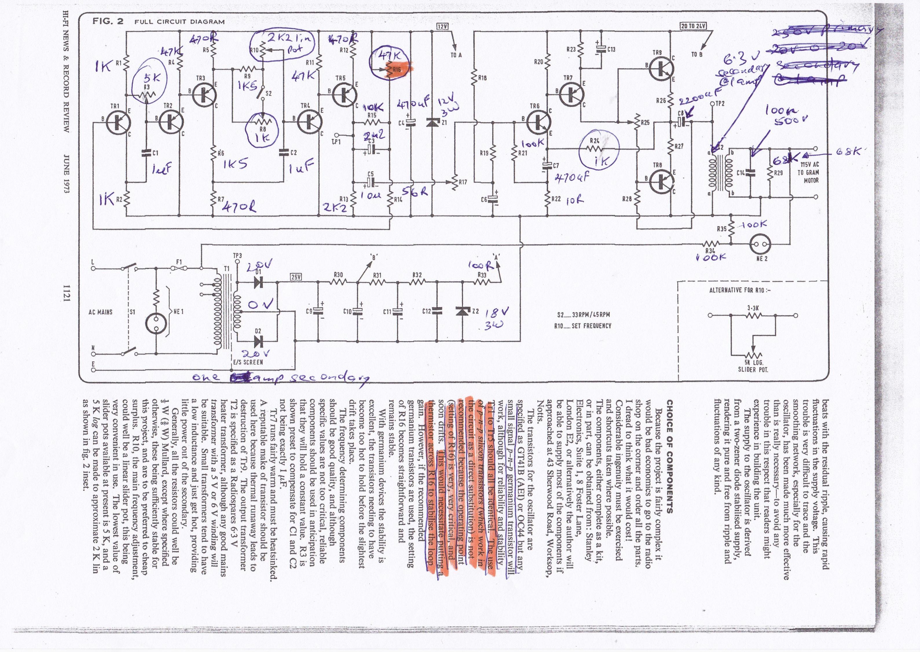

The circuit by Alan Ainslie was published in Hi-Fi News issue of June 1973.
Significantly the oscillator was a phase shift type making use of four germanium transistors (GBT41B or OC44) to cause two 90 degree phase shifts. The step up transformer was a 6.3 V filament heater type.
Germanium transistors were specified as the oscillator was stable without a thermistor to stabilise the loop gain. The design could be adapted to use silicon PNP's given due attention to that aspect. The power amplifier is a simple design also using germanium devices.
Speed was set by a divider networks in the feedback path - these incorporating a trim pot within each for fine adjustment with a switch to select the divider network appropriate to 33/45 rpm.
There was a detailed set up procedure to adjust the speed to match mains frequency.

I am posting Alan Ainslie's speed control circuit.
The circuit requires a thermistor for use with silicon pnp transistors and these may be hard to find.

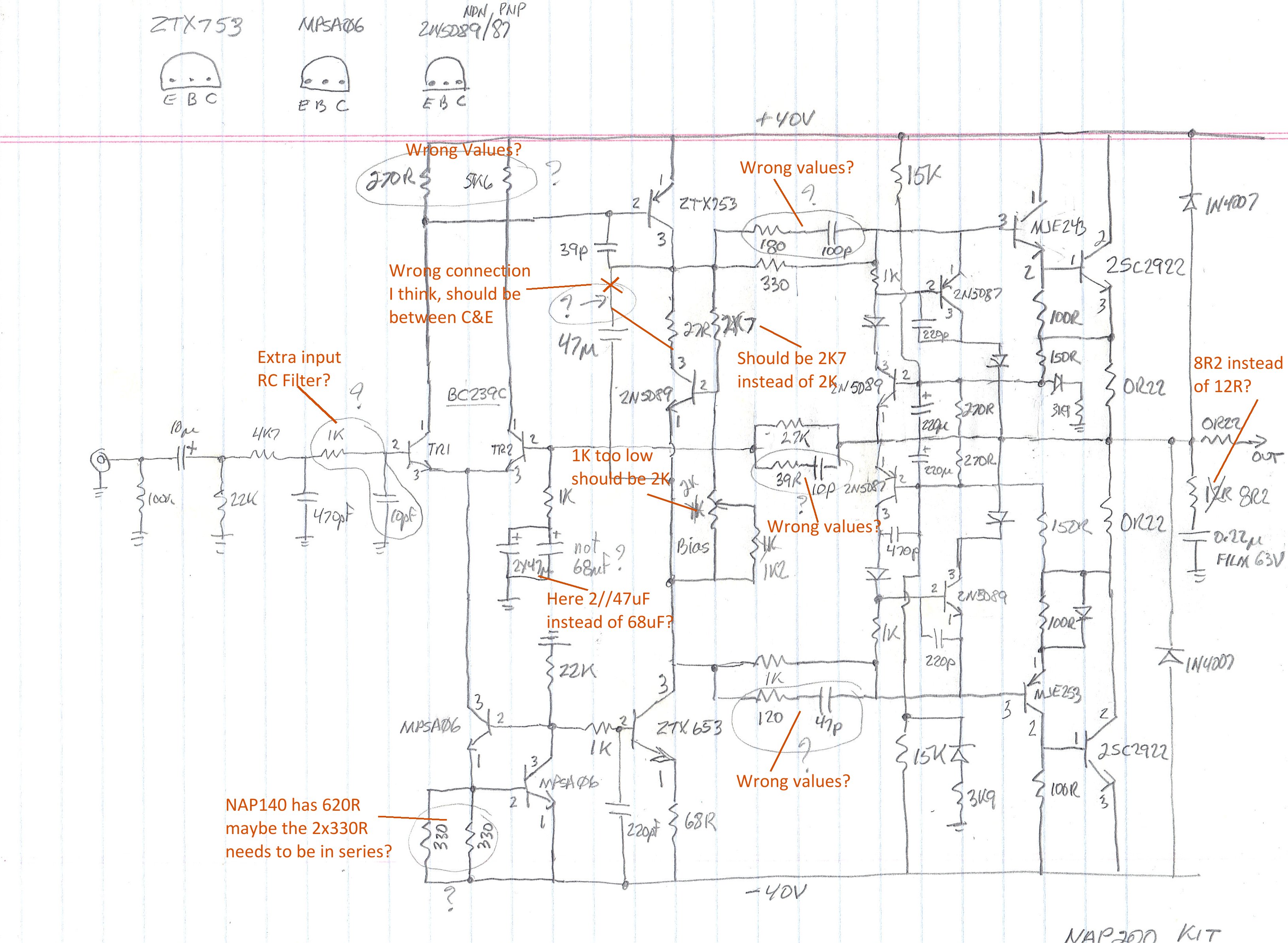

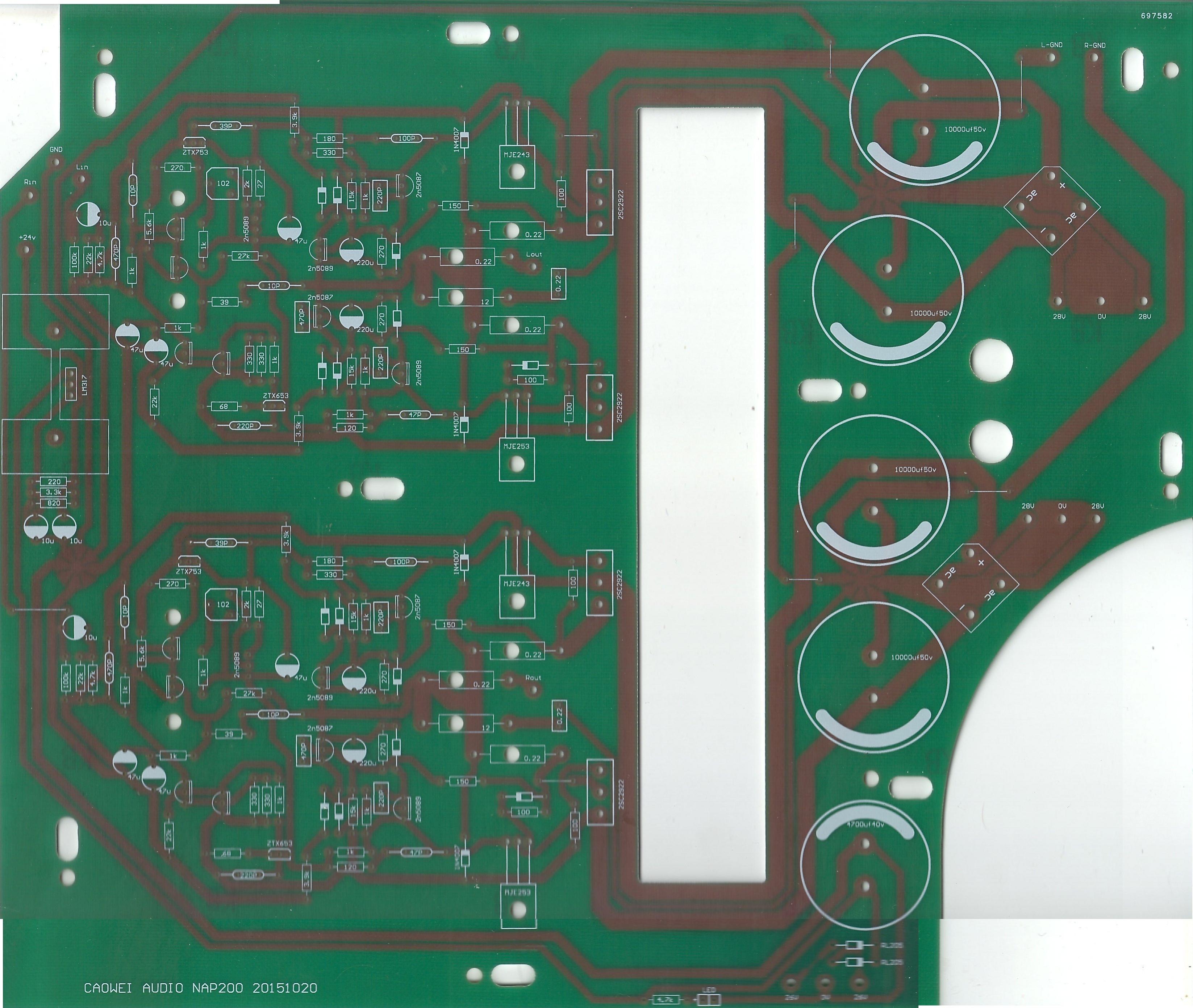

I received the NAP200 kit but without the schematic ;( The PCB is of excellent quality.
Using the PCB, I found the schematic and found a few possibles parts and/or connection errors. Maybe Nigel can comment on the things I found. Thanks in advance

Hi, good to hear that you've received the kit - I've ordered one also.
Out of interest what is the tolerance of the metal film resistors that have been supplied? The Nait 3 with NAC 90/3 that I currently have uses resistors with 5% tolerance.
Also in the NAC 90/3 the equivalent parts to those in your sketched circuit diagram (5K6 (TR2 Collector to +40V) and 27K (TR2 Base to 0R22 output resistor)) are 1% 50ppm resistors - are precision resistors included in the kit for these locations?
What is your feel for the authenticity of the power transistors? Do they seem to be genuine parts?

As many have said I don't really like or see the need for the networks between the VAS chain and TR7/8. I will look to see if it is similar in what it does.
There is a very odd coincidence with a item I intended to post today but didn't on another thread. I argued a TR1+2 current of 5 mA could match a VAS current of 5 mA and that as best as I knew never had existed. The arguement being a set of 2SC5200/2SA1943 possibly driven by the same would be a more modern way of thinking and not need so much VAS current.
The advantage in this version being that true transconductance might happen into the VAS transistor. If we call the VAS current 9 mA the TR4 Re = 26/9 mA = 2R9. That implies a typical Zin of 300R. That looks to be nicely matched to 270 R. Personally I would have gone further. It might be reasonable to add 2.9 x 3.8 = 11 R to TR4 emitter ( ZTX753 ). This would restore the loop gain to that of the Naim. It would raise Z in to 1400R. That's very nice. IM distortion should be reduced. In fact 5R6 would be more than OK. If the transistor had a gain of 300 as Japanese transistors can ( most are fakes I suspect now ) then this would be ideal without any resitor. With caution I like what I see. DC off set might be higher. Anything below 100 mV is OK. I know it is not clear cut how the transconductance works when a VAS so accept it can happen more easilly than I suppose. In valve designs they liked to see 3 to 1 impedance ratio. As this is a I to V converter it could be argued that none of this matters. This designer might have also played it safe and liked to have surplus current. It is offering a higher slew rate.
The writer on the other thread was saying he could hear an over sized TR1+2 current sounded better but had no measurements to prove it. I think it would be IM or more likely TID.
The 0R22 output resistor is spot on. Geofrey Horn claimed the only reason the Quad 405 sounded different was that resistor. He claimed to have fitted one to the 405 and could hear no difference via Quad ESL speakers. That is what we lack in reviewers. He liked the Naim and found out why. I suspect he wasn't very wrong. Damping factor is critical although not with the ESL. It is easier to start with plenty and loose some. It also makes the amplifier like the speakers a bit more ( makes the resulatant more resistive ). It migh interest people to know that even a damping factor of 3 offers some useful cone damping ( mid 1950's tests in Wireless World ). 0R22 d = 1+ ( 4/0.28 ) or about 15, I have added a bit for cable.
The Zobel ( 0.22 8R2 or 12 R) should be OK either way. I usually use 100 nF and 4R7. Some chip amps use 100nF 1R, that isn't a good sign.
The input filter is a bit odd. I think it will be OK.
39 pF for TR4 is low considering the loop gain . A good sign if stable.

Wow that was fast and already very interesting analysis and comments. Can't wait to have the schematic connection and values confirmed. I'll check the parts further tomorrow. I already ordered from an known good supplier and received output transistors that I plan to use instead of the supplied ones. I could compare them and see if they look ok, I'll keep them as spare if they are good, otherwise I'll just trash them.
The ZTX, MPSA and MJE parts looks genuine. By the way there are marking missing for some of the input transistors (look at the PCB scan), but there is a bunch of MPSA06 transistors included. I put on myself to mark BC239C for TR1/TR2 on the schematic.

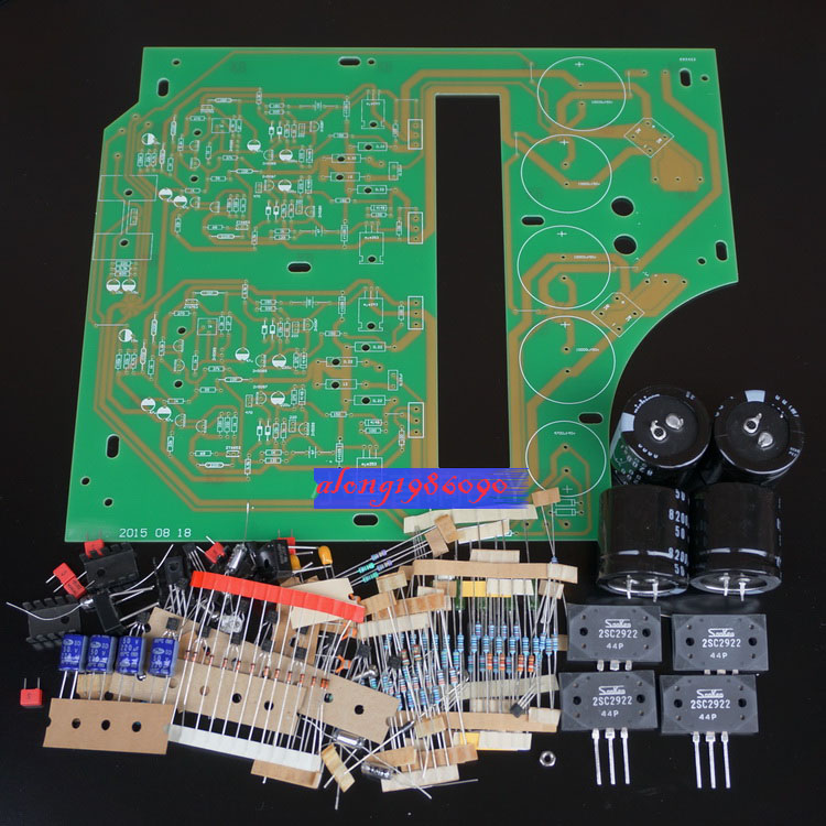

There is no instructions, BOM or schematic included. I'm happy to have the help of this forum to get the amp up and running.
What about the 47uF cap near the 2N5089 & 27R resistor? In all the Naim amp schematic I saw this cap is always across the transistor E & C, not between the emitter and the 27R resistor. Is it ok, or a PCB error?

IMO, the circuit is OK. If I was you, I would give it a try as is. There are changes, but I don't see errors. If they've made copy from the original, this is the closest to the new circuit we'll ever come.
The CCS and the current in the LTP is the most serious change. 330//330 gives them resistor value that they probably couldn't find for cheap. I don't think the resistors are in series.
The input filter has an interesting addition that I would consider as fine tuning. 10pF is very little to do much else, and the added 1k in the input actually matches better the feedback for improved DC offset. The drivers R/C obviously are also re-tuned for the new driver transistors. This is speed-up circuit that also add some stability margin. I also found by measuring the older one that it has some interesting effect on static (DC) conditions. I wouldn't change the given values without measuring and testing extensively.
Thanks for posting the schematic, by the way!
I tend to make them matched. Maybe I'm wrong.I guess that the higher HFE for TR1 compared to TR2 still apply in this circuit?
In any case, if you don't measure at the intended operating current the whole hfe thing is more or less pointless. Measuring with the DMM tester gives decent results in removing "the bad apples" from a transistor batch, but not much for precise matching. You need curve tracer for that, or to build test circuit for the specific current.

In the hifidiy discussion, some people has thermo issue with this board if you follow the original thermo compensation scheme.
http://bbs.hifidiy.net/forum.php?mod=viewthread&tid=1120806&highlight=nap200
#269 has photo for the burned transistor.
#301 illustrate how to set the thermo transistor. He is the seller and designer.
