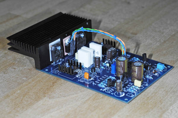

One of the two apms, waiting for the PSU to be ready (at least ready enough for testing).

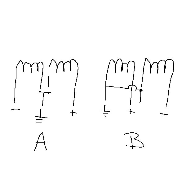

Thanks. I know about transformers working only for AC. I just economized on my basic and largely inadequate drawing skills. 🙂
But I was wondering, after the rectifiers converting to DC of course and after the caps doing their business, if there is a preference for either option.
