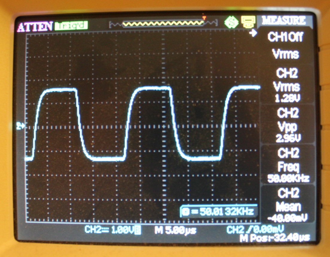

This is the FET output circuit that I tried. I don't think it contributes anything special and I was not sure that I want to post, but it really doesn't matter.
I can only guarantee that it works perfectly just as the original clone.
I don't claim it is better, or that it can't be improved.
As I said, I just wanted to try the front end without the gm doubling and the thermal discrepancies at the output.
You can also see that the hi-frequency behaviour is better. 50kHz squares are pretty good, especially compared to the original.
View attachment NaiMOS.pdf

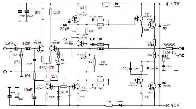

Something like these?🙂
Listening to Naim amps today I find them very unremarkable. I love the way they were made. Somehow speakers have changed. I asked Spencer Hughes of Spendor what amplifer he prefered ( circa 1982 when he was very ill ). He said he should prefer Quad as they were old friends, he prefered Naim. He said people assumed his speaker to be an easy load. His exact words to me. " If I was an amplifer looking down the speaker cable with binoculars I wouldn't see drive units in the BC1. I would see chokes and capacitors. I would say I'm going home and not bother ". It is perfectly possible from KEF to Linn most speakers of the day had the same design problems. Not in the external but the Spenser binoculars. The Naim amps super tuned to the reality of the day. The speakers also super tuned to best of kind. I have some Dynaco A25. I think I should try them with NAP 250. I have a hunch it could work very well. NAP 250 in it's day was very fast sounding. Now it sounds nice enough. The NAD 3020 put up against it wasn't completely pushed to one side. I would side with Andrew and suggest some experimentation as J V did. The design should have very good devellopement potential. The all NPN output stage I suspect is doing nothing to put it in doubt. Everyone should have a NAD 3020. It is a good preamp, a good power amp and an OK pre-power. Buy two to make a pre-power. I use a NAD to stand in for a pre or power amp when testing things. It seldom is beaten by things many times it's price, especailly when just a preamp.
Your circuit shows the LTP as having emitter degeneration resistors.Something like these?🙂
You can use these to check and/or set up the LTP current balance by measuring and adjusting for zero voltage between the LTP emitters.
Once this is done, you will find that the VAS current injected into the left side of the LTP is taken into account.
Now check the difference in collector voltages of the LTP and while you are at it check Vce.
If Vce are equal and Ie are equal and hFE are equal and Vbe are equal (these last two require matched devices), then you find that Pq are equal. Now you have a balanced LTP.
That is clearly NOT what Naim require.
The Vbe multiplier is still the wrong way round.
The D.Self explained resistor 27r above C3 is there, but it can't work properly since the multiplier is connected incorrectly.
