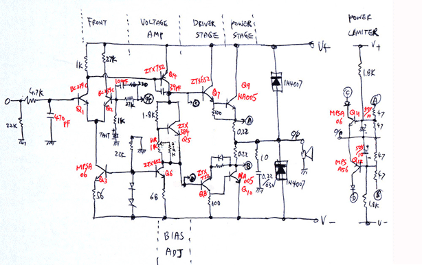

Here's a link to a hand drawn Nait circuit, apparently "reverse-engineered" from a real Nait1. There's an error - Q3 56R emitter resistor should read 560R.

This is a copy of the original hand drawn sketch from Julian.
Output transistors that he suggested to use was BDY58.
Thanks for posting that msdin.
Interesting to note the low gain, heavy compensation and no TR2 collector resistor. I guess they were still developing the "Naim sound" at that point in time.
A pretty wicked zobel network on the output there to boot.
